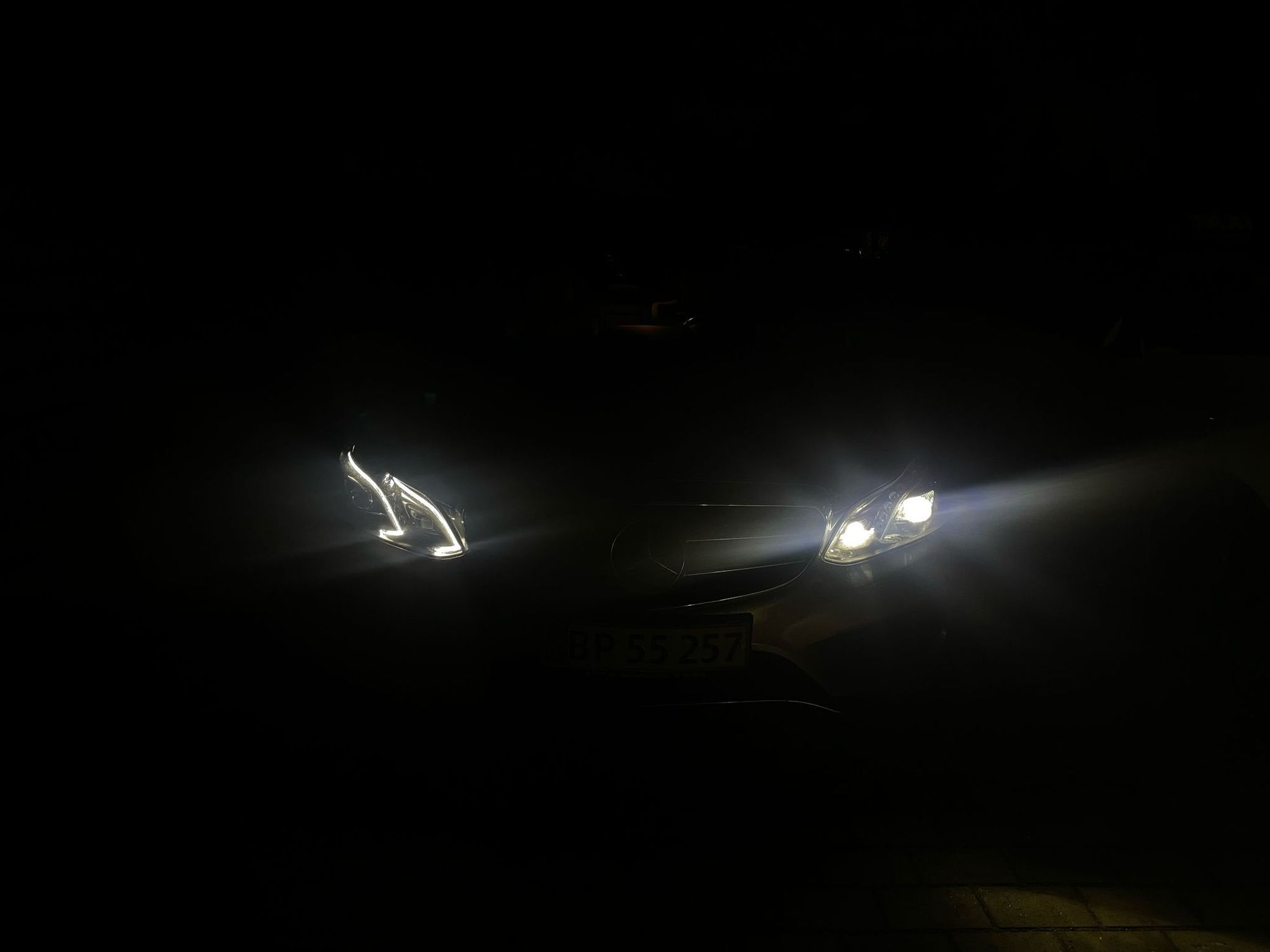

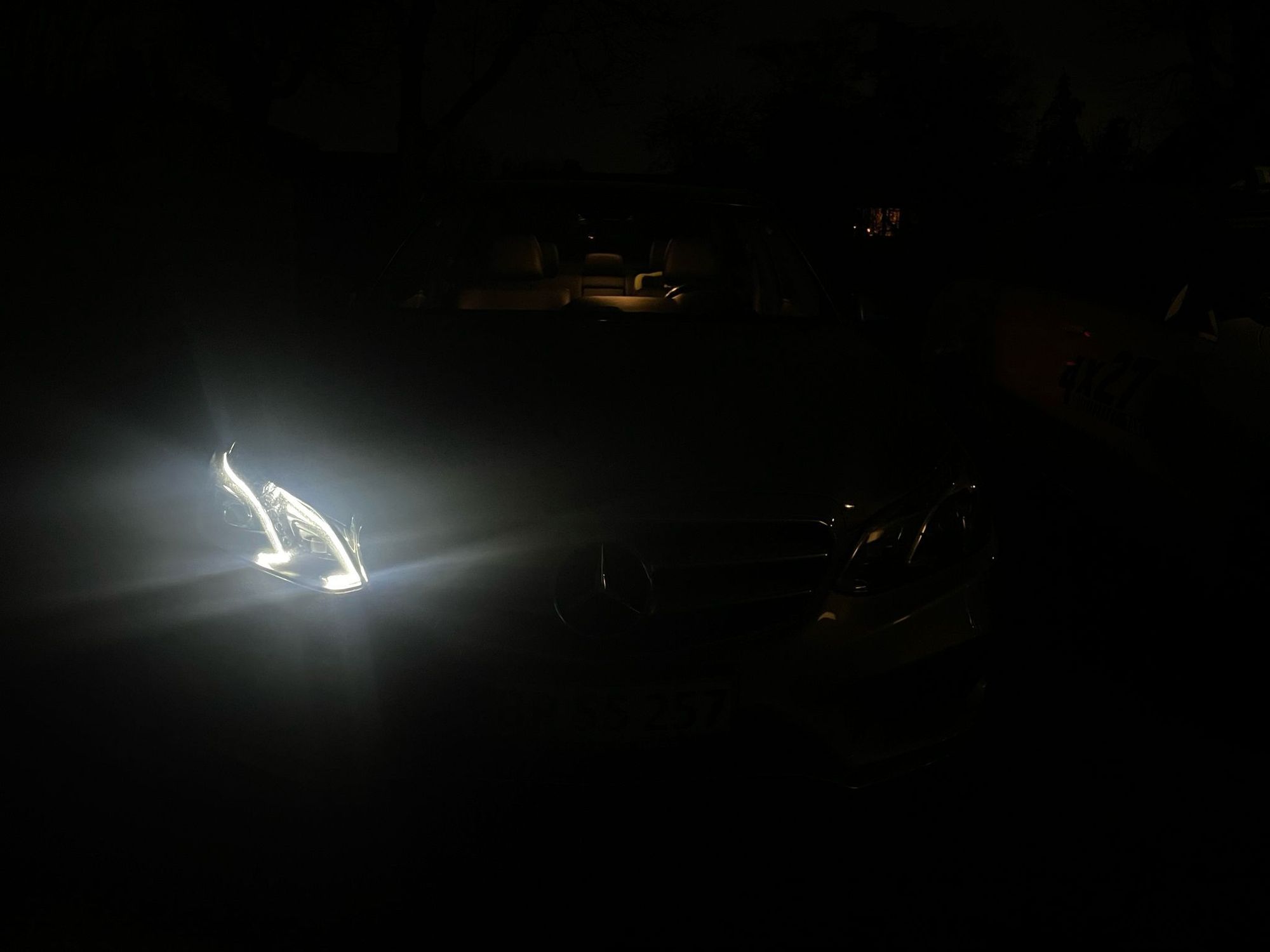

Im writing to find someone who can help me solve my head ligh issue.
ISSUE
- Lights turn on occasionally
- No lights
- Only one LED stripes
- One LED stripes (passenger site) and ILS Beams and no LED stripes(driver site)
- Issue can be for short amount of time or several days.
SITUATION.
It all started, when the car was in an accident. The Driver front light was changes by mercedes, new bonnet, front window.
Since then it has worked occasionally.
2 year after accident on passenger side, new original lights installed. bus issue is still here.
We have checked cables by mercedes, no issue.
Fuse box - no issue
Lights are both new and original.
