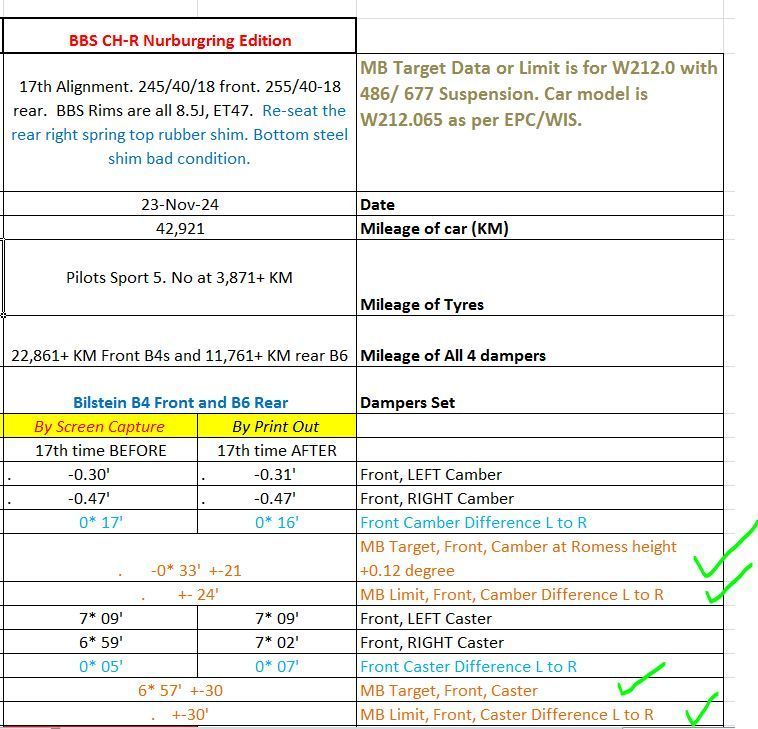

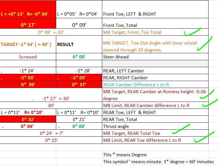

Old Apr 2, 2025 | 09:17 AM
chazmuska's Avatar
Joined: Apr 2025
Post Copy of my Alignment specs
I attached a copy of my alignment specs so you can see the min/max values. I had my alignment done at Evans tire last year but I'll have to take it to the dealer or somewhere more reputable because I just noticed they used the specs from a 4Matic and mine is RWD. Just something to consider. I mentioned that my car was pulling to the right and all they did was move the left front toe from 0.20 to 0.05. (less toe in). My front left camber is still off at 1.0 and it should be slightly negative between -0.8 to -0.1 degrees which explains why my car drives straighter but now also feels squirly at highway speeds. I'm going to have get a camber kit and take it to another shop. Hope this helps for reference.

If yours is a real 677 suspension, below is the proper alignment data. See the green tick.
Me also will replace the rear springs, have got all the parts just arrived a wek ago.
Ur measurement unit is Degree 1/100, mine is Degree & Minutes.
Do the conversion.
Example, your rear LEFT camber is -1.8*
MB wants it 1* 27' +- 30' which means 1.45* +- 0.5* , in other words 0.95* to 1.95* is still OK. surely if at 1.45* is nice.
Get your datacard for your VIN. Your suspension code is there.
Your front LEFT CAMBER is too much.
A 677 suspension is to be 0* 33' +- 21'
Meaning 0.55* +- 0.35* or 0.2* to 0.9* is allowed. Your LEFT FRONT CAMBER is at 1.0* already.
Do the conversion.
Yes Surya, and all of it changes with the new springs installed in back, my rear came back into spec and my front needed realignment from the change in rear ride height, It did take them 2-3 weeks to settle in so aligning it right away is not recomended unless it's so far out tire wear would occur in just a few miles, then it should be done twice.My front changed in that two weeks
