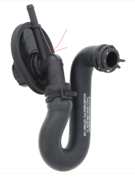

Assuming the plumbing in your car is like mine, I think you will have to be on constant lookout for coolant leaks. Every time you do some work around old coolant pipes, replace them. There are some you should replace in groups pre-emptively. I think they made the coolant pipes in these cars with recycled garbage. And there are definitely some weak mechanical points in the design. (See below)
