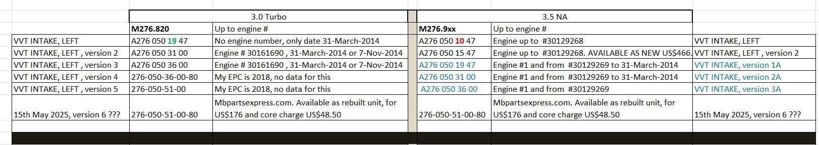

Take a look below : In blue text for M276.9xx 3.5NA is where the VVT is for newer chain and the VVT P/N is then the same as 3.0 Turbo .

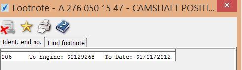

Older stype VVT due to old chainVVT INTAKE LEFT.
A276 050 10 47 Version 1
Version 1 replaced by A276 050 15 47 version 2

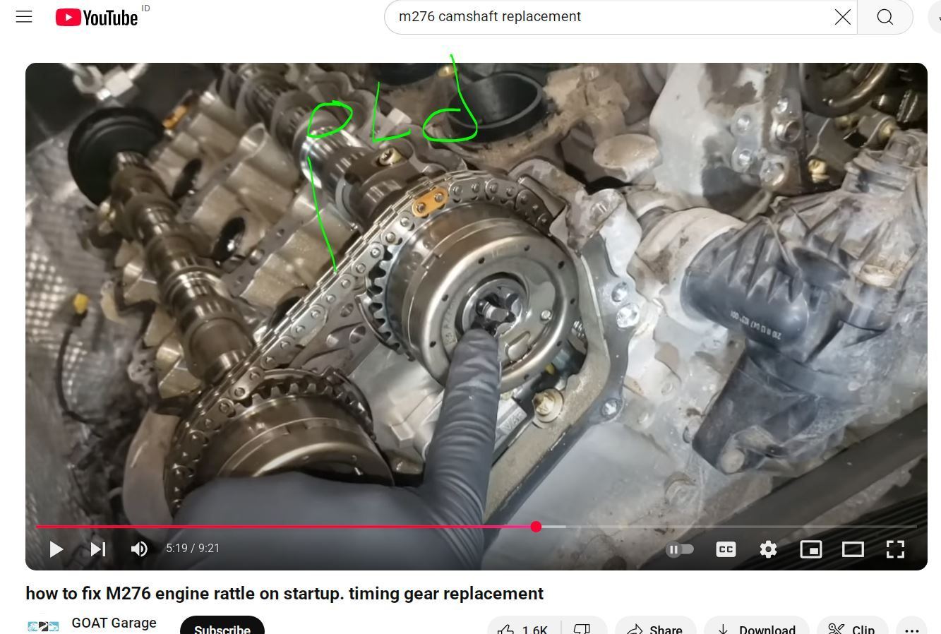

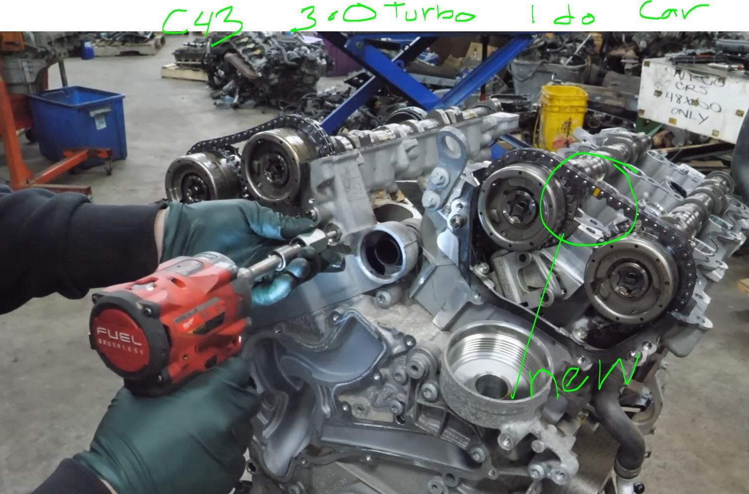

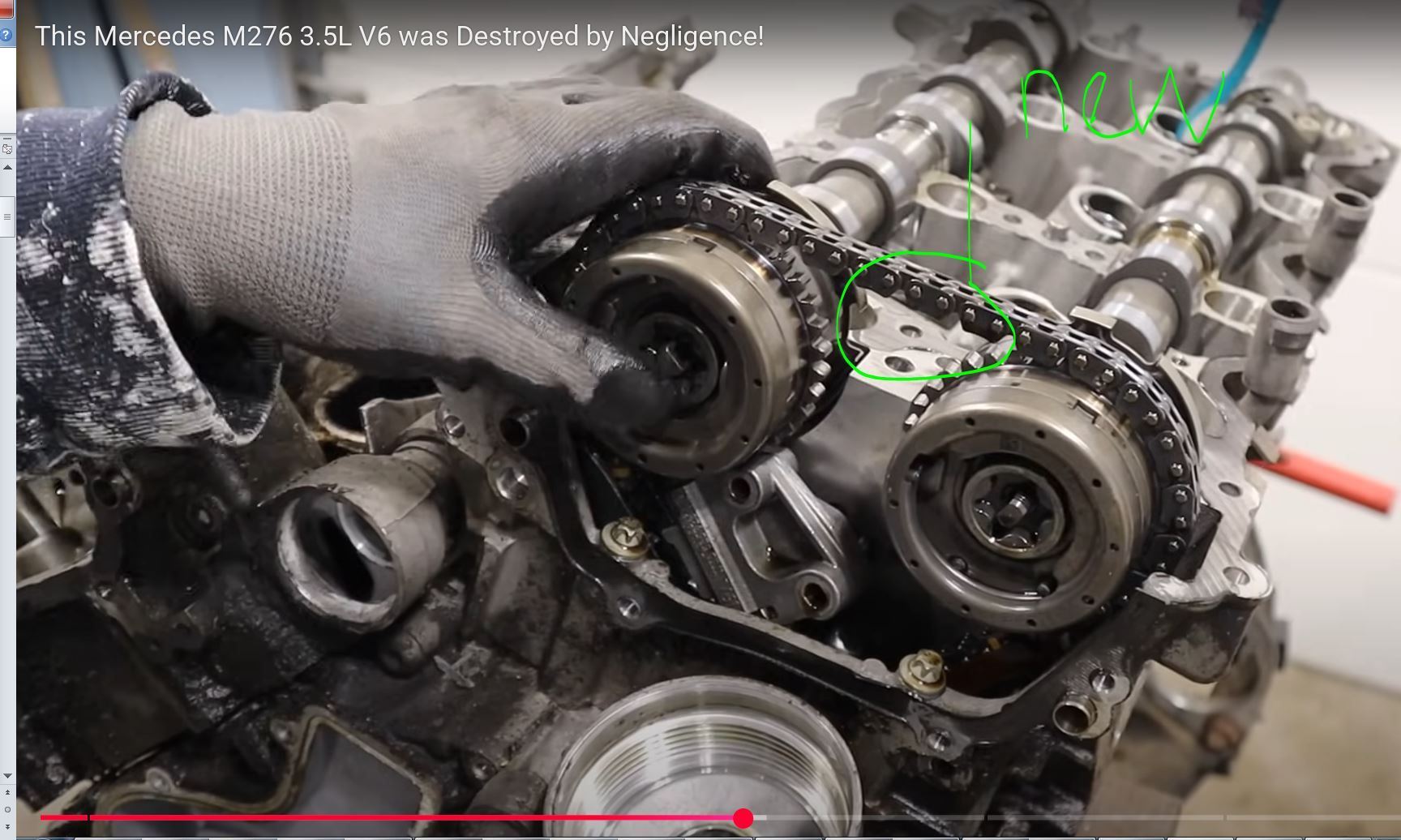

To be certain, inspect your chain first.
This is my chain M276.820 3.0 Turbo, the newer version and is the same as M276.9xx engine number ----30129268 and up
