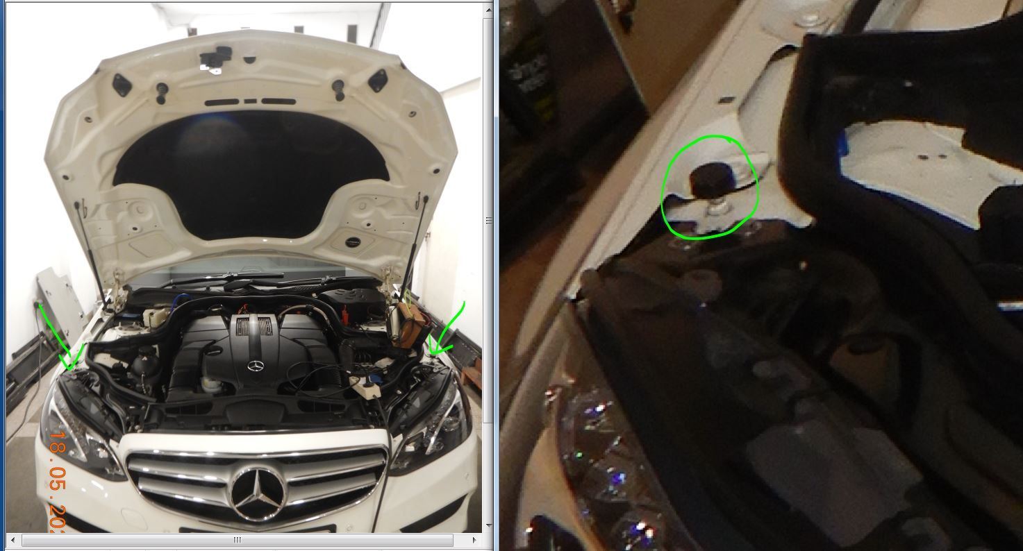

The only rubber/plastic you can adjust for the hood is these one : ( as far as I know )
However, if the gap is hood metal towards the bumber plastic grille upper surface as per green circle at photo below, the grille can also be adjusted.
I learnt of the grille/bumper adjustment when I removed my bumper. Mine is facelift style bumper-grille as per 1st photo above.
