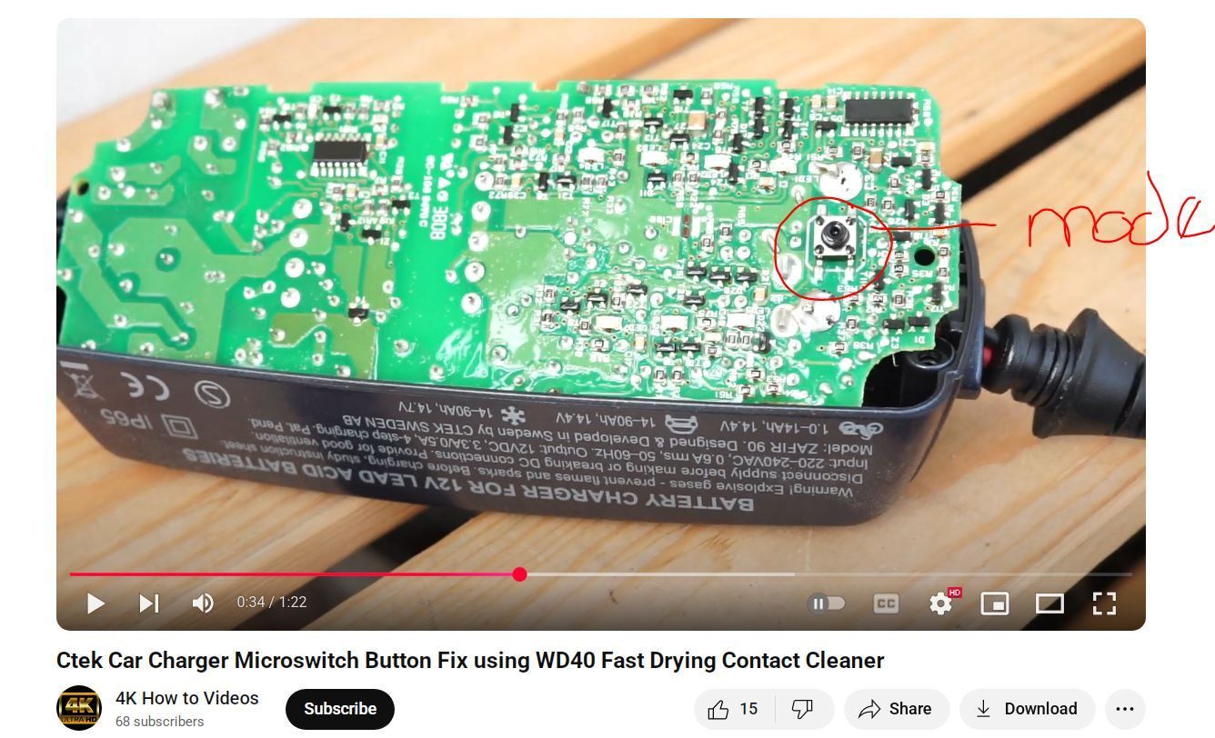

This button been long time naughty...... not working.
Few weeks ago my staff motorbike battery went flat by accidental light switch activated.
My CTEK can't do Motorbike 1A mode, DUGGHHH !!!! Its mode button is bad.
His small bike battery is only 5 amps and max allowed charge current is 2A.
So I go no choice but to run the Ctek and my SKYRC digital load bank set at 3 amps.
Anyway, few days ago.......... I DRILL BABY DRILL ,,,,,,,,,,
Me too lazy to tear charger open, as mine is glued all around.
So I drilled two holes and inject contact cleaner, result not bad.
Position of MODE BUTTON and motherboard perimeter
Above is mode button with its wide pusher black plastic part
Below is mode button as is, stand alone
So is your mode button naughty-intermittent ?
