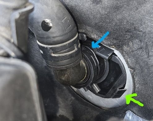

A cool day came around so I managed to sneak this one in and complete it.
I would recommend getting the following tools. They made the job alot easier to complete and are cheap in price.
1. Hose clamp pliers
2. Hose removal tool.
They are both available on amazon.
Also, there is very little coolant loss (1/2-1 cup) doing this job as it is high up on the coolant circuit. There is no need to get under the car and drain coolant.
Lift the spring (blue arrow) with a flat bladed screwdriver to begin disconnecting the hose from the engine. This hose feeds water from the block to the heater core.
This hose has a plastic end that slips into the part on the firewall. It may be stuck in there but you'll see it slowly moving out as you pry it eventually popping off.
Mine was still in good shape so I reused the hose. You may want to replace yours with a new one if you'd like.
Use the hose clamp pliers to pullback the clamp (red arrow) going to the heater core pipe on the bulkhead.
Use the hose removal tool to get in between the hose and the heater core pipe. Break the seal with it and you'll find it alot easier to remove.
Use a flat blade screw driver to push in 3 tabs (green arrow) holding the black distribution valve to the firewall (see image above). Push the part in towards the bulkhead. I found it easier to push it in and towards the passenger side to remove the part. Its tight in there.
Once I lifted it out of the tight space, I used the hose clamp pliers again to remove the small clamp for the hose going to the washer fluid. My hose clamp was facing down (as per the above picture). The hose clamp pliers made this job a breeze.
Installation of the new distribution part is the reverse of removal.
Below is the old part I removed. The crack is circled in green.

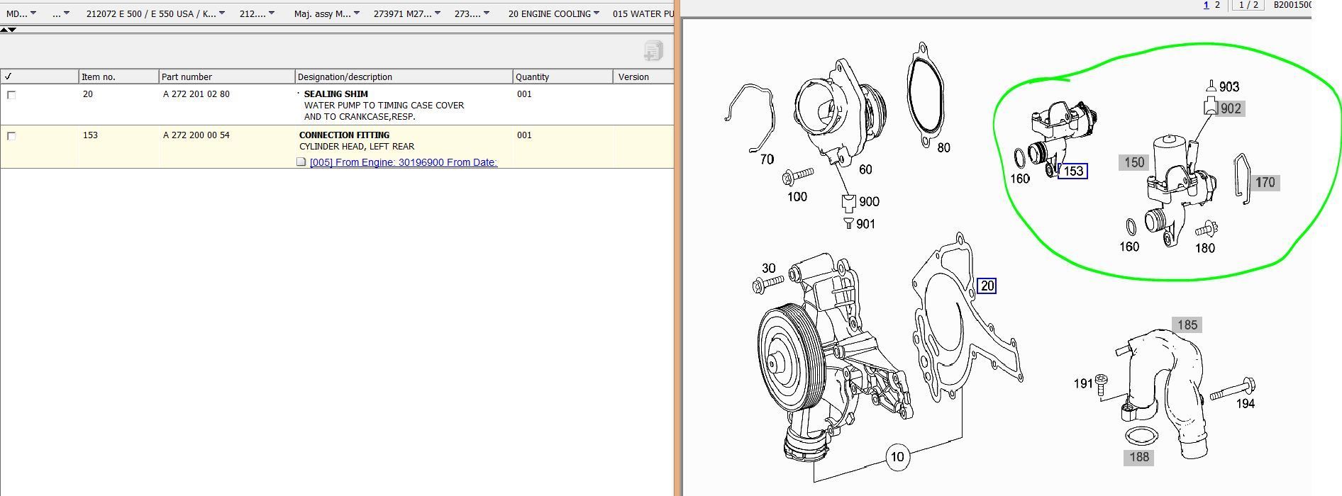

I hope you replaced also the plastic pipe ( V bank side ) <---- this pipe is where #180 hose connects to.
replace these two super hot hoses
Item 153 equivalent, is the pipe I meant

Quote: I hope you replaced also the plastic pipe ( V bank side ) <---- this pipe is where #180 hose connects to.
I didn't for a couple of reasons.
Mine was dry and in good shape. That, and the fact that its an easy enough part to get at (removing the top 'plastic' intake), made me decide just to leave it in place.
Others may want to replace theirs.
