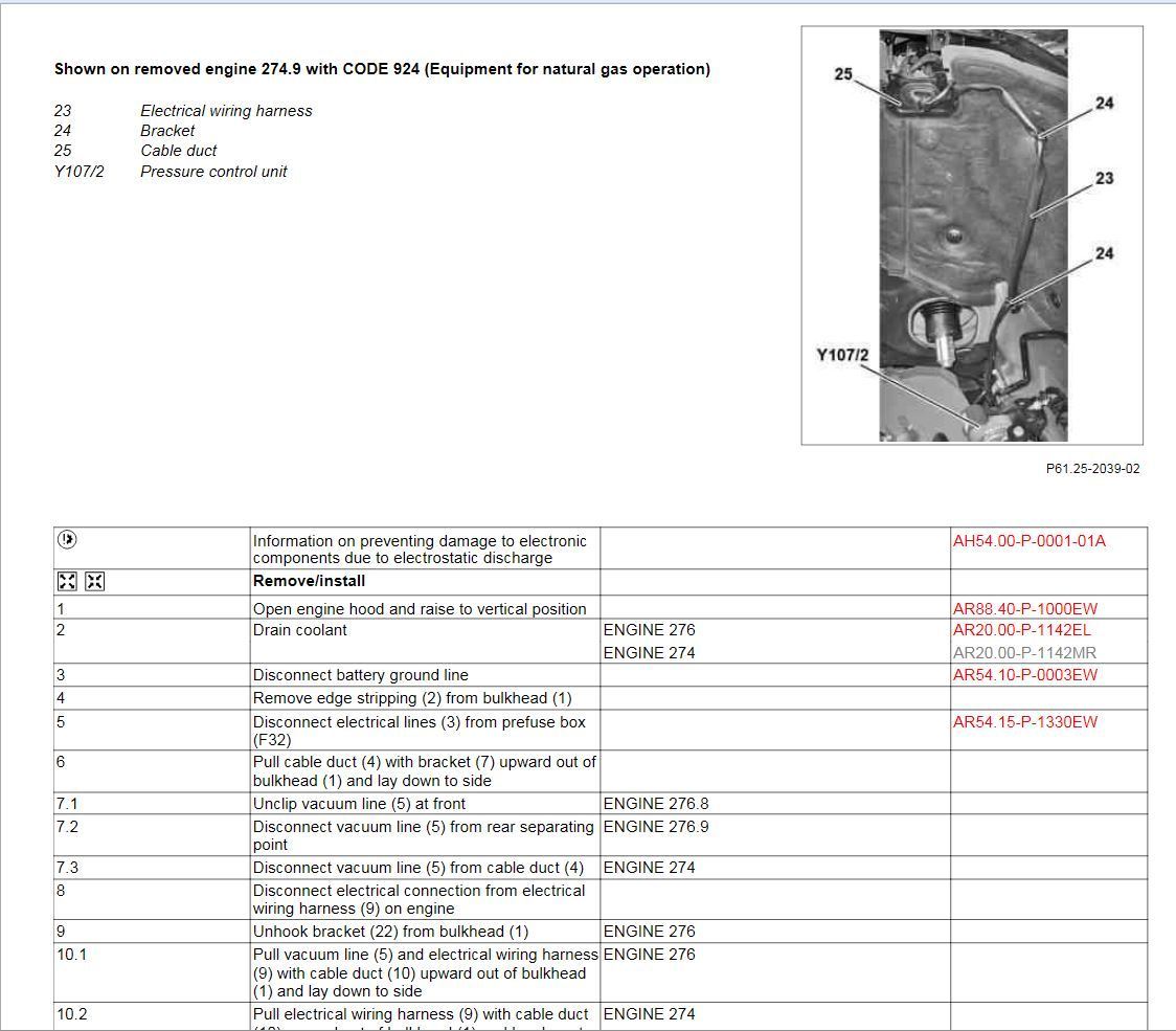

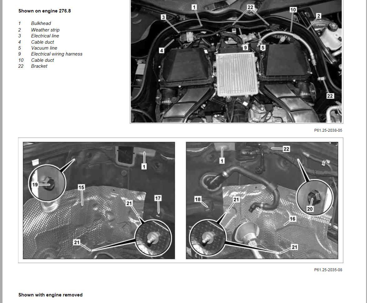

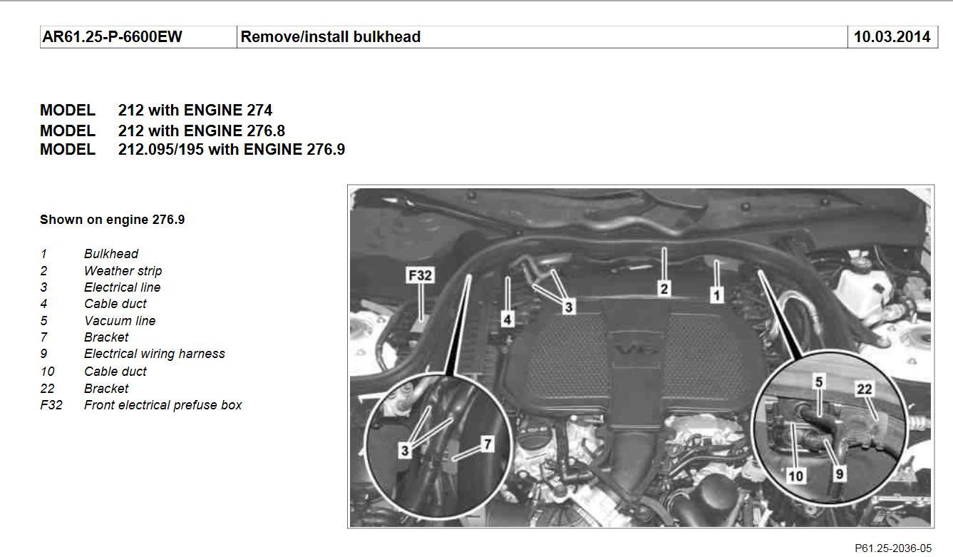

One of the instruction was to remove the center bulkhead.
So I go to the next WIS, REMOVE/INSTALL BULKHEAD. I am also attaching the PDF, 3 of them.

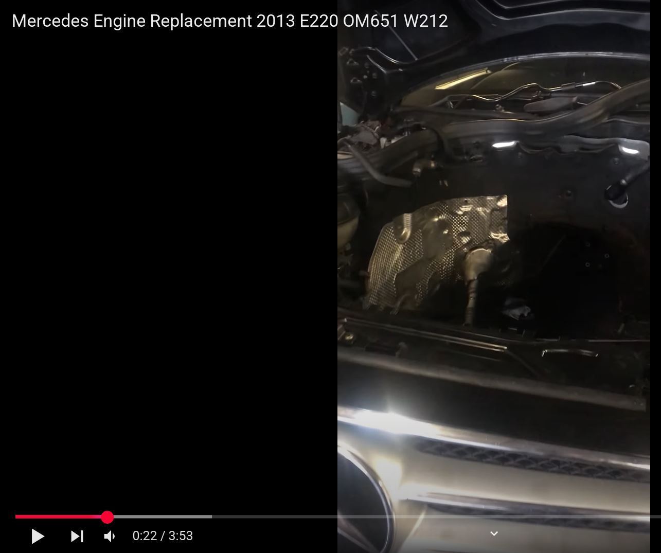

So I thought, I best check how does the Center Bulhead looks like when naked without sound shield and heat shield.
Above is a view from inside the car to the front bumper
Damn, the steering link has to be removed first when this bulkhead get removed !!!!
WIS did not mention that
That hole for steering system is a complete shut off hole, no cut away for steering link to clear when this metal bulkhead is removed upwards.

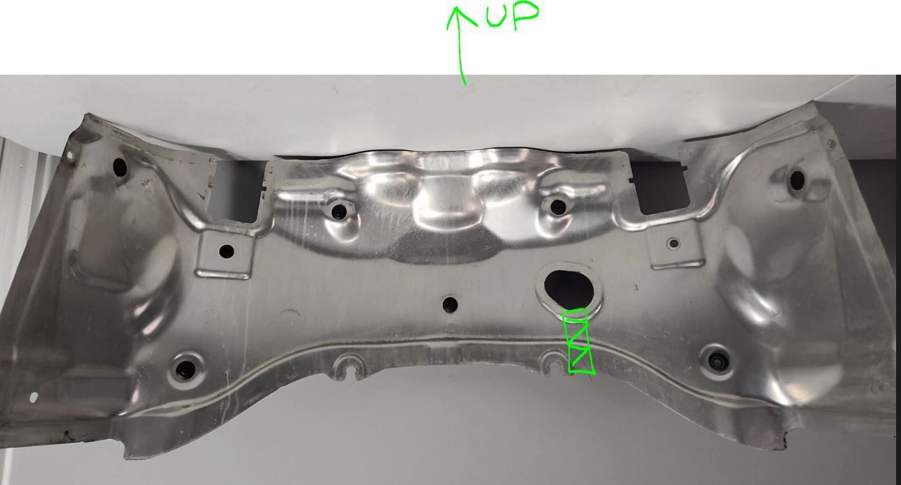

I thought there is a cut out for steering link, in green, imaginary cut out

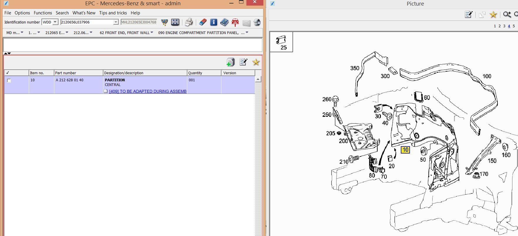

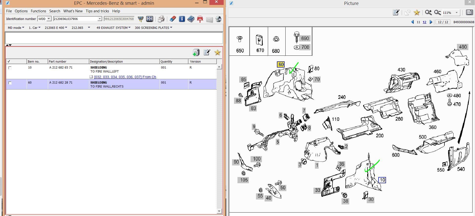

Above is the view from front bumper to engine bay.

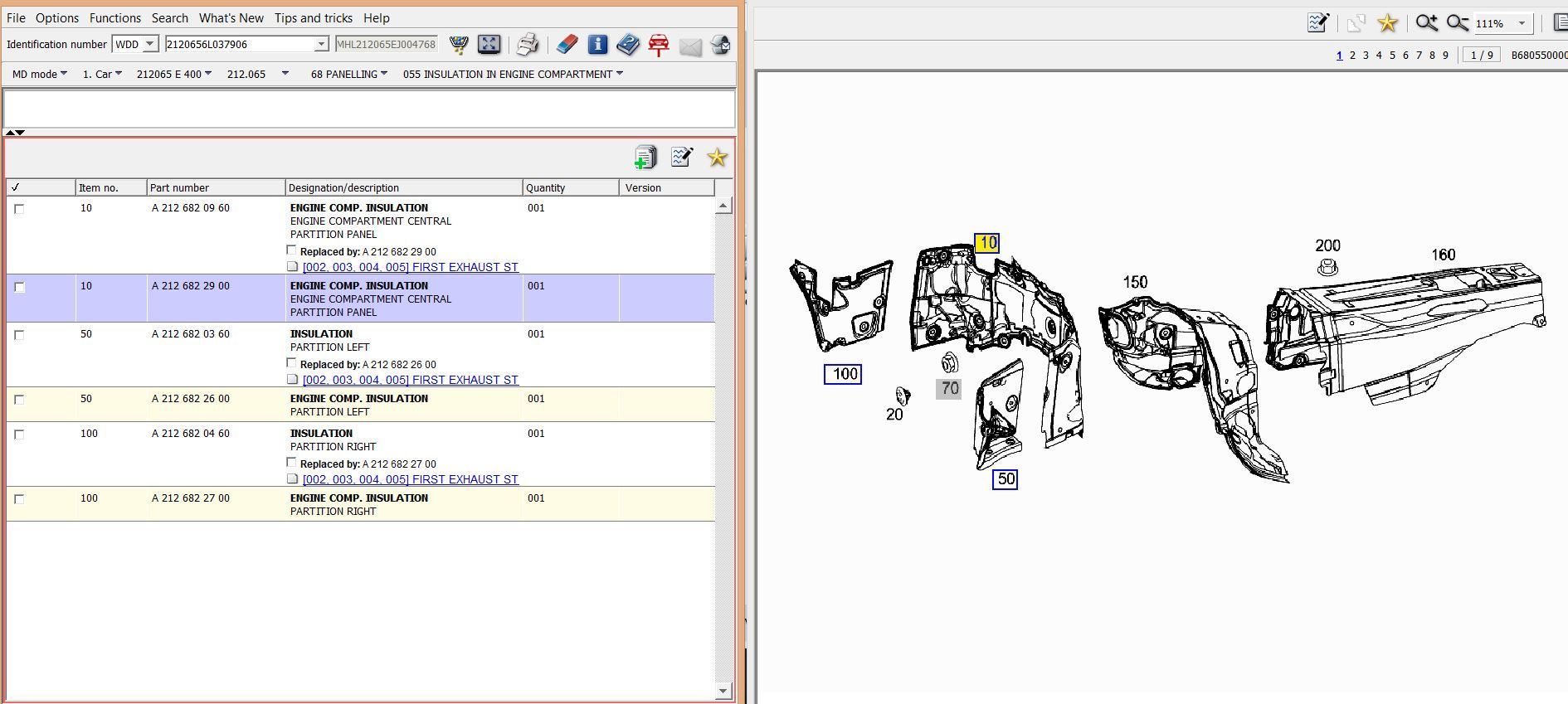

Item 10 is the bulkhead, called PARTITION in EPC
The black heat/sound shield is below : Item 10 too.

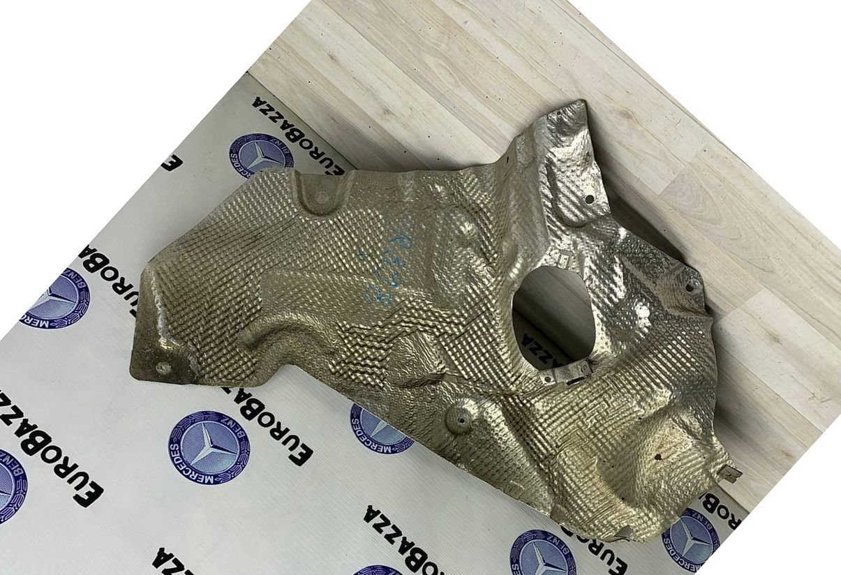

Ebay image of the blackie sound/heat shield.
Metallic heat shield of bulkhead, item 60 and 10. This thing has steering system hole too, and no cut out. So steering link must be removed.
I think WIS writer had too much beer or not a techy himself/herself....... he/she is imagining the engine is already OUT.
The first 3 instructions alone showed that the engine is still in engine bay......

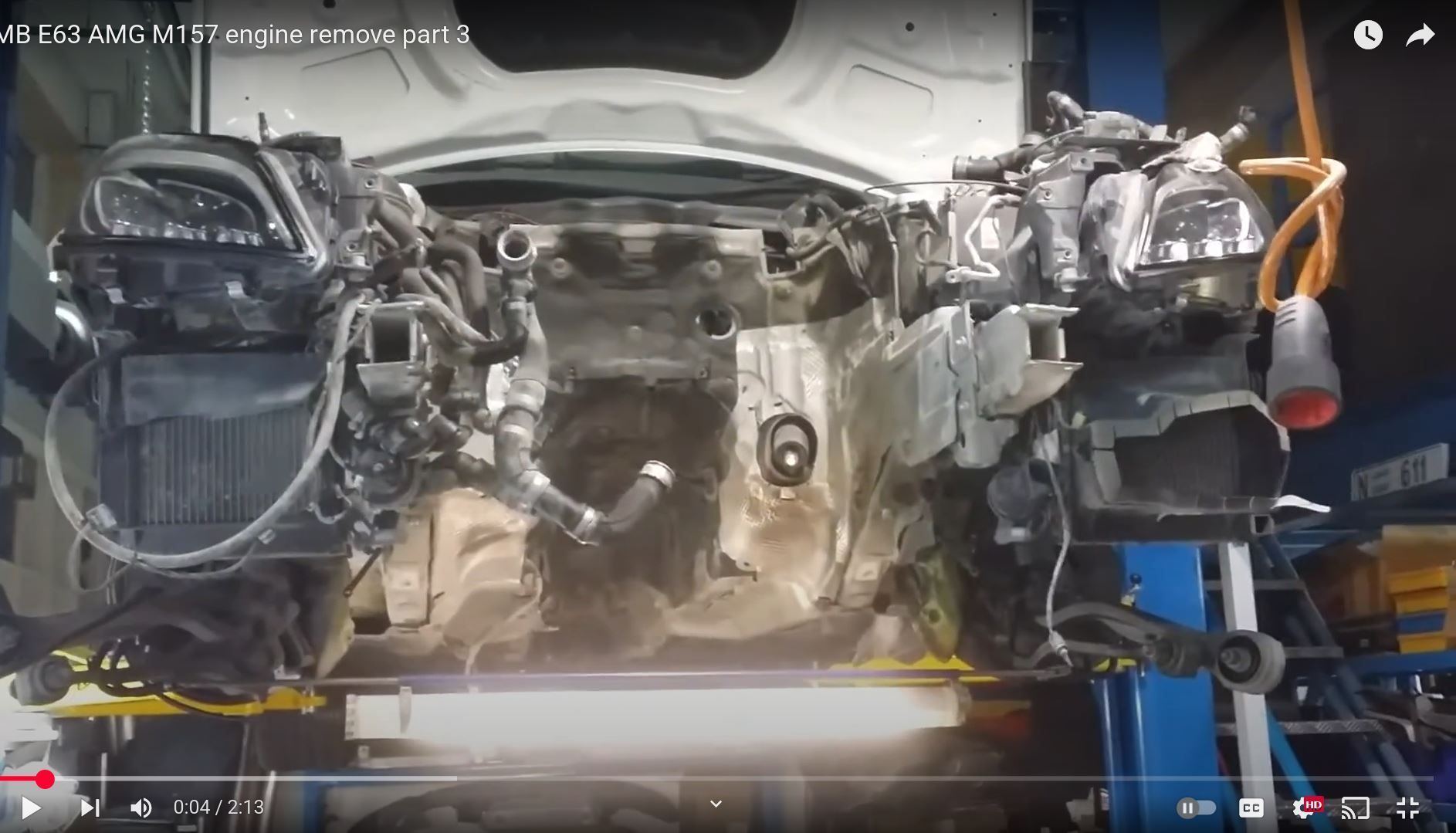

I often refer to Master Tasos video too. It helps visualize things.
Non twin turbo W212, get single sided metallic heat shield. This is a Right Hand Drive car.
