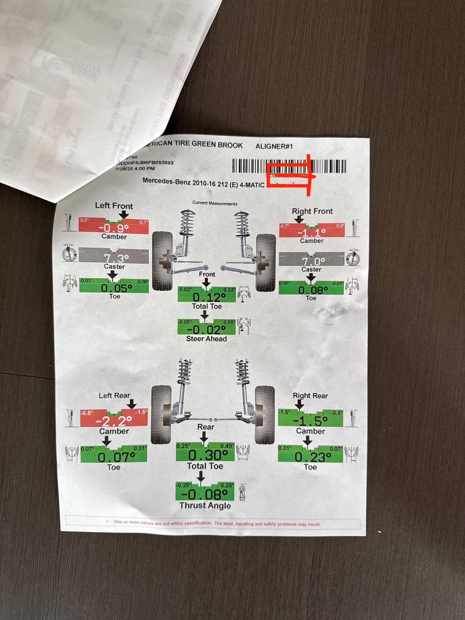

Hi All,
I recently got my tire alignment and after the alignment, below is the result. Is it okay to keep it this way or should I ask to do a front camber adjustment?
For the rear, I know W212 cannot adjust rear camber. I did some digging and it seems like I need to replace the control arms. Will this be an immediate concern?

When the alignment shop did the work did they go over the results with you? Usually when an alignment is done, they will show you the pre alignment values and then the corrected alignment values. The values you have as per Google translate to the worn suspension components you mentioned. After the new suspension components are installed you will need to get another alignment. I don't see any long term harm if you get this work done within a 2 week window. If you drive for months like this then your tires will wear out prematurely and your vehicle handling will be affected.

I was waiting for too long I didnt focus that much but the mechanic mentioned these values are fine. I also have the before value given, the numbers were improved but wanted to check if the front cambers needs to be re performed since its red valued.
as for the rear, i assume it needs to be assesed which part needs to be replaced? I was wondering if i were to rotate the wheels once every 3-5000 miles, should it be a big issue? Just didnt want to spend too much on it right now given i recently changed the brakes and tires.

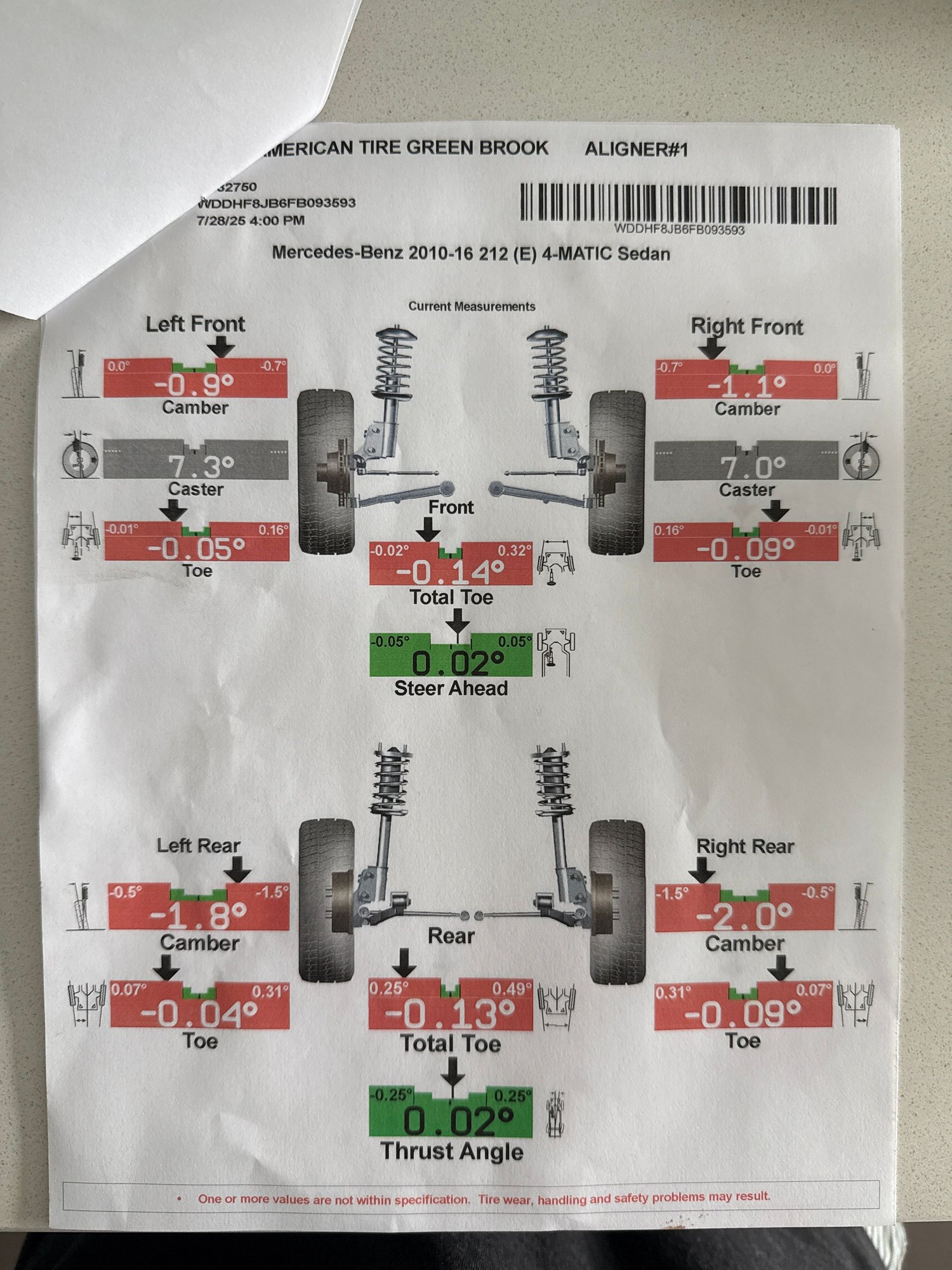

This was the previous values. Nothing was done on the front cambers.

There is no real adjustment on front camber without either buying aftermarket kit or the MB camber adjustment bolts (which are limited to what they can do)
