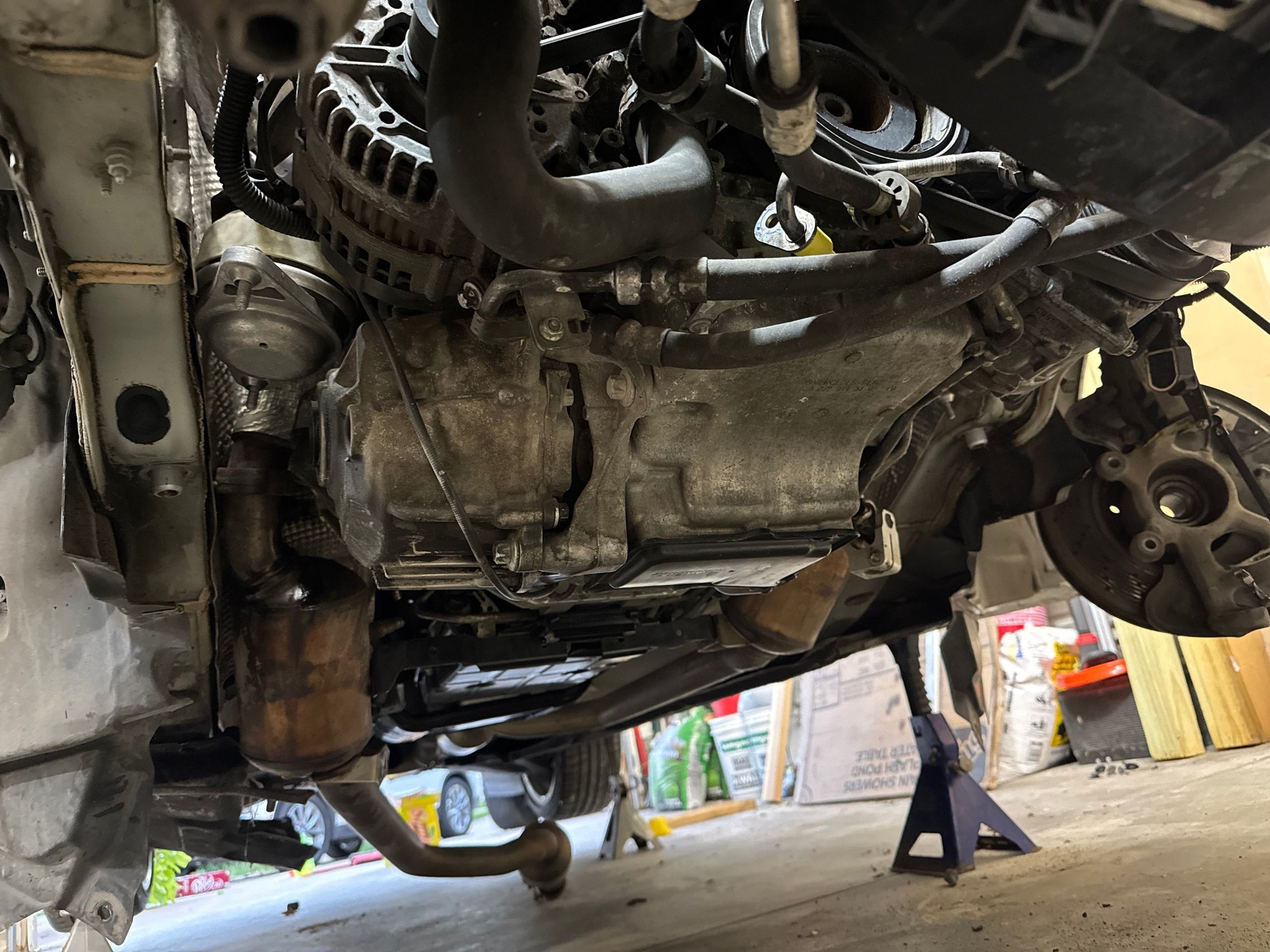

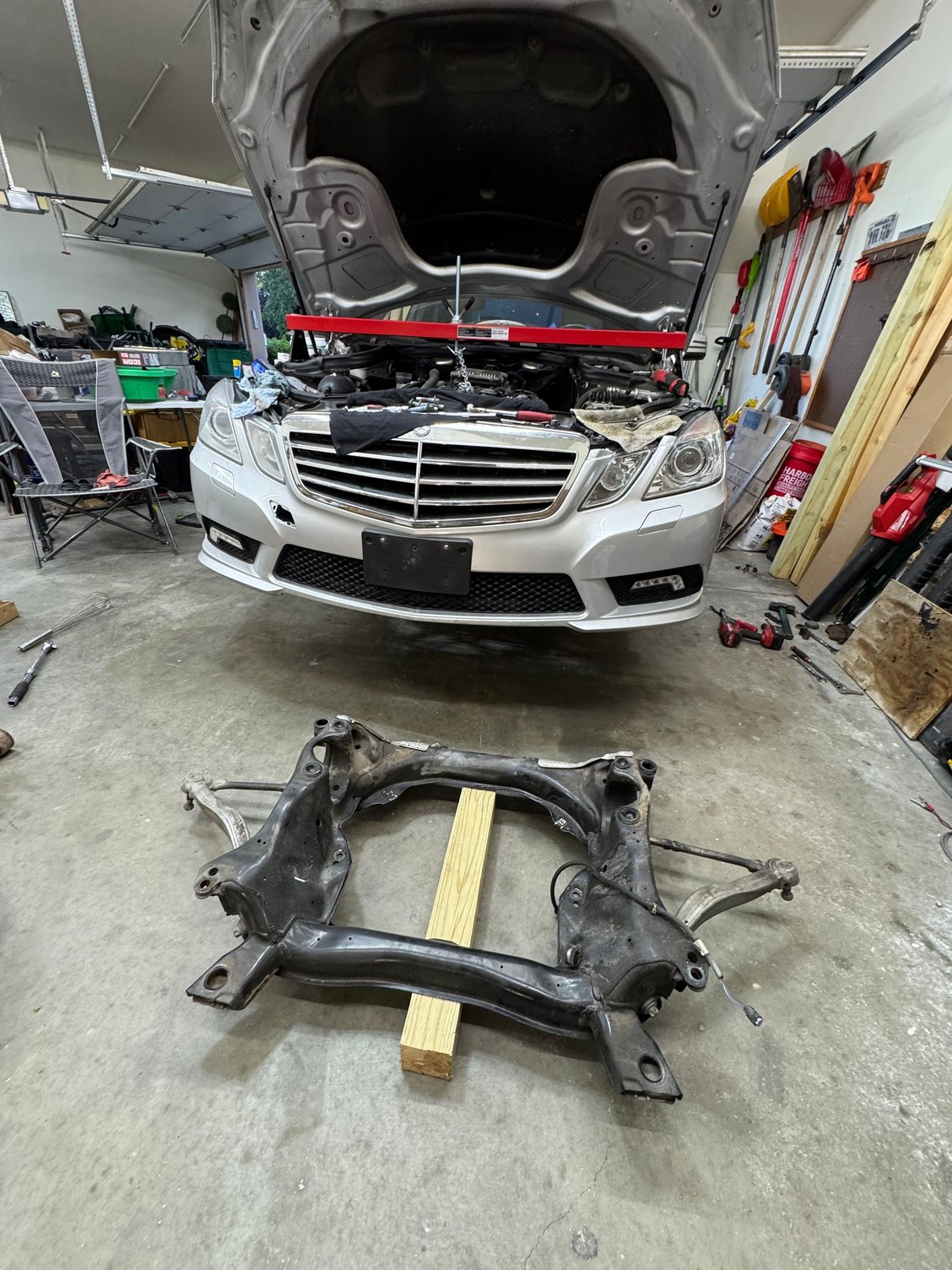

Hello all. I’m working towards removing the oil pan on the M272 in my 2011 e350 4Matic.
I am doing this fun and easy job to get to the o-ring on the pickup tube.
I’ve dropped the subframe so the oil pan is completely accessible.
it looks like the front differential must be removed as well?
It would be great to find the shop manual or how to on the oil pan removal.
Any help would be greatly appreciated!

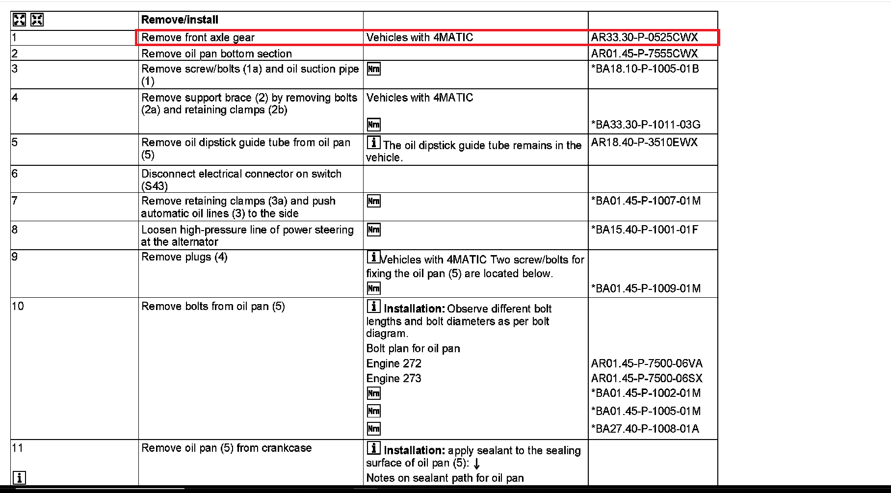

Heres a link to the manuals. I noticed sometimes the 2010 manuals have more complete information and should be the same for 2011: https://charm.li/Mercedes%20Benz/2011/
Reply 0
Aug 24, 2025 | 07:32 PM
Appears the front diff does have to be removed.
Heres the oil pan removal link: https://charm.li/Mercedes%20Benz/201...l%20Oil%20Pan/
Heres the front diff removal link: https://charm.li/Mercedes%20Benz/201...0and%20Repair/
