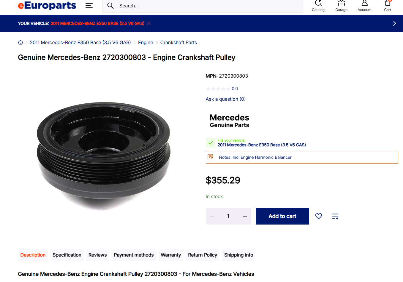

new harmonic balancer now compromised.
add inspection of the water pump pulley.
Replace the belt tensioner + a new Continental belt that matches what the vehicle needs.
Beware many parts suppliers list the wrong belt length even searched by VIN#.

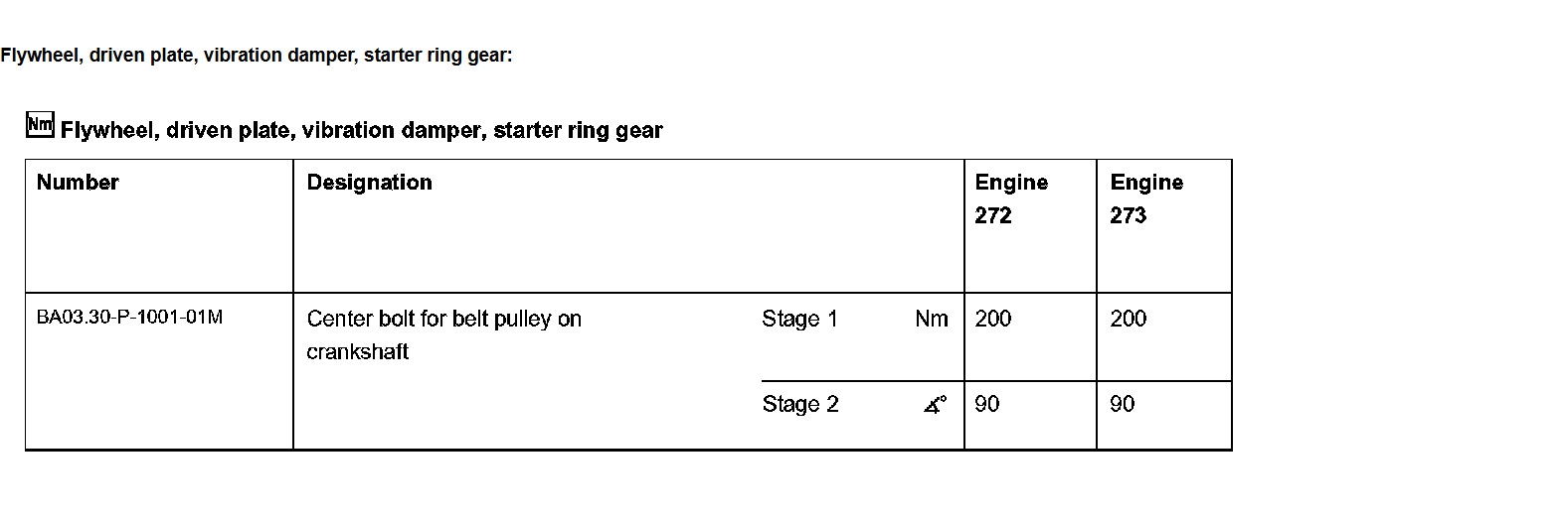

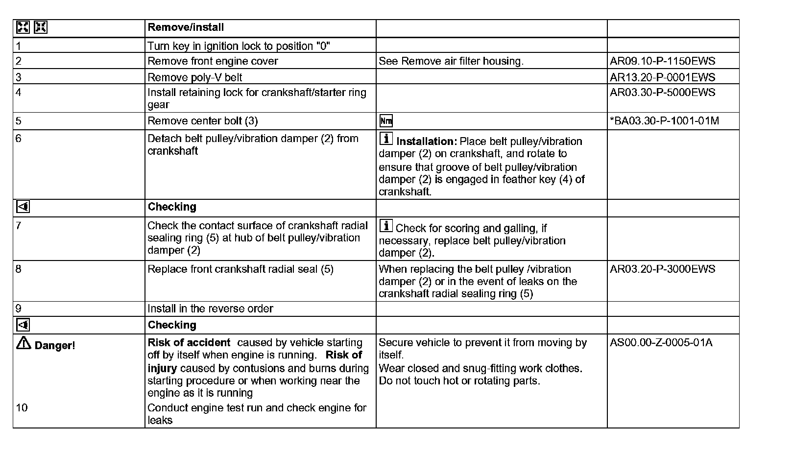

thanks for the instructions. i don't have the special tool to hold the main crankshaft pulley to undo the bolt. what people use instead?
thanks
Old Sep 13, 2025 | 05:50 PM
TimC300's Avatar
Joined: Aug 2023
Posts: 3,689
Likes: 1,110
From: MA Coast
If your pulley looks like the one below they sell the tool pretty cheap. I just picked the first one i came across as an example, im not recommending that specific one.
