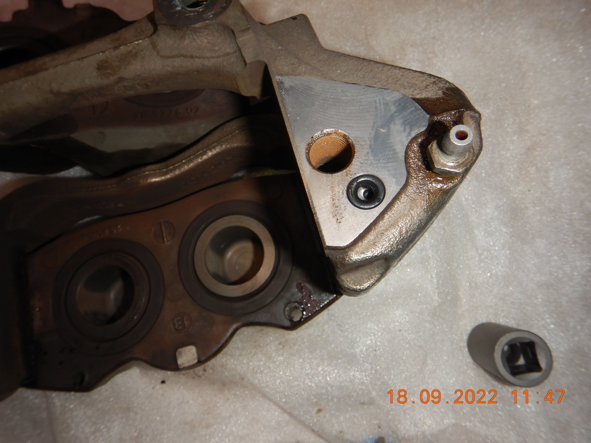

Guys,
If your car has 950 options, which is 4 pistons brembo, now you can buy the seal kit, but the important cross-over seal they still do not sell...bast-ardz.
For the 4 pistons of 344mm rotor, example E400 comes standard with 950 option for my country.
https://www.bremboparts.com/europe/e...ngkit/F_KT_105
https://www.bremboparts.com/europe/e...ngkit/F_PI_012

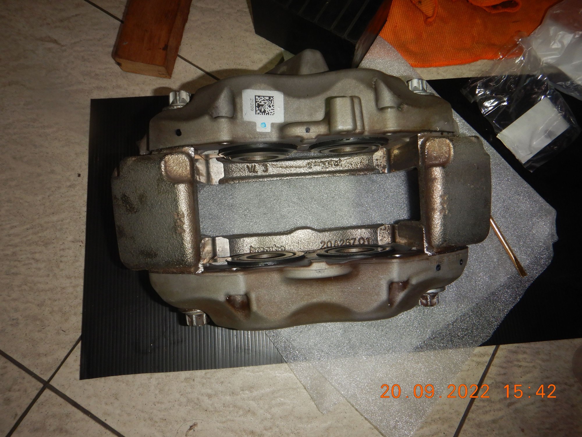

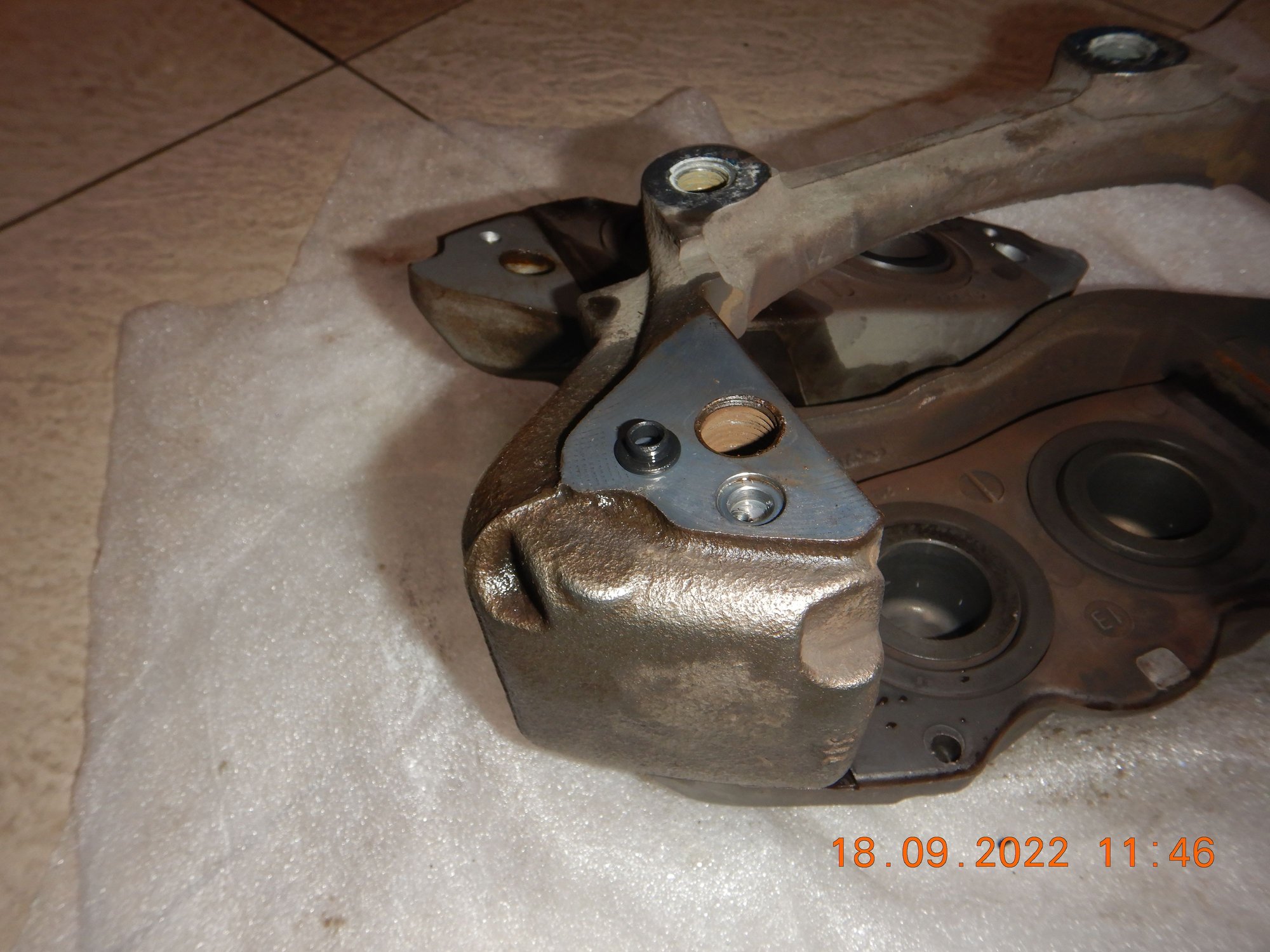

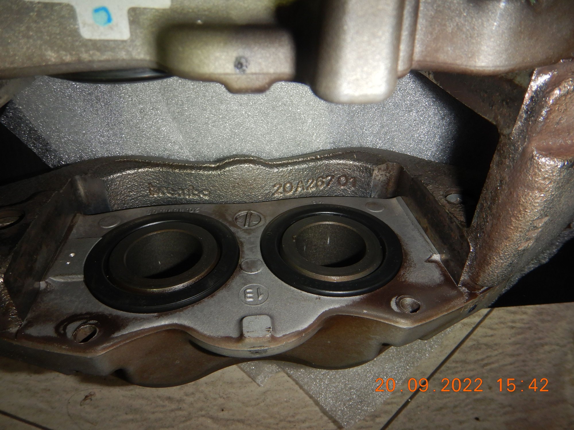

Without cross-over seal, don't open up the calipers. You can work without tearing up the calipers into 3 pcs.
This is the cross-over seal they do not sell . Unique mushroom shape. 1 caliper uses 2 of these.
The ATE 1 piston 42mm, seal kit.
https://www.bremboparts.com/europe/e...ngkit/F_SP_007
https://www.bremboparts.com/europe/e...ngkit/F_PI_066
Type ur car type here, now its my car W212.065 : https://www.bremboparts.com/europe/e...65/000059435-1
Happy servicing your now 11+ years old brake.

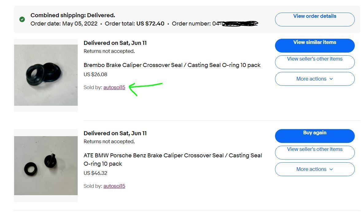

crossover “mushroom” seals are available from ABS sporadically as they get them in batches.. (currently out of stock)
https://autobrakesolutions.com/produ...o-ring-10-pack
There are some on eBay too.
https://www.ebay.com/i

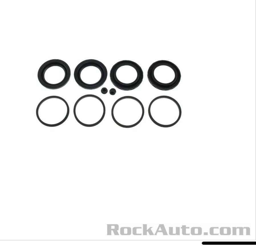

The ATE/Centric seal also should work in those calipers too, and is readily available…
https://autobrakesolutions.com/colle...crossover-seal
Centric also makes seals for pistons too.
Not sure you can get FVP where you are, but they include the crossover seals in their kit.
Good Luck.

In 2022 I bought from them AUTO BRAKE SOLUTION for the Brembo cross-over mushroom seal, but their Ebay name back then was different.
The quality is so so.

It’s been a while since I ordered those from ABS. Quality was always “useable” but the design itself makes duplication/manufacturing difficult. The one from ABS that is mis-formed is a manufacturing anomaly and should never been sent out. Pretty lame on their part.
I typically ordered double the amount needed for cheap parts like that. For that very reason. You shouldn’t have to, but that’s the reality of getting a customer car out the door in a timely manner.

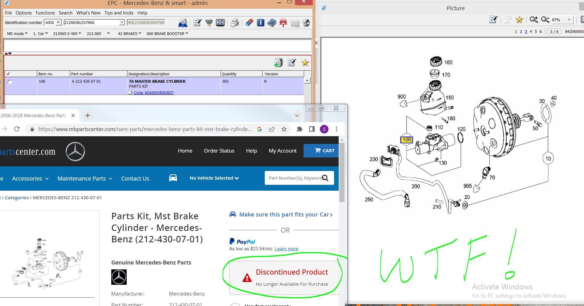

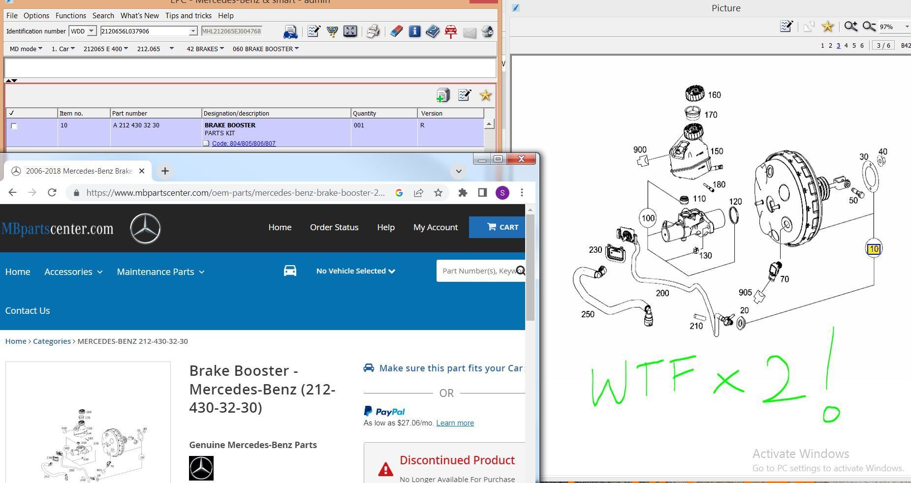

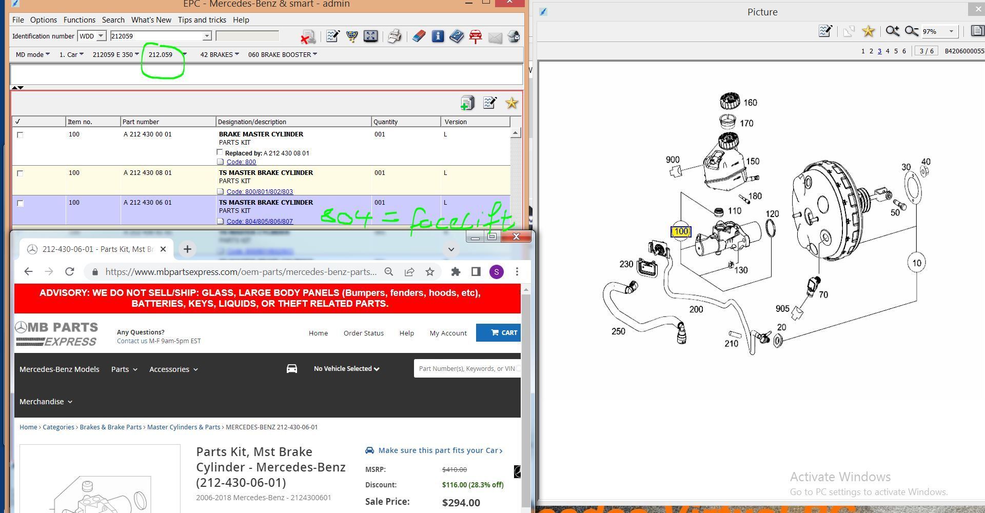

I just checked something..... being a RHD car owner is a nightmare !!!!!
Ohhh no no no no, this can't be happening.
I am looking at brake master cylinder and brake booster drum, this is UN-REAL !!!!
DISCONTINUED ??????
No alternative P/N given !!
How can this be, this car is only 11 years old.

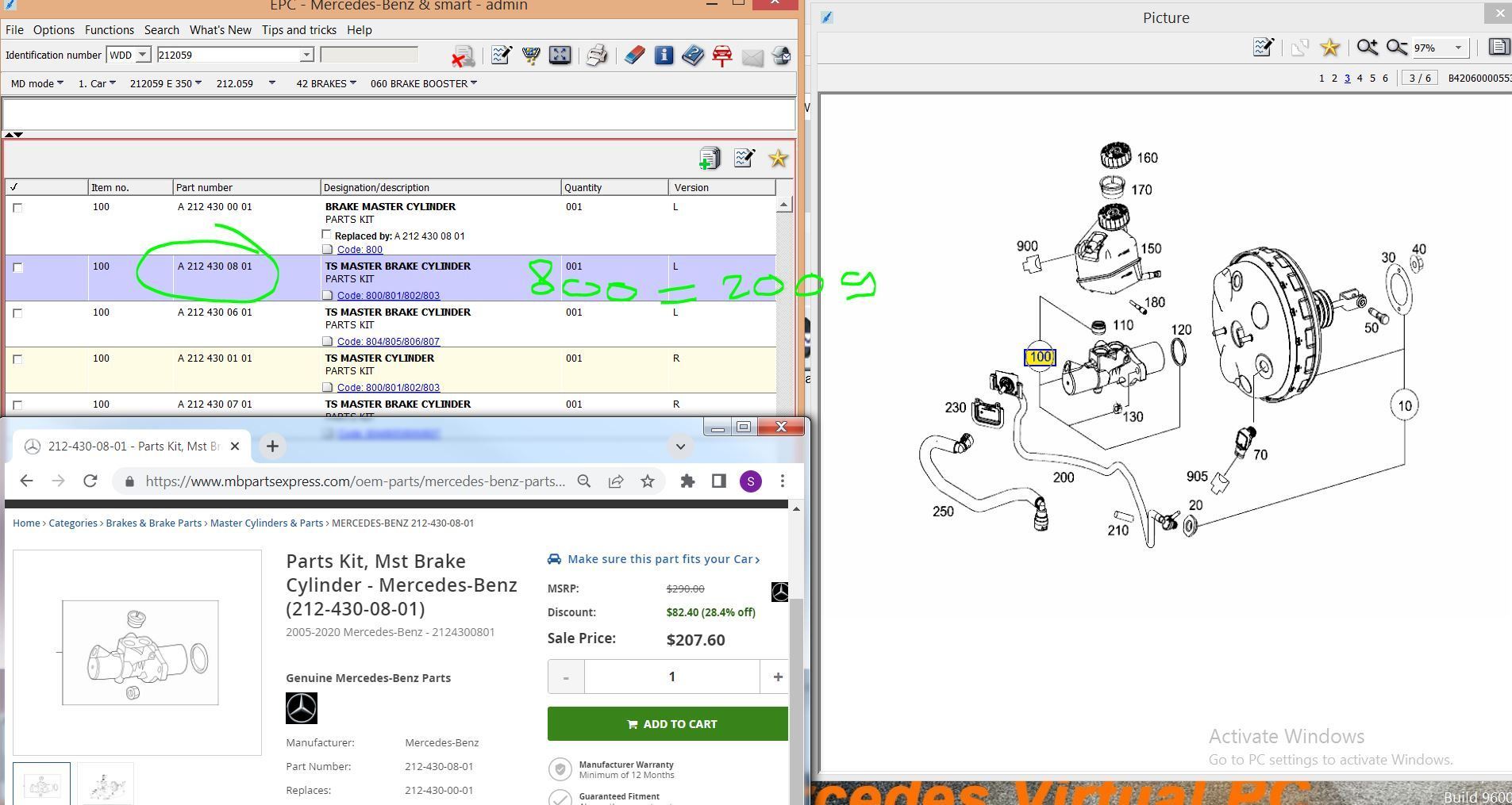

Let see LHD cars E350 W212.059 , M276.9 engine. 804 is year 2013, means facelift. It is available.
Good, year 2009 which means M272 is available
Blo-ody bast-ard, MB is being an azz for RHD cars lower sales volume.
I need to check with MB Indonesia, sometimes discountinued products are available when certain combined ordering quantity worldwide hits the minimum QTY.
The date of availability willl be unknown, could take 6 months or more, sometimes 3 months only, depending on your luck.
One of my timing chain was such case, I forgot left or right side, I needed to wait till indent quantity reached 5 pcs, only then MB germany will "make" it. How cheapo !!!!

I wouldn’t panic yet. In the post Covid world, there are three types of “discontinued” from manufacturers….
-There is the: We haven’t stocked nor has the part been ordered in a few years, but available in germany and we can ship it.
-There is the: We haven’t stocked nor has the part been ordered in a few years , but it can be manufactured for you in germany. Might take a while (and we may need an order for 10 before we start making it again)
-Then there is the: We’ll never make this part again (and you’ll need to source from the OEM supplier or rebuild)
As you mentioned, only way to find out for sure is to talk to your local Mercedes parts department, hopefully you have a reliable contact there….
Also MB changed the US website a while back and many parts that were back ordered now default to discontinued.

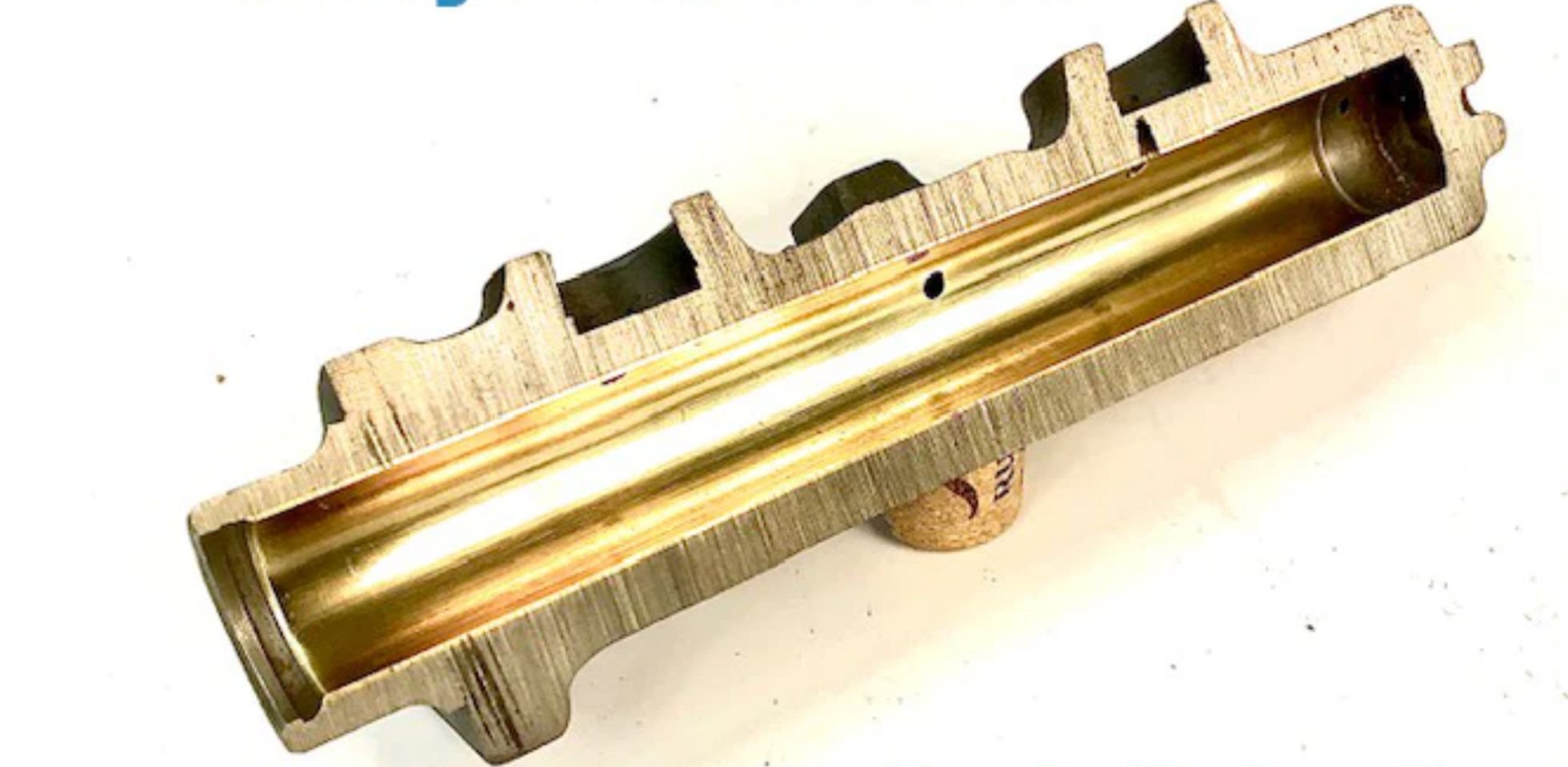

Plan B:
I usually sleeve masters cylinders for restorations and discontinued parts on cars that are worth keeping. If you don’t have access to honing equipment, lathes and mills,
White Post has been doing them for years and used to be a pretty reliable source. I know they changed owners a while back. Also Apple Hydraulics is reliable, they BOTH do boosters too. There are other places that offer this service. There are also choices in material, bronze or stainless sleeves depending on who does your sleeving.
https://whitepost.com/brake-sleeving...ding-services/
https://www.applehydraulicsonline.com
You maybe able to find someone local to you in Indonesia, as this is a fairly typical procedure for industrial hydraulics too.
Sleeving should extend service life of the master cylinder too.
Cheers.

Good news, MB Indonesia can order from Germany the brake master cylinder. US$563.00
I hope they wont come back in 30 days and tell me this part is no more in production, that is what they did for my brake vacuum hose item #250.
Minimum 60 days wait. OK, me dont need it anyway, but will need to keep it as back up just in case MB stop selling it at 15th year of my car age.
So I guess USA MB server does not keep track of RHD car parts and deemed such parts as DISCONTINUED.

Sleeving is a superior option for longevity. It alleviates some of the common issues seen in brake fluid hygroscopic failures, which typically start with pitting in the bore of aluminum and cast iron master cylinders. (and other brake components)
I’d bet it may be cheaper too…
Hopefully the Master is still available, but if it’s not, that’s a better route to take anyways.

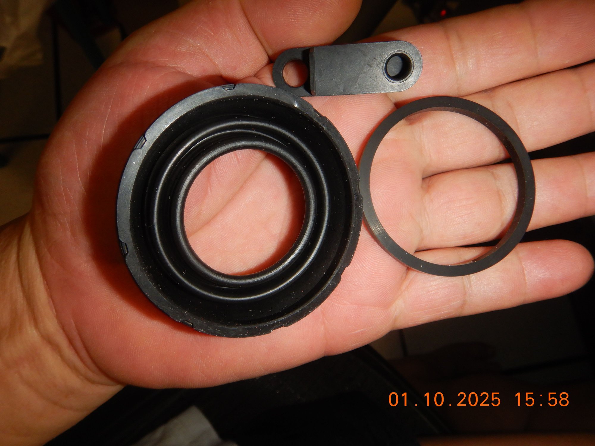

Surprisingly fast arrival from Latvia the FSP-007 ATE single piston sealt kit from Brembo.
30% total import duty including post office admin fee yada yada...so cheap.
The bleeder cap probably won't fit, as the one MB uses is fat.

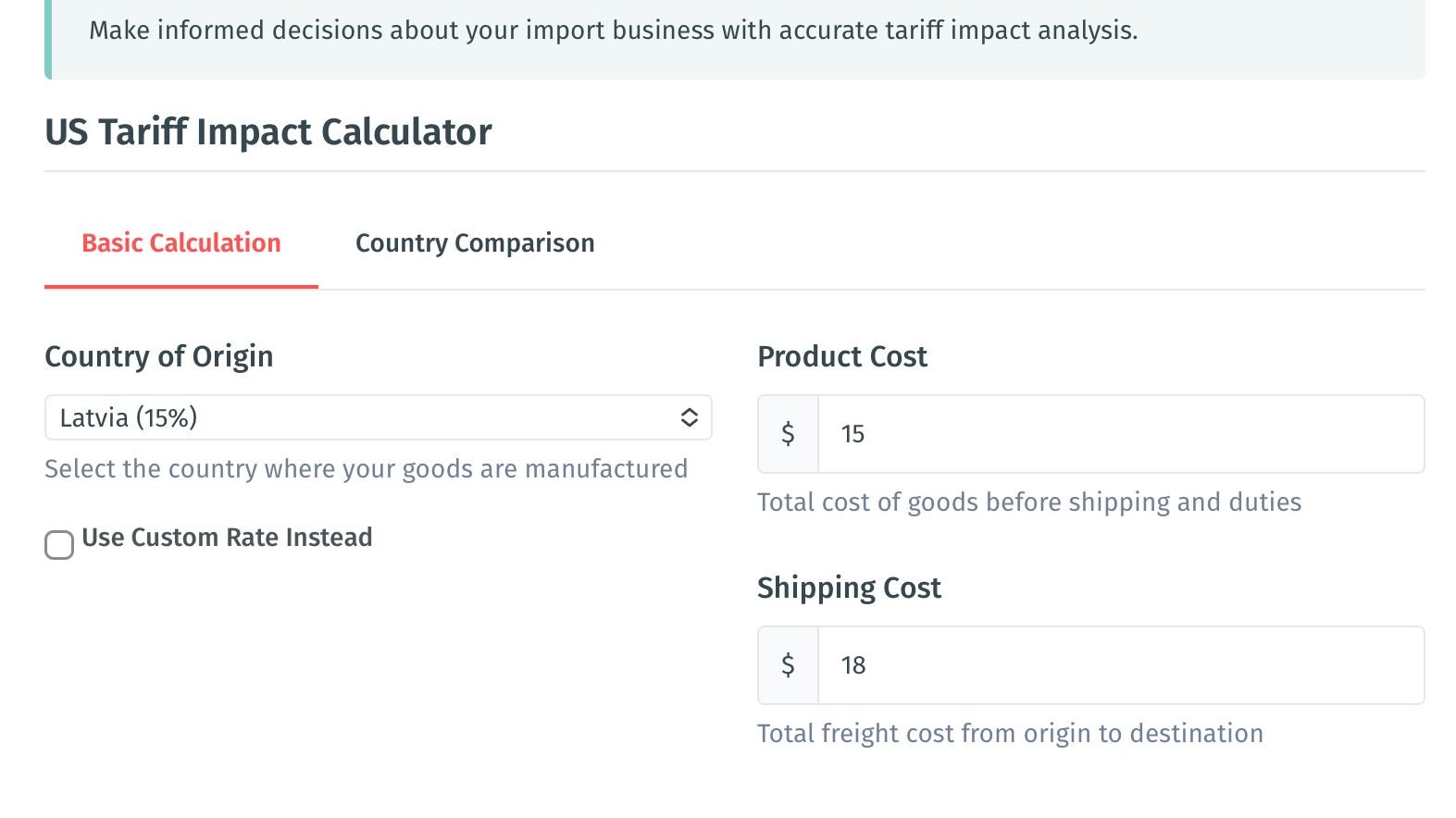

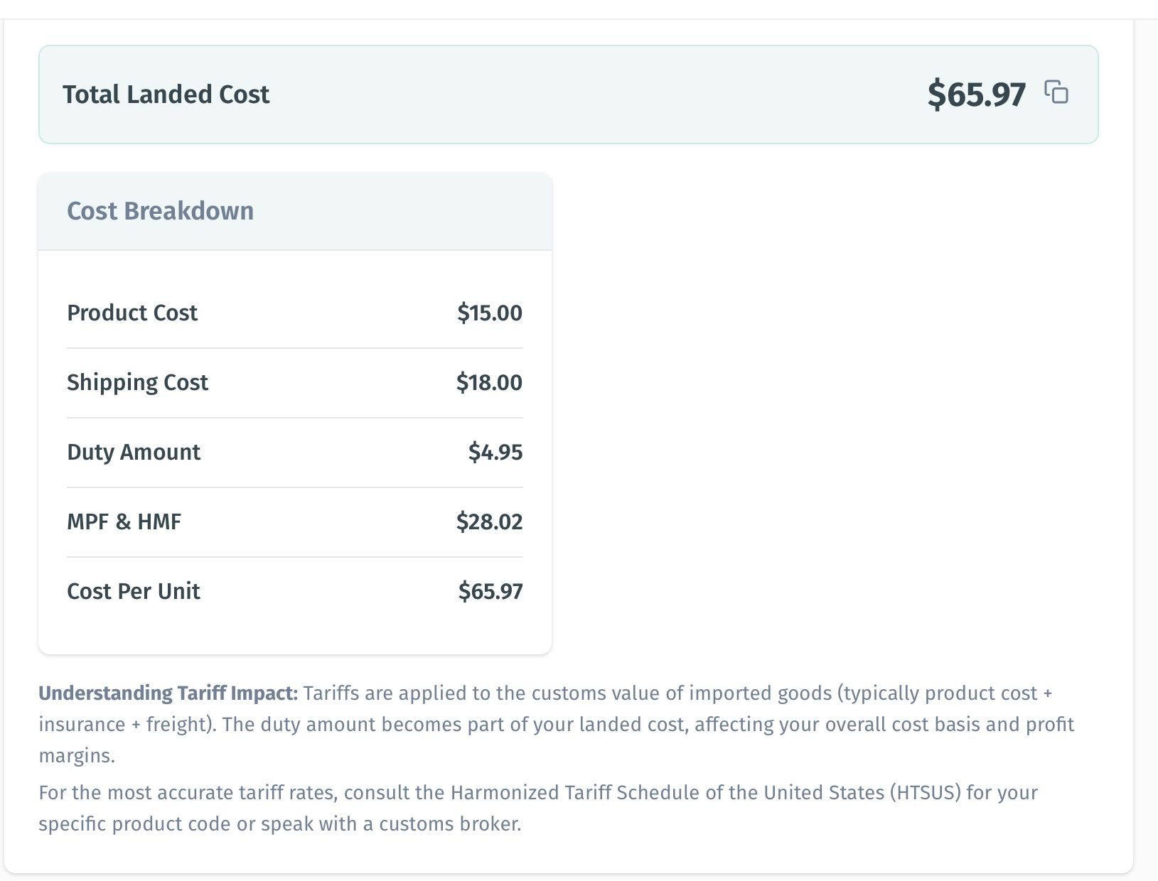

30% total import duty including post office admin fee yada yada...so cheap..
Well, it’s cheaper than importing from Latvia to US
100% with Harbor Maintenance Fee (HMF) and Merchandise Processing Fee (MPF)
