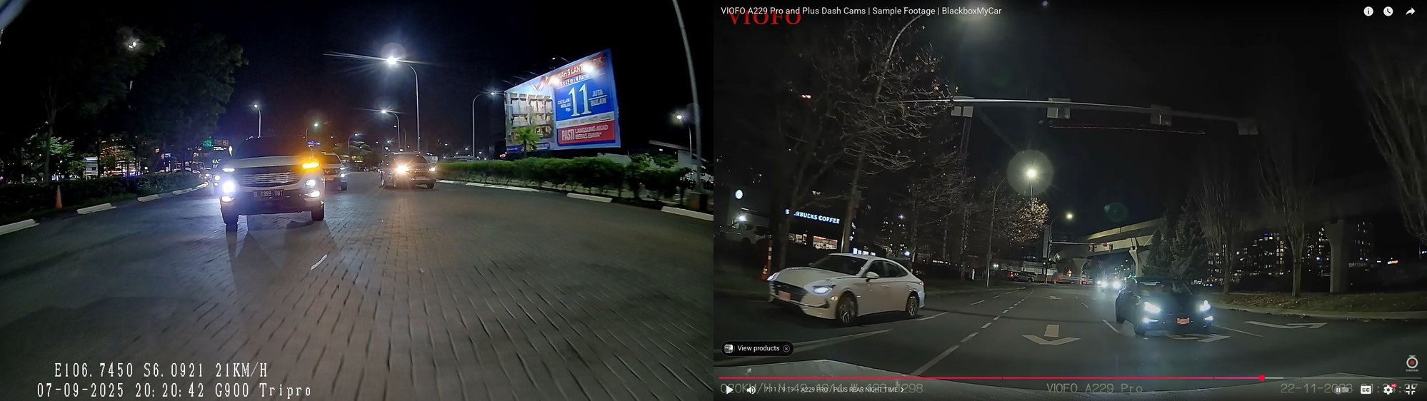

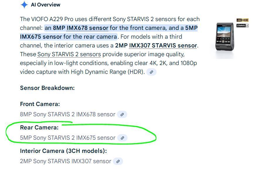

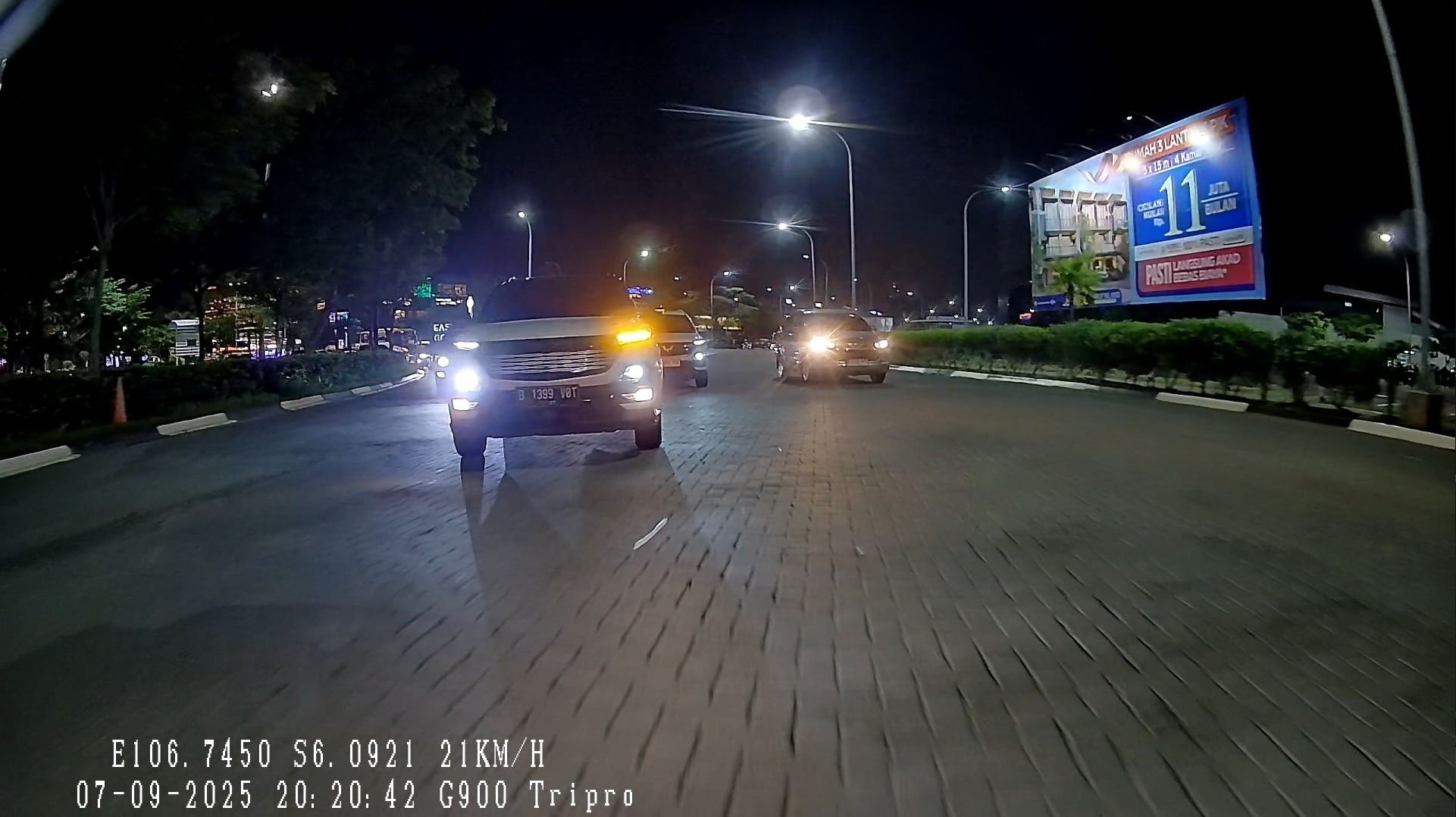

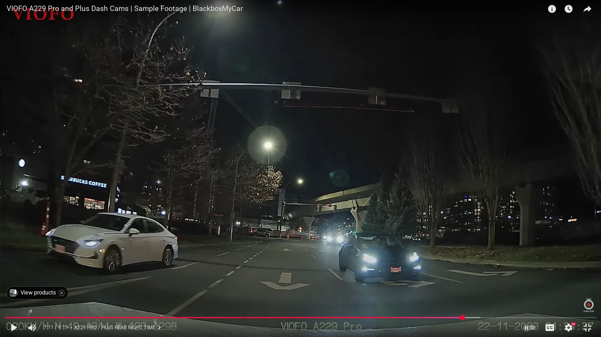

I think he meant very low resolution.
All standard/OE reverse cam of 2015 or older are 540 lines resolution at best and very bad in low light.
Aftermarket version now is 2.5K resolution as common and Sony Starvis 2 is common too, minimum Starvis 1. These are best low light camera sensors
Sample :

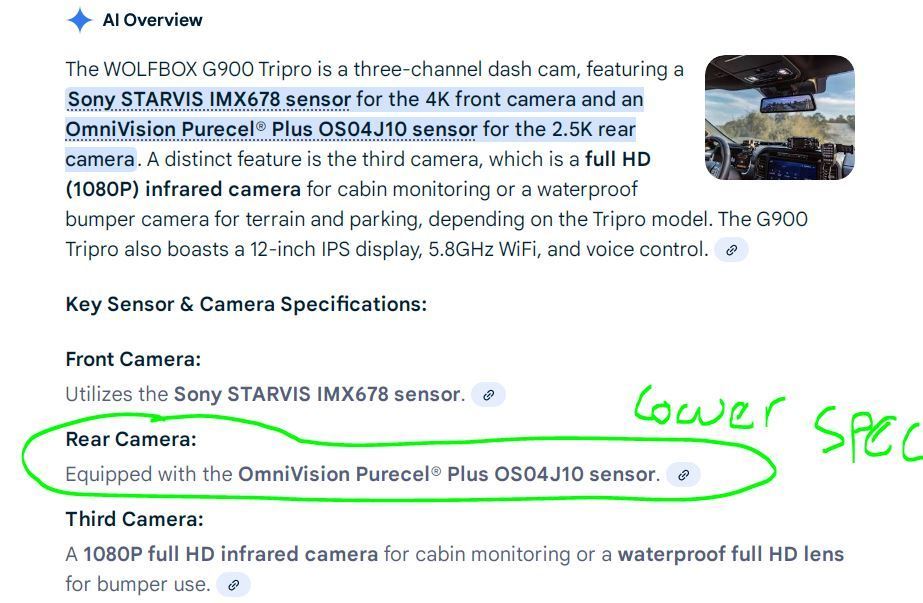

No one can beat Sony Starvis 2 sensor, ever since many years ago.
Lower end sensor for my rear cam, also 2.5K
I would pay US$100 more if Wolfbox would have rear Starvis 2 sony 2.5K and also for front bumper.
However, the current video processor in use may have issue if main front cam is 4K and the other 2 are 2.5K. all Starvis 2 .
Too much data to process.

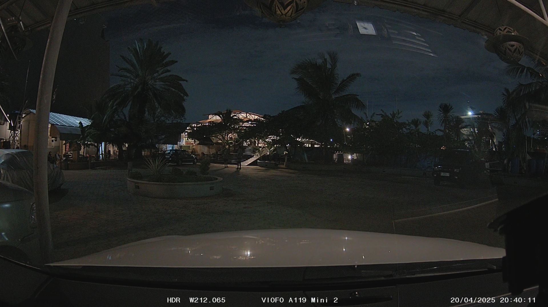

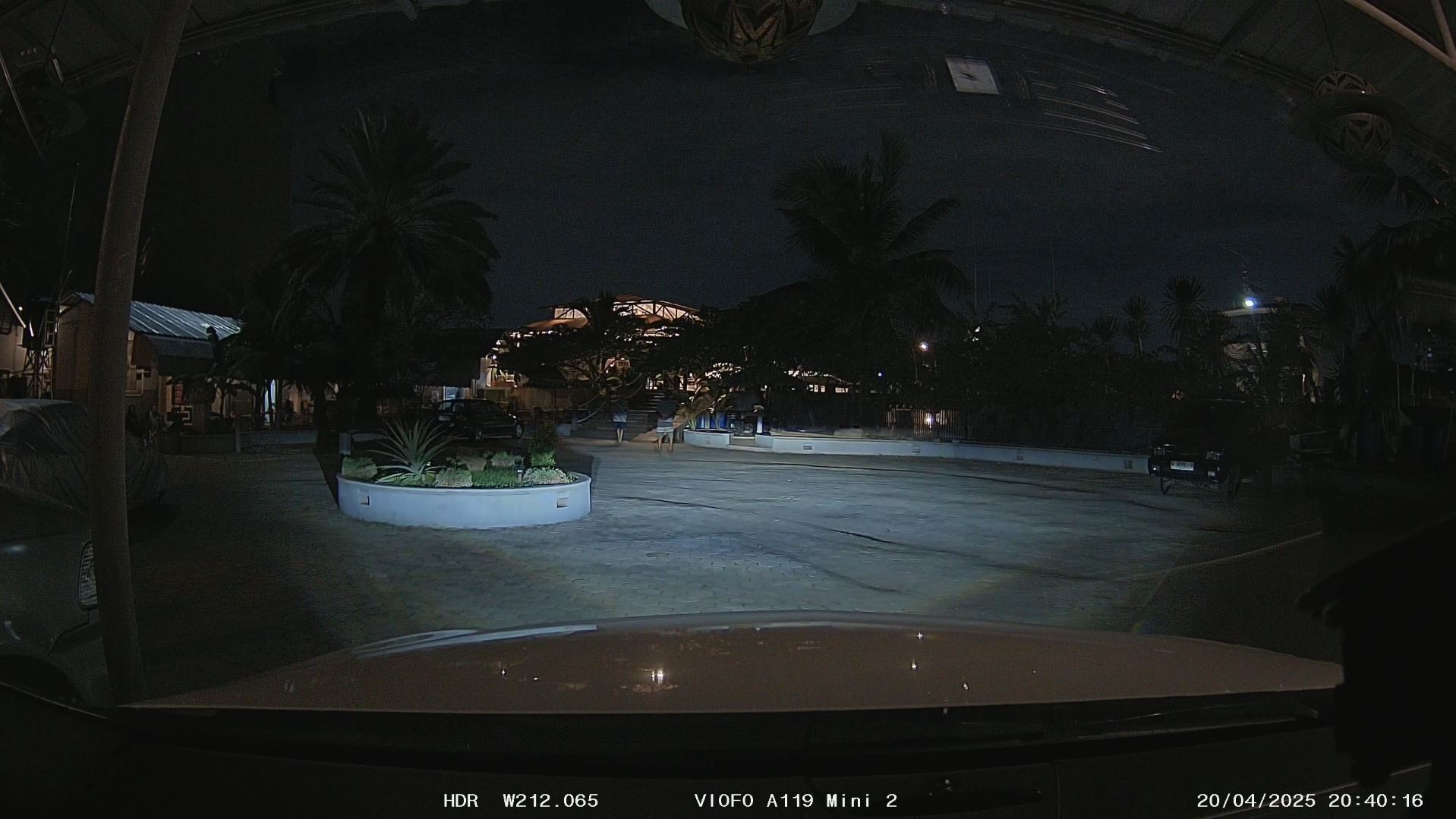

2.5K Sony starvis 2 as front view in very dark situation
Almost no noise.
With headlight low beam ON.
