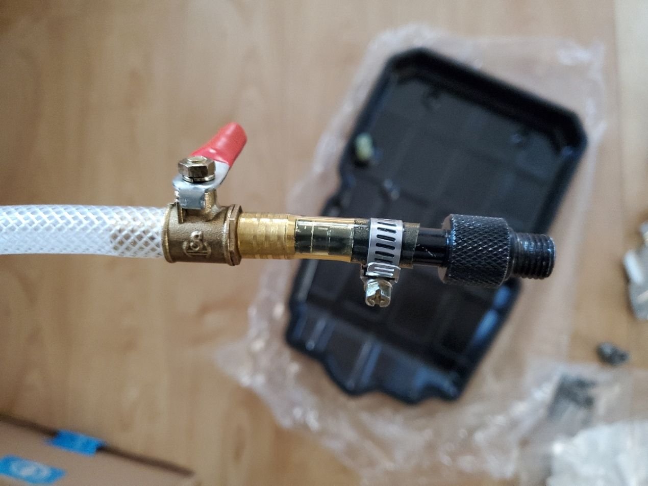

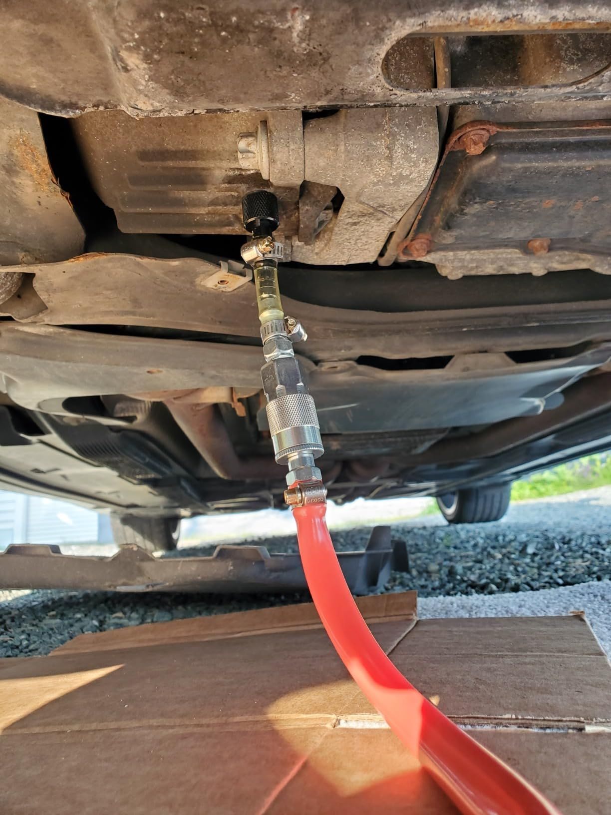

The transmission fluid fill adapter ATF109 also fits in the front diff drain hole. The transmission and front diff also use the same drain plug gasket.
I used an inexpensive fluid pump to pump in the differential fluid. At the time I used quick connect fittings but have since replaced them with an inexpensive shut-off valve.
I drained the old fluid and measured, it happen to be the same amount the manual says it holds. So I pumped in the same amount plus a little bit extra for any drips when installing the drain plug.
Just an example of the adapter:
Type of fluid pump I use for gear oils:
Shut-off valve works better.
