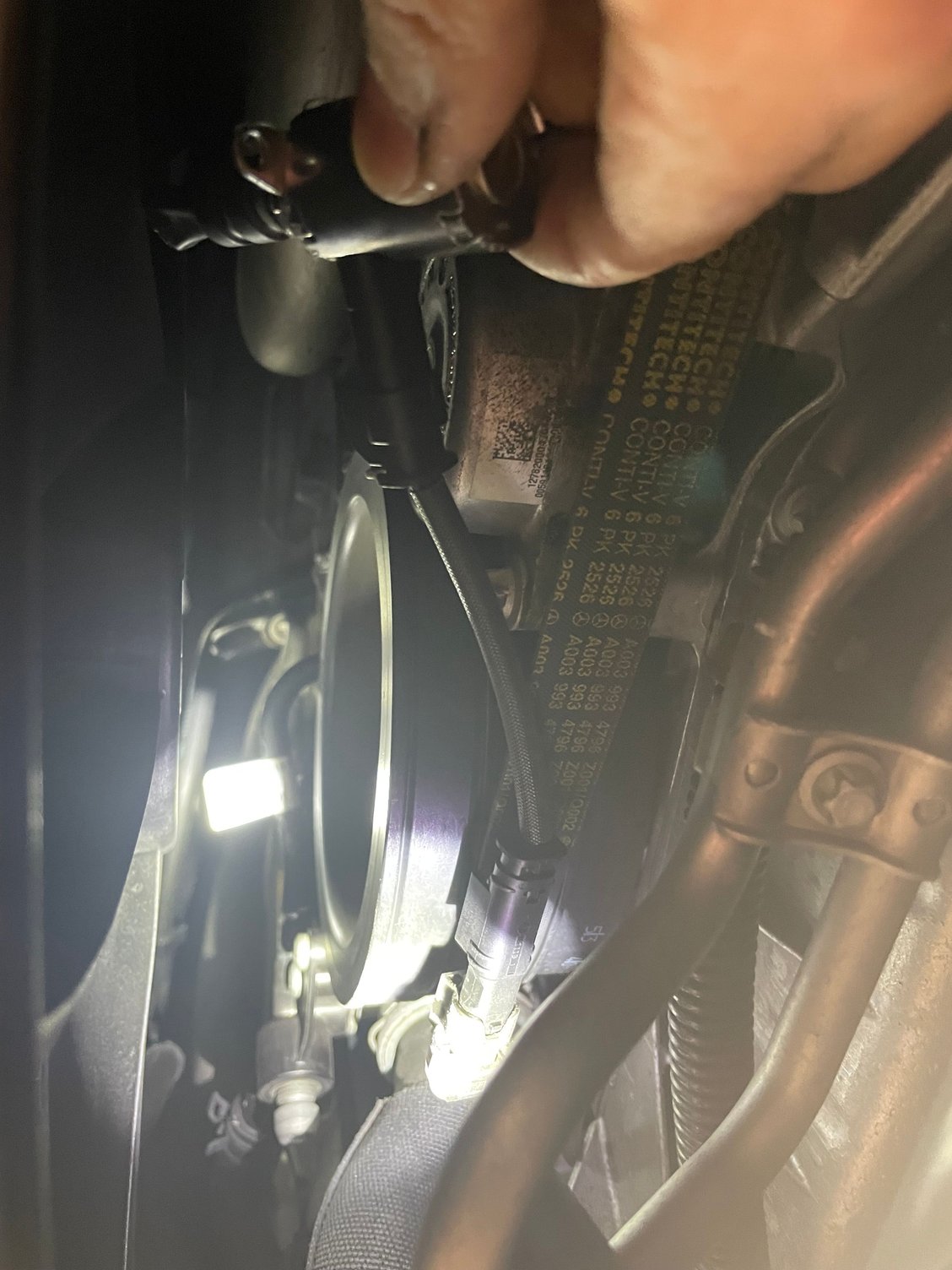

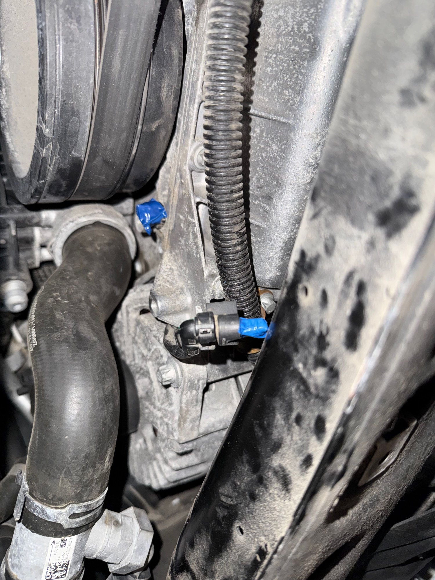

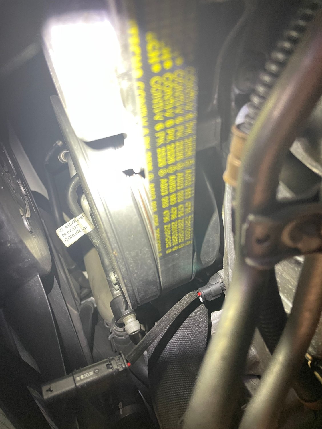

Hi all,
Today has been a busy day in around the E550. Slightly off-topic, but I will share anyways: I installed new winter tires (Continental VikingContact8) on the vehicle to prepare for the winter season here in Canada. The ride sucks! They are a very soft tire being a dedicated winter tire, but they are good other wise. The vehicle feels much less agile and a little more floaty, and the steering feel is less direct. This of course is a compromise I am completely willing to live with given the purpose of the tires is to handle the ice/snow/cold until the spring season. Increasing each tire to 39 PSI helped quite a bit with the feel.
Secondly, since I purchased the vehicle, my dynamic driver seat was completely inoperative. I could hear the pump whirring and humming when getting in the car, but after a minute or two it would shut itself off. After a few weeks of procrastination, I have diagnosed the issue - luckily, the green airline was disconnected from the pump in the trunk. I think I have gotten lucky with this fix as it took just 20 minutes and cost me nothing. Wonder how it got disconnected?
Now, back on topic. While doing all of the above, I did also get under the vehicle, dropped the undercarriage covers, and went searching for the oil pump solenoid. It was a bit of a pain to disconnect as it seemed to have almost "seized" onto the connecter - but I was able to get it off. I cleaned up both ends of the plug and the connecter, did not notice any oil leaking out into the plug (also checked the camshaft sensors at the top of the engine, no oil there either thankfully)
I covered them generously in some electrical tape (might look for a better method but this seemed to be okay) and zip-tied the plug to secure it so it doesn't end up in the radiator fan.
Initial Thoughts with solenoid unplugged:
Idle: Much smoother, when in park with engine running. When stopped at a light, there is still a slight "shake" - however it seems to have been reduced by about 75%. It is still there, but considerably less noticeable than before.
Transmission: No noticeable difference in upshifts/downshifts or general performance of the transmission.
Throttle response: Massive change, in my opinion. There is still obviously some delay present, but the car is much more responsive and this is a significant improvement. Driving around the 1500rpm-3000rpm now is a lot more enjoyable thanks to the extra responsiveness.
Fuel economy: I know fuel economy numbers should not change too much either way, but I am getting more or less the same numbers as before. Pic attached on a brief highway drive, pretty good for a 4.7L V8 TT!
To keep this thread on-topic (and not to become a clone of the original thread(s) reagrding this) I will report going forward what I notice during freezing temperature, extreme cold, or whatever we will end up facing this winter. I would encourage anyone else that has done this mod and lives in colder climates to do the same thing here.
For the more knowledgable out here - let me know if there are certain things I should check/monitor data wise. I do not know much about what might be useful, but, if it is helpful - I am happy to provide some data in freezing temperatures if you let me know what would be helpful.

Originally Posted by rbdz
Hi all,
couple items for you to consider, after having seen your method of protecting the plug and the solenoid plug receptacle.
The engine will heat up that electric tape. It will fall off and it will end up flying into the radiator fan or somewhere and hopefully nothing bad will happen, but you would like to avoid this.
Subsequently the plug will be uncovered again, and you will have no way of knowing that it is uncovered again.
We designed a method collectively in the main thread to use a pigtail harness to plug into each end, the solenoid receptacle as well as the engine, harness plug, two pigtails total and at the end of those wire pigtails, you can use hot glue or some other sealant to seal off the electric electrical end.
Also, if you're gonna use zip ties consider using steel zip ties, the plastic ones will dry up and failure overtime, particularly with engine heat exposure
review the main solenoid thread to see how this was done in depth
here's a pigtail on my engine side
second pic is a dummy solenoid I attached and sealed to prevent soft code
Nice - just ordered a few of those pigtails. That's a great idea. Thank you for sharing this!
Great method, someone also suggested RTV silicone if I recalled correctly.
