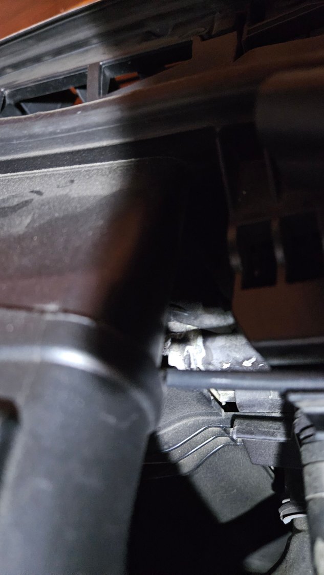

DRIED COOLANT EVIDENCE
the standard leaking radiator seams are obvious without special procedure...
MY'14 here:
heat soaked radiator seams
heat soaked radiator seams... coolant salts deposits
