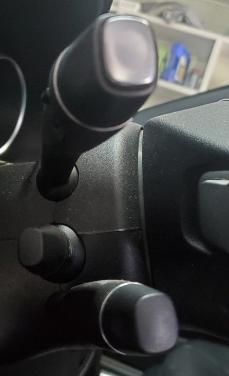

You want a REAL bad feature in the W212? In one of my cars the blinker is above the cruise control...in the other...switched......
push to wipe stalk...
The picture above is the one I have... push to wipe and DistroPlus stalk all the way low.
Another flipping troublesome setup are steering column stalk levers with push buttons...
  • the Right side stalk ... push for Park!!
  • the Left side stalk ... push to Wipe
Presumably there is some kind if fail safe that orevent blowing up tranny when commanding PARK at freeway speed... I have not experimentef with the 15mph limit.
I've trained my right hand priority is to hang on the wheel so my left hand can be free to work cruise stalk, signals and wipers.
The wobbly wiper arms always impress me so I control "manual wipes" when possible. The wiper mechanism is beging for a overall with high temp silicon lube like strut bearing mounts were. Perhaps this winter ??
I remember back when I was test driving an S212 Wagon, which was the 1st I drove with the column stalk for shifting. At 70 mph I mistakenly pushed the Park button (at the time I did not know that button was for Park). Nothing happened to the transmission, but a warning popped onto the screen letting me know that the car should be stopped before trying to engage Park. I was very happy that nothing happened! Bought the car and it was wonderful.
