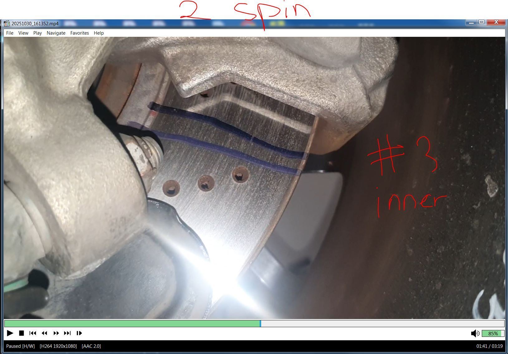

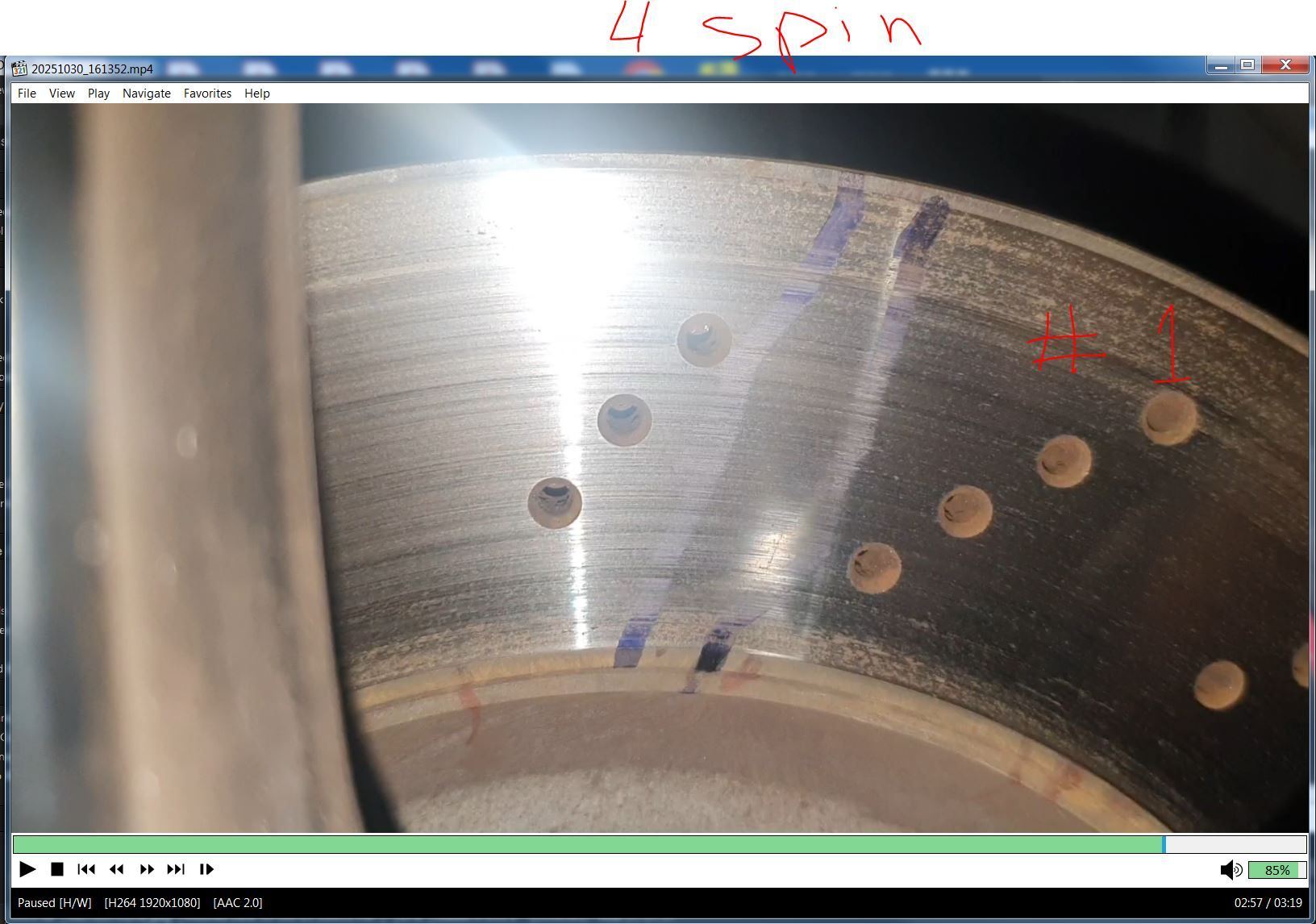

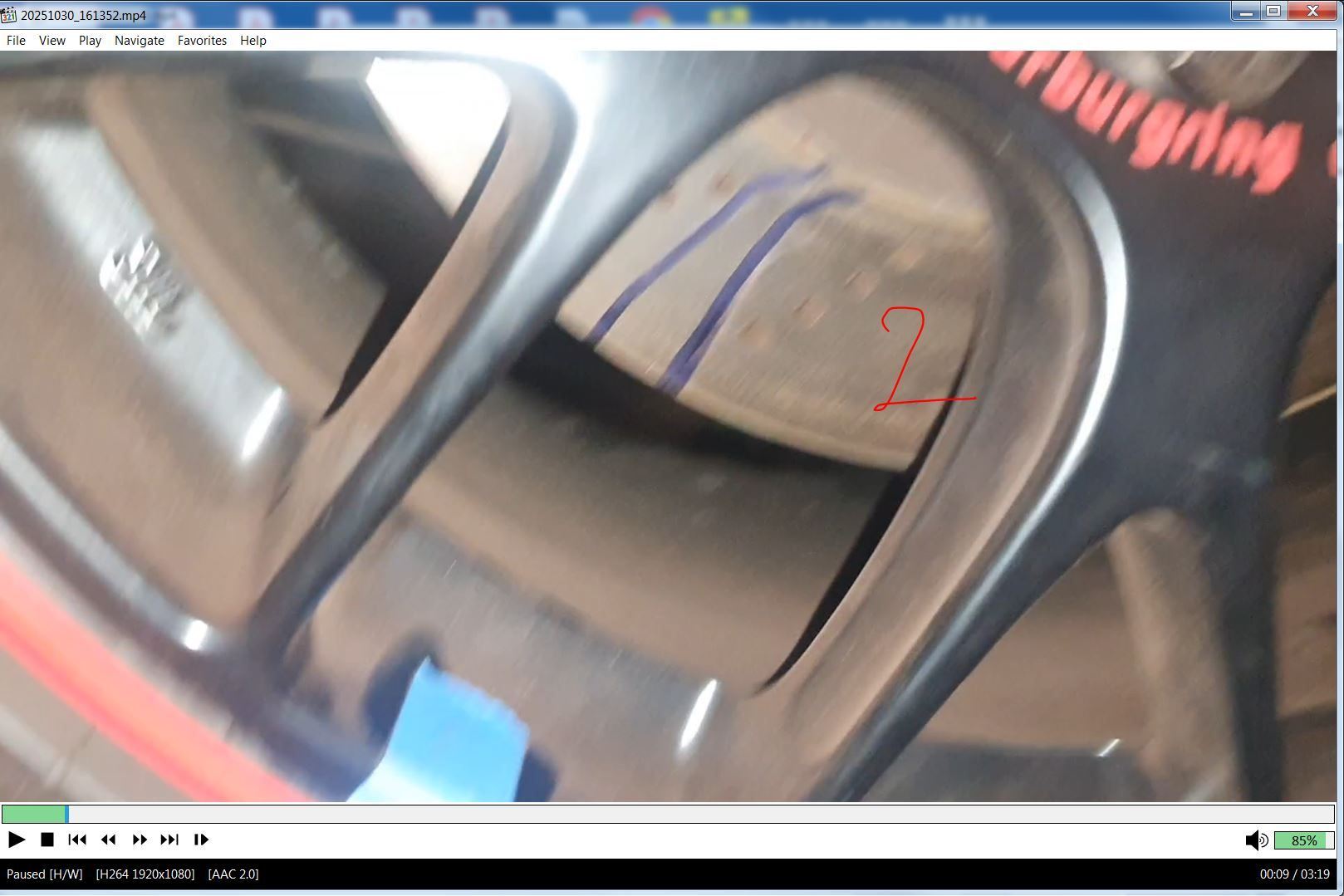

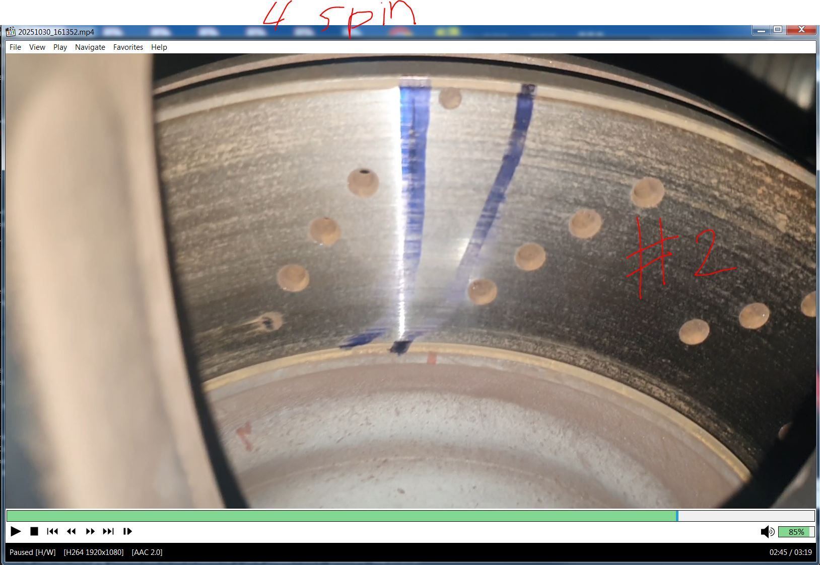

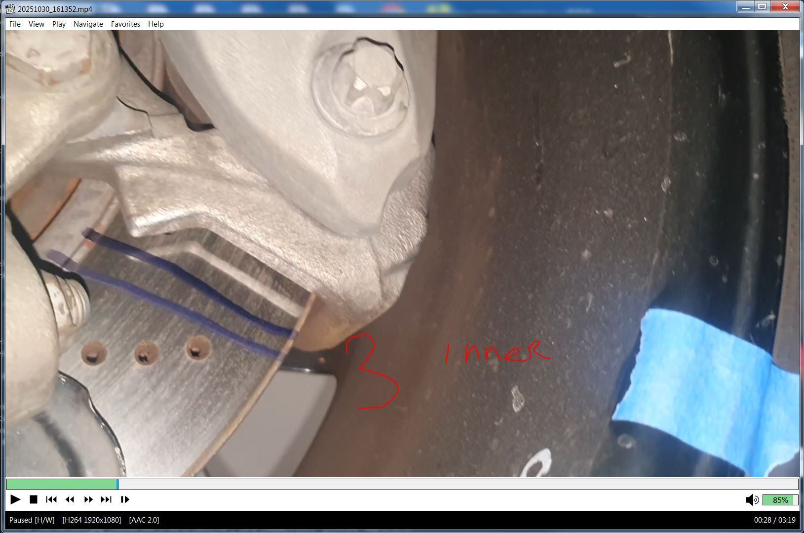

These are the "touching" test marks.
Two at outer and one at inner
When the marks exposed to the brake pad, 1 full spin only
The inner side is good. No touch.
2 full spin
The outer side is the touching ones. 4 full spin
Those with similar Brembo 4 pistons caliper package can fine tune your calipers this way and you will love zero touch.
