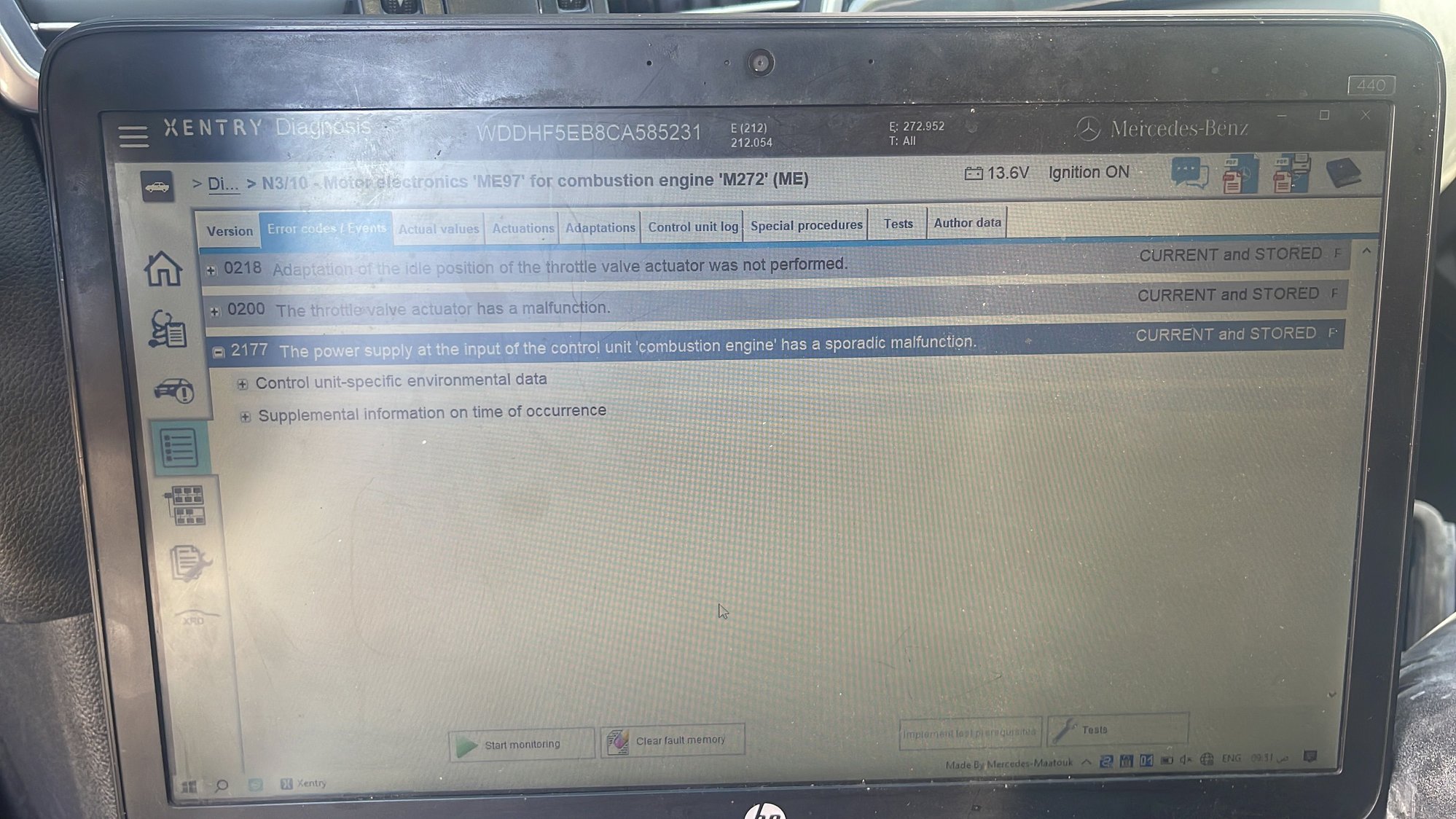

My friends, I have a Mercedes E300 and the
throttle body not working. I checked the wiring, replaced the engine control unit (ECU), and replaced the front fuse box, but nothing has helped. Has anyone else encountered this problem? Please help.

These are the computer malfunctions that appeared

check all wiring to the ECU, and make sure there’s no oil in the harness. Have you also checked all grounding points?
Looks like the ECU is not getting clean power

There is exactly a weakness in the electronic control unit.
I have already checked all the connections of the electronic unit visible in front of me on the engine.
