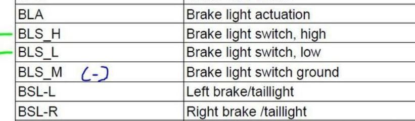

I am having an issue with my brake lights. They are on all the time when the car is running. The brake switch is new, just installed.
If i ground out pin 4 wire, the brake lights work as normal, but the ECS and traction lights come on.
If its normal the brake lights come on when I start the car, no brake lights if car if off, no warning lights on the dash, cruise control does not work, I can shift out of park if I step on the brake.
My Icarsoft V3 says the S9 ( brake pedal switch ) is active when I am not pressing the brake pedal.
This could be a wiring issue.
I used the car for a year with pin 4 grounded. Brake lights worked as normal, but I had error lights ESC and traction and cruise did not work.
I'd like to get this fixed but don't know where to start.

Its an odd switch. Not mechanical, there are 4 wires : 1) is 12 volts, 2) is ground 3 & 4 connect to the can bus. I think I know the problem, I think the ground is bad.
Somehow its suppose to be 2 switches in one. I'll find out tomorrow if the ground is good

Problem solved.
The switch had no ground. I connected a ground wire to the brown wire and everything is working, even the cruise control. Thank for the help. I do want to point out that the color code of my wires were completely off from the schematic that I found. A Black wire was suppose to be in pin 1 ( and 12 volts ) and it was in pin 3. It was very hard to tell if the pin 2 wire was indeed brown and suppose to be the ground. I ended up having to rely on a pic from another post to pick which one was suppose to be the ground. It worked. I got lucky. None of my wiring was the colors they should have been.

two thumbs up on your fixing this... as you point out with "cruise-Ctl":
you may now be back feeding GND through undersized wiring.
Now that you know what is wrong, fix the marginal GND source without bypass. Trace the circuit with diagram (regardless of mismatched colord).
By the time you reach footwell, you'll get rewarded with a handful of poor GND posts.
