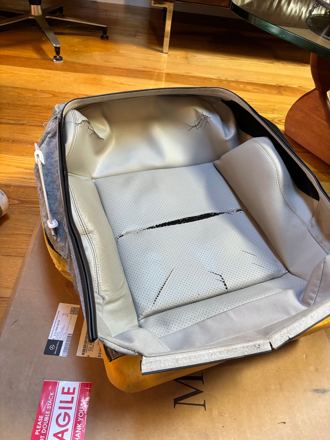

I just finished replacing the driver's seat cover for the center seam tear which is a known problem in our vehicles with MB Tex seating surfaces. The first time I experienced this problem was in 2017 but the my vehicle was covered by warranty under a PO's extended warranty coverage. It reared its head again this year with the warrantied seat cover splitting at the same location.

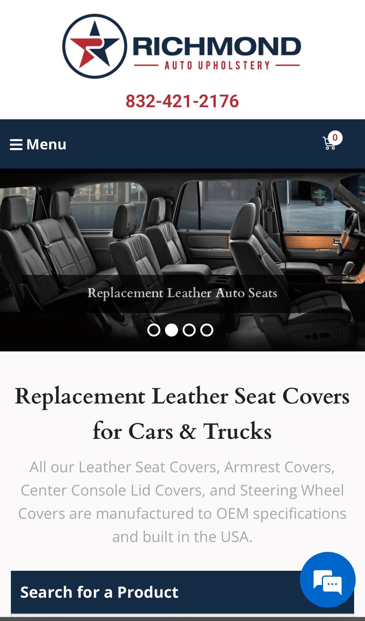

I did research online and saw several positive reviews of Richmond Auto Upholstery with vehicle owners ordering the leather seat cover in place of refitting the MB Tex for added durability. With the tear in my seat, my seat heating elements were also compromised and no longer working so I had to order the seat heating side and center elements from an online MB dealer.
All in the total for the leather cover and oem heating elements were @$600. I was able to do the repair myself and was very happy with the fit and finish of the replacement leather seat cover and wouldn't hesitate recommending Richmond Auto Upholstery for any members dealing with this problem.
Removing the damaged cover.

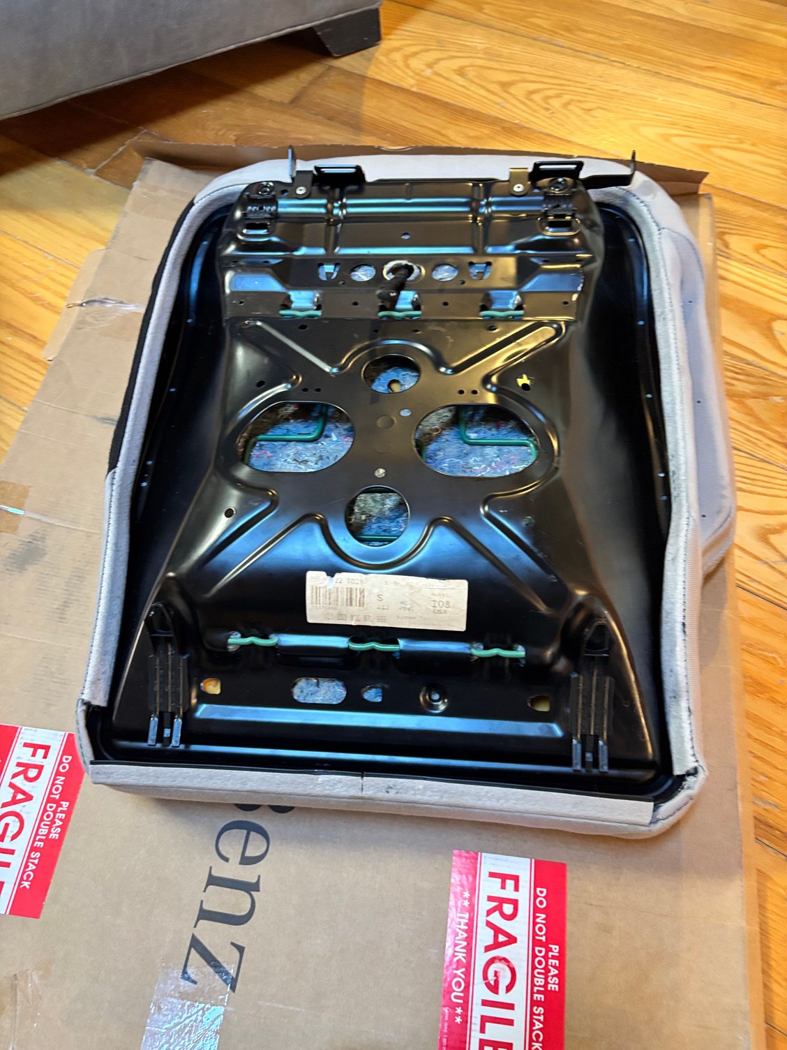

Process of removing the retaining clips from the seat shell.

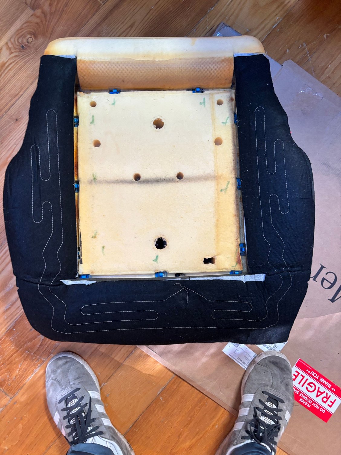

Installing the side seat heater element to the seat cushion.  The center heating element is enclosed in a pocket in the seat cover itself.

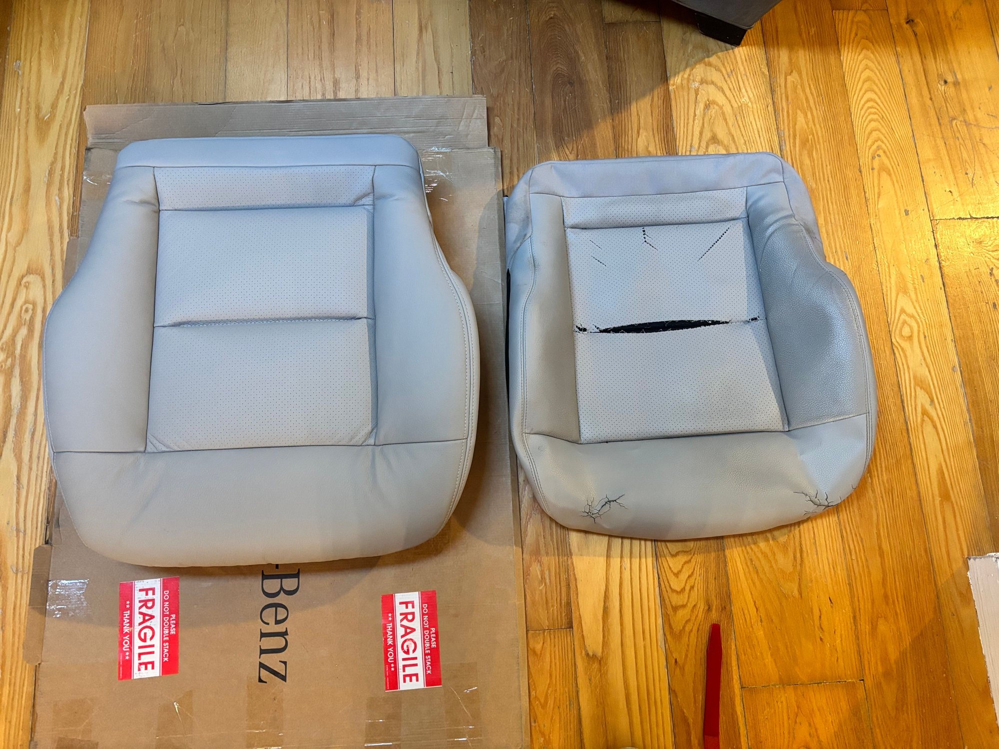

Side by side comparison of the leather seat cover on the left and the oem MB Tex.  Color match is spot on.
Contact info? Happenstance, I need the the same thing in the same color....
Old Nov 12, 2025 | 07:50 PM
Raj1471's Avatar
Joined: Sep 2019
Posts: 266
Likes: 305
2011 Mercedes E350 4Matic Wagon
Here ya' go...
