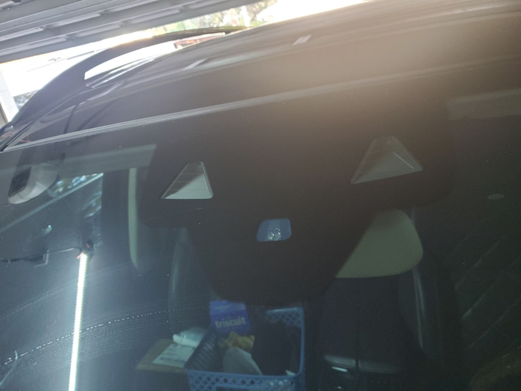

For those of us with out full access...or want to know on the fly if a car has Distronic...look near the rear view mirror from the outside of the car....if there is one "triangle" area you do not, if there are two you probably do.

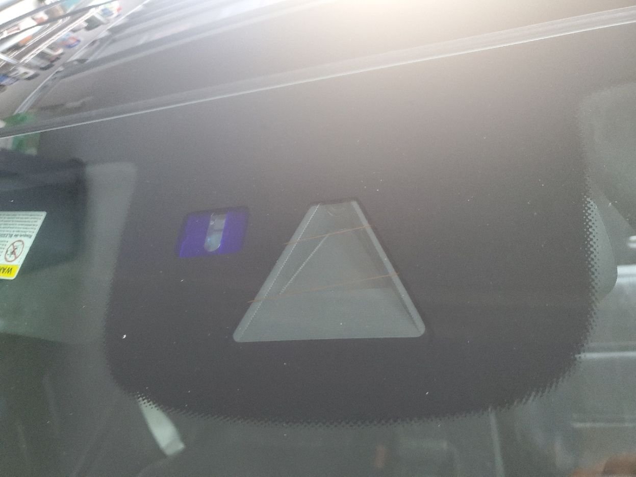

Just checked, my car has only 1 triangle...

@TimC300 or...simply look at the windsheild for TWO triangles as in my second image (our GLS)
There is your answer 😀

So, on my car with one triangle...I do have accident prevention, lane assist and some basic features. The car with two has the auto speed control (as part of cruise control). It will pretty much drive itself...it was an option in both cars (the car with one is an E63S). My other cars have one....if I am not mistaken, the lens looking things are for the wiper blade system. I very well could be wrong.
The other place to look is the center of the grill. Our cars with auto cruise control have large sensors (behind the Merdedes Star) in the grill.
Science tells us that two of the lenses/sensors are needed to triangulate distances and speed. The bumper sensors are for close range and parking stuff.
Old Nov 16, 2025 | 09:11 PM
OldManAndHisCar's Avatar
Joined: Jun 2021
Posts: 3,110
Likes: 1,346
From: Fleriduh
W212 E63S Wagon - GSL580 - E63 - E350 - C300
No distronic
With distronic
