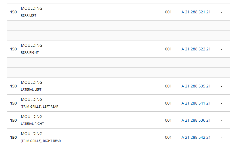

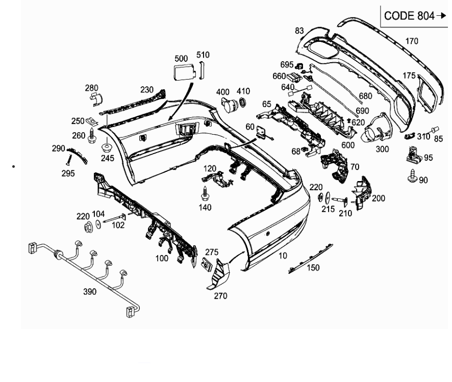

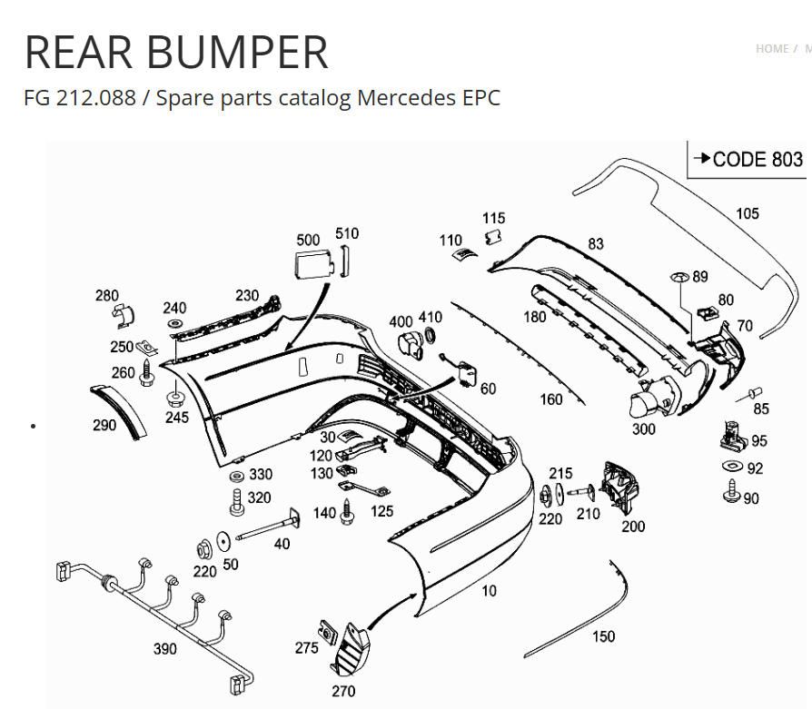

You have the 212.088
Parts diagrams shows two bumpers and not sure which one you have. It doesnt list 803 or 804 on your build sheet.
Which specific parts are you looking for? I looked up the part# you listed and do not see it on the parts diagrams, there are different part #'s. Part 150?

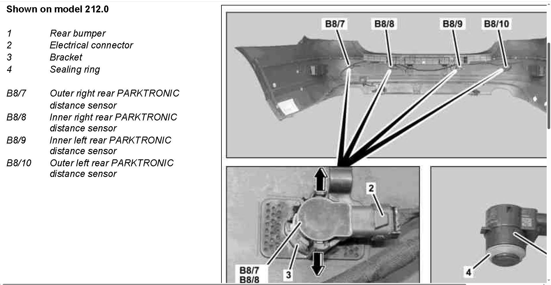

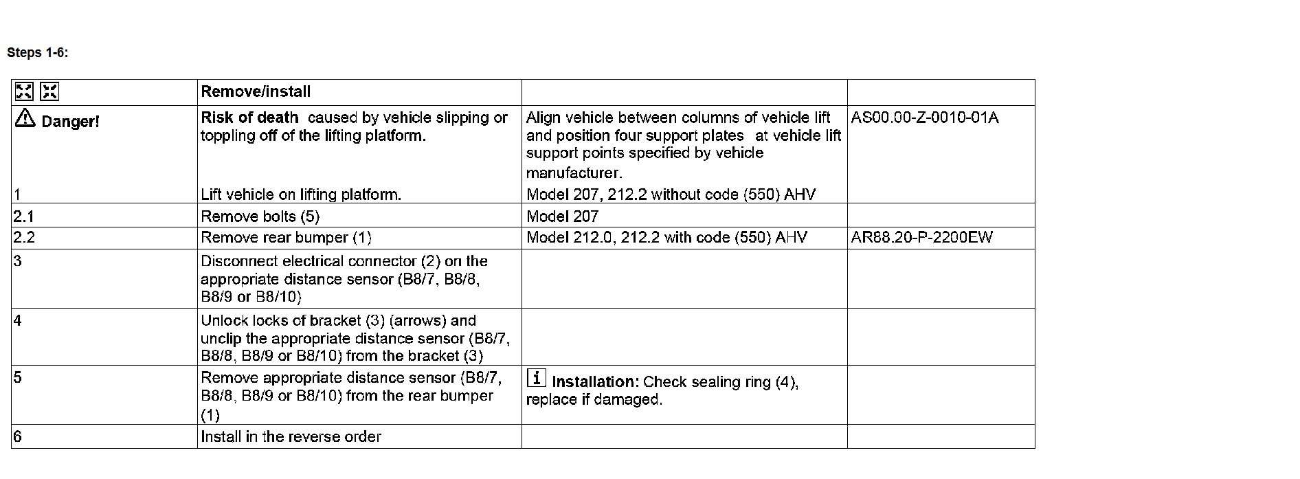

I have the sport model which looks like the 2nd assembly diagram. Item 170 looks like the part I am looking for. It's a single chrome/plastic trim piece that goes across the rear lower bumper. If you can find item 170 P/N that is probably going to be what I am looking for. I wish I could access this file. Do I have to access the download option? I am always fearful of using them as it usually ends up getting more garbage on the system.
The view of the sensor is great. This will help to replace it.

Looks like the 4321 # is listed.
If unsure you can search around on ebay for what it looks like. From the photos the part# is stamped on the back side if you can remove and check on yours.
