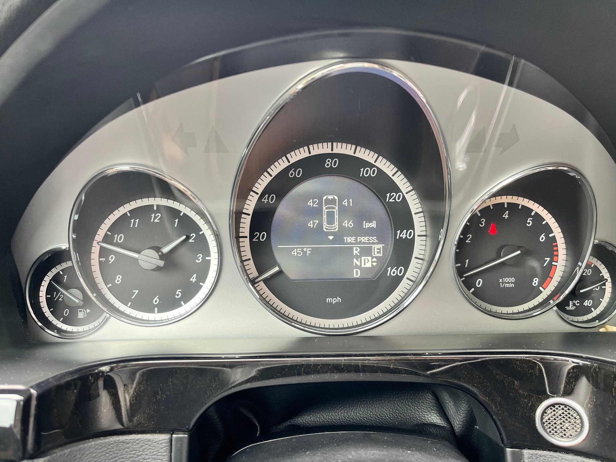

I’ve got a 2011 Mercedes-Benz E350 4MATIC wagon with 257k miles. About 90% of the time, I get a “Tire Pressure Monitor Inoperative” warning at startup, but around 10% of the time there’s no warning and the tire pressures read perfectly. Even when the warning appears, the system still shows correct readings if a tire goes flat.

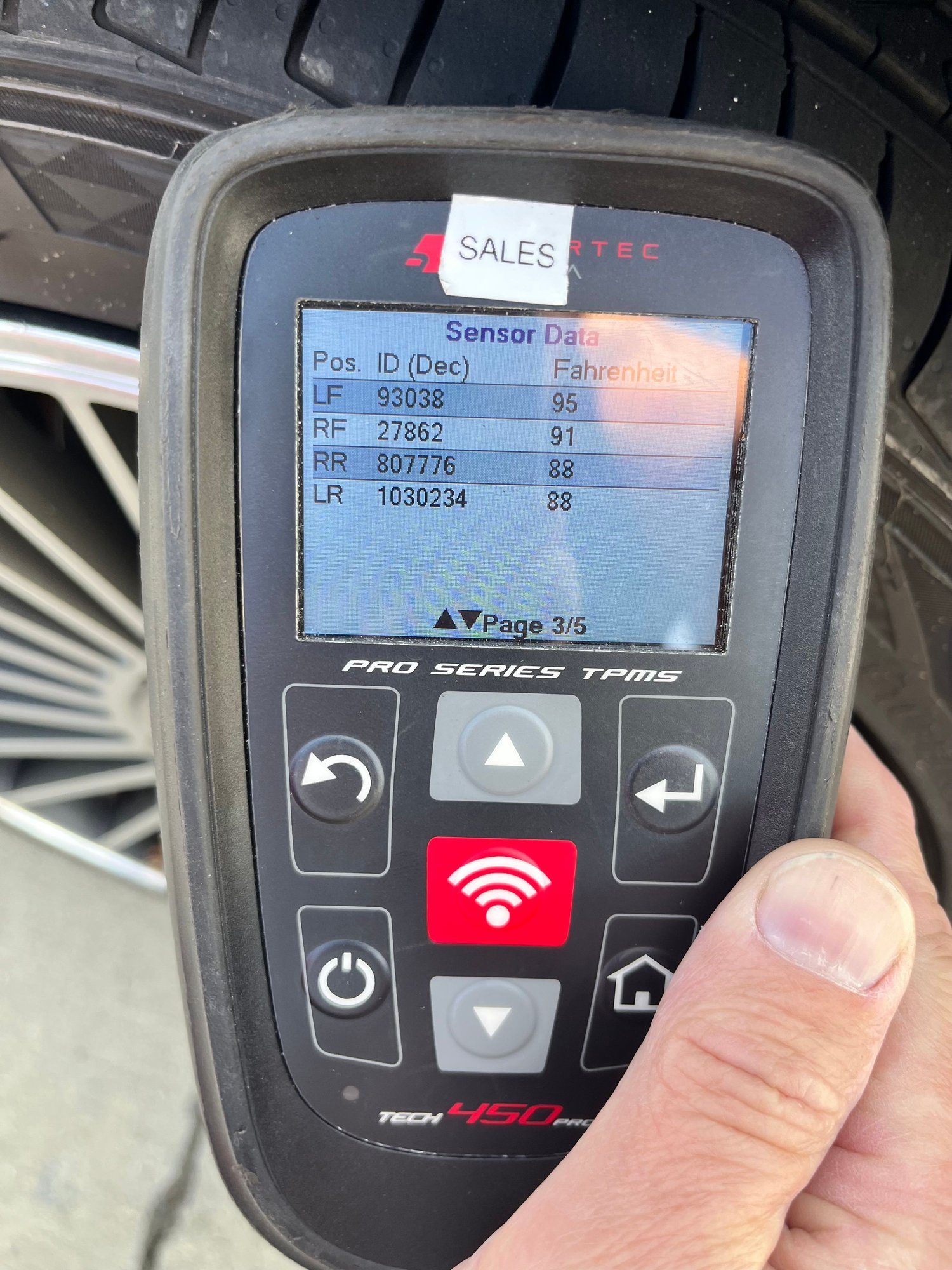

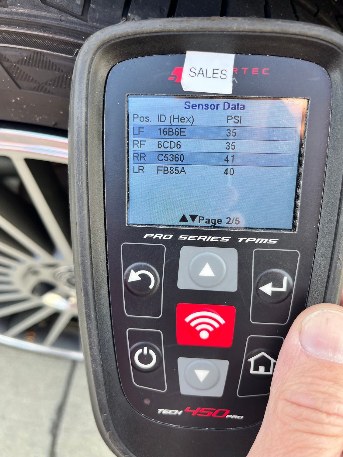

I’ve confirmed with Discount Tire that all sensors (three Schrader 433 MHz from them and one OE sensor) have good batteries and are properly registered to the module. All are the same brand, all reading correctly, but I still get this annoying inoperative warning. Any ideas if I need to re-register them with XENTRY or if there’s another fix?

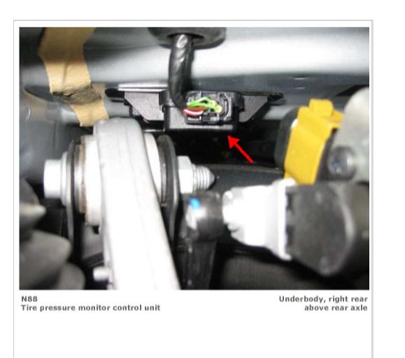

-- Use your OBDII scanner to interact with your TPMS module across the car CAN-B network. See what data it is exposing or not. It is located in the wet area over the axle near gas fill door.

TPMS is a well built module with a gold plated circuit board - However it is connected with a leaky harness connector that can swamp it with water.

Thank you so much for your quick and concise reply! I’ll get with my technician at the dealership to have my vehicle plugged in to Xentry to see what CAN – B issues I can find. I’m assuming that I can get to the module by removing the passenger side, rear fender liner, correct?
Thanks again!

To remove TPMS remove the rear passenger side wheel only. There is extremely little room to work screws out
The TPMS module is not very user friendly to remove ie. be sure you have good reasons to removed it...
