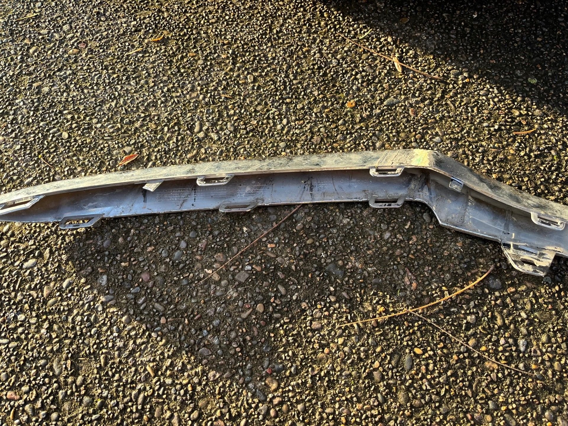

Hit a piece of concrete dropped by another driver, and the front bumper molding was dragged off.
When I try to put it back, there's quite some resistance.
Should I just force it on?
The guy in YouTube video below made it looks like it should just pop right in, but it's not happening on mine.
I don't want to end up in a situation where the piece is stuck half-way and being loose.

Have to inspect the tabs on the bumper. The tabs on the trim look fine in your photos.

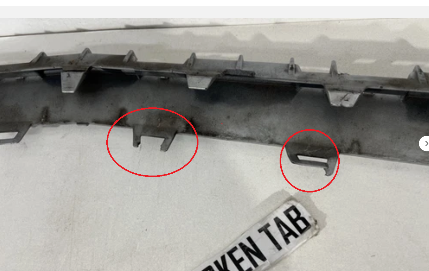

The bumper tabs may have some damage like the photo below.

Thanks & good point; will take a closer look at the bumper tabs when weather clears up

I would apply some clear silicone (RTV) to several of the tabs. This will add some additional grip in case some of the tabs are not as tight as installed originally.
