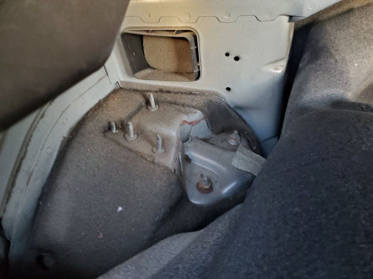

But you must remove your trunk liner to access the two bolts for top mount.

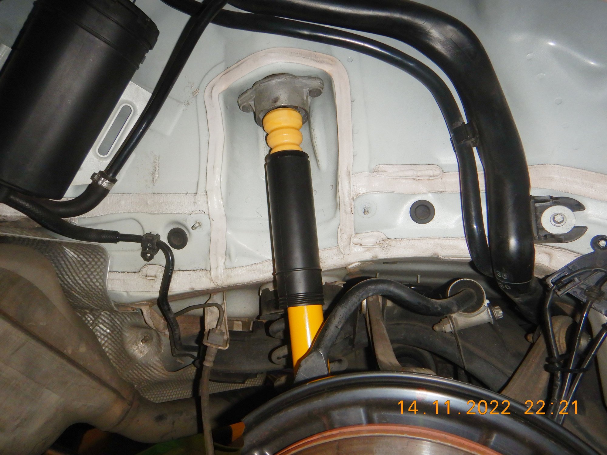

I hope you get the bump stop with the damper.
New Kayaba bump stop and boot for rear damper. This is Bilstein B6. Now I am back on B4.
My original MB bump stop in red, the short yellow is unknown el-cheapo bump stop I got locally, very bad ones.

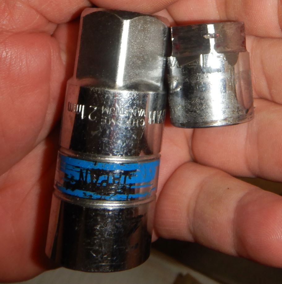

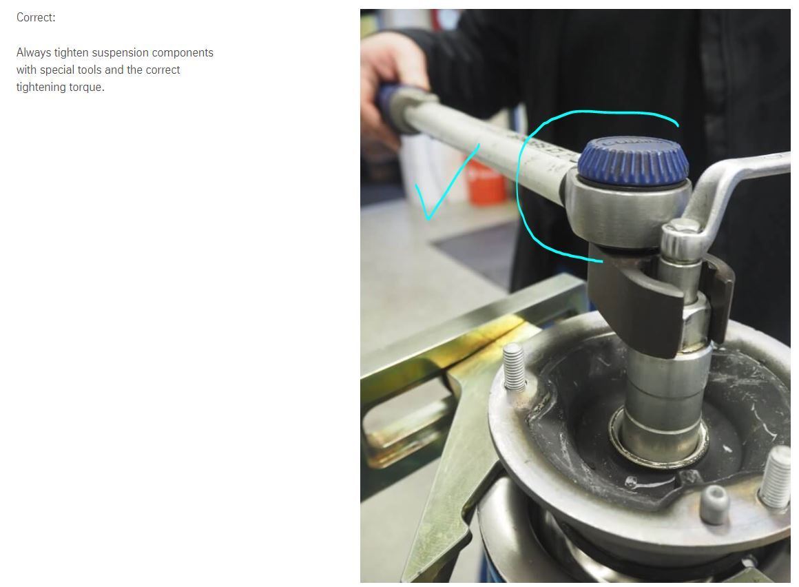

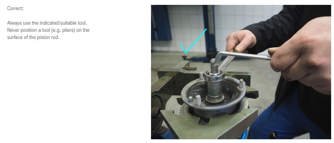

Your must also have the proper tool :
The damper piston nut needs the special hex tool so that the middle of it you can insert the allan tool if not Torx. Bilstein uses Allan tool
Something like this : https://www.toptul.com/en/product-54...-Tool-Kit.html
I DIY one for rear and one for the front based on the same concept.
Bilstein B4 for the rear
Bilstein uses M17 hex nut. I don't know the original SACHS on my car, what nut size it uses, because it was my indie who first installed the Bilstein B4 and removed the SACHS.
Front and rear damper nut "special" tools. M21 is for front, it is a spark plug socket.

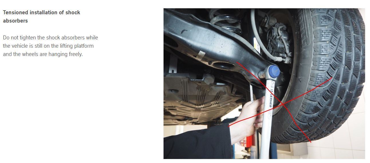

Here is from Bilstein
Yes, all my damper are properly torqued to MB spec.

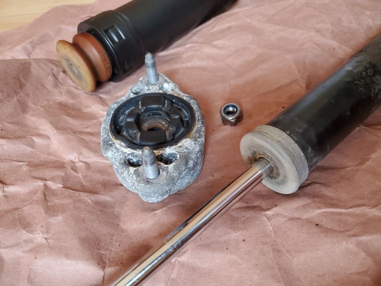

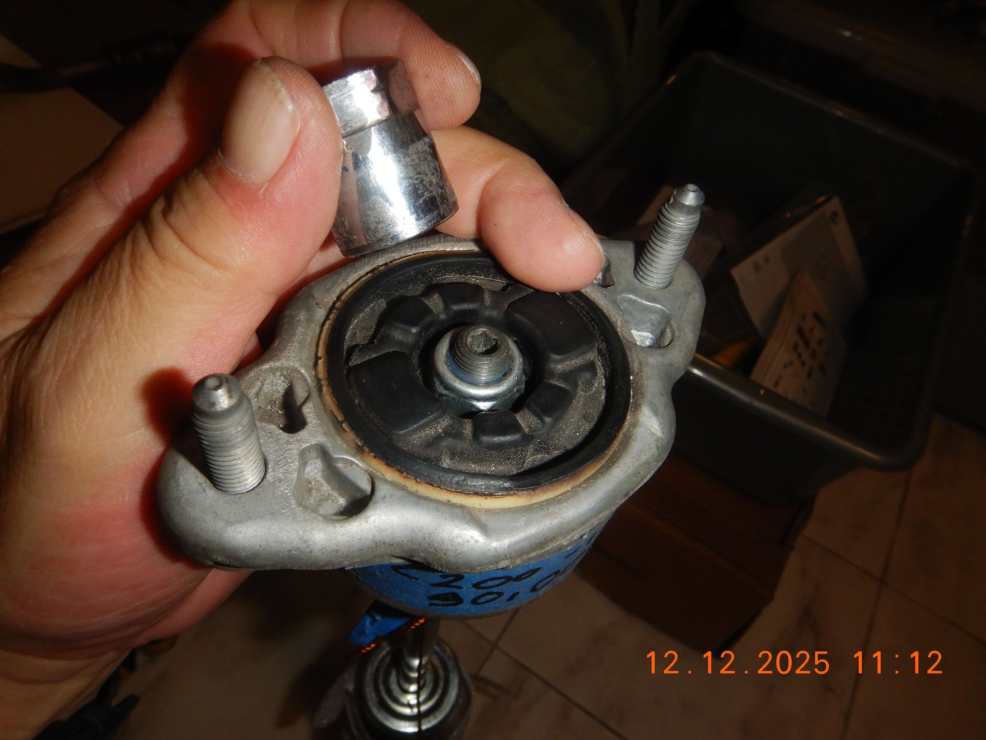

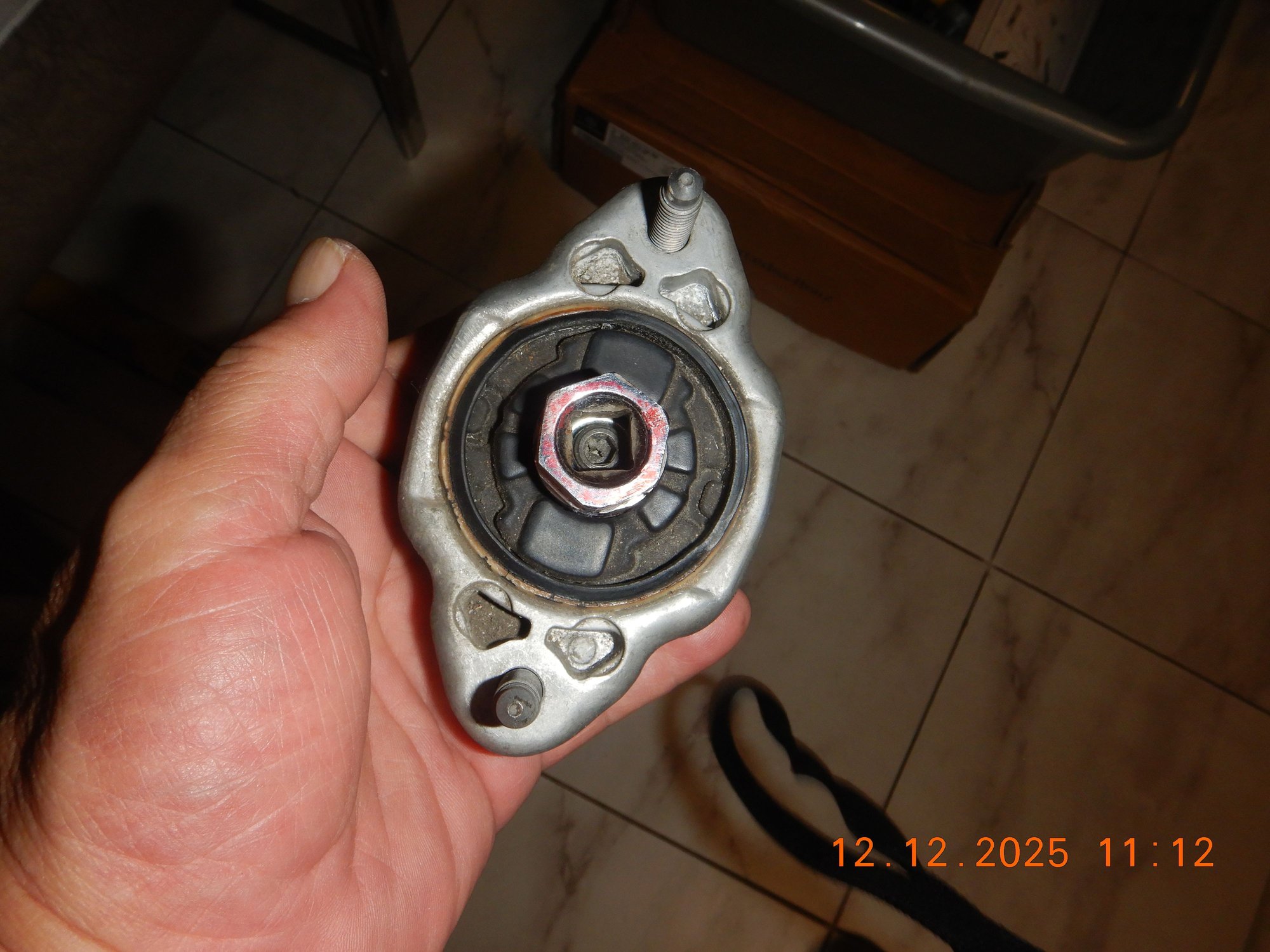

Rear damper top mount if original MB, they do not sell stand alone.
They sell complete with damper.

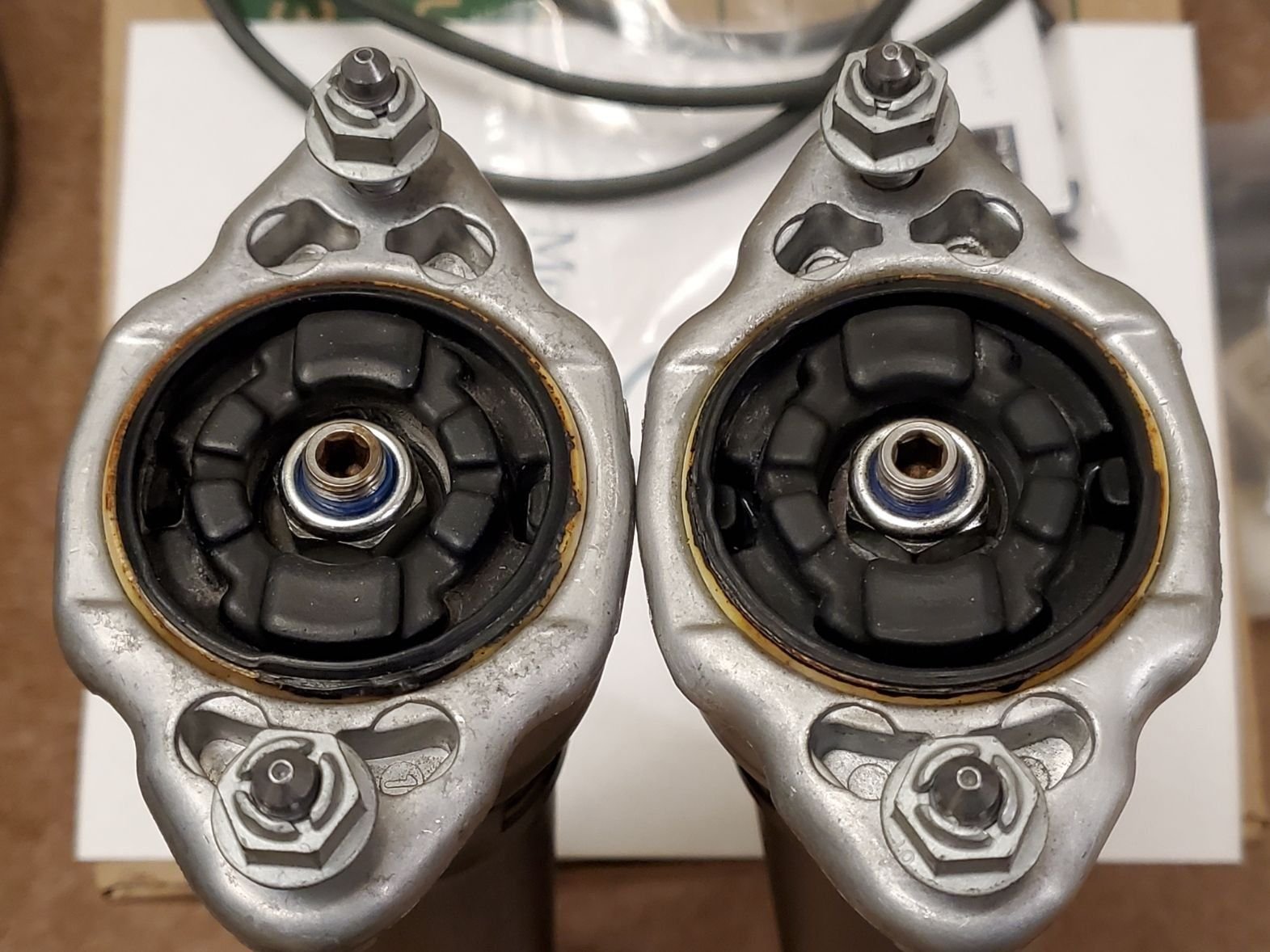

I have issue with rear damper top mount made by Lemforder./SACHS.
If you can get a machine shop to make it flat and proper, get the Lemforder/SACHS one, as you got no choice.
Full details : https://mbworld.org/forums/e-class-w...bage-fake.html
Quick look. This part is what I meant for you to MAKE IT FLAT AND PROPER
Have fun....

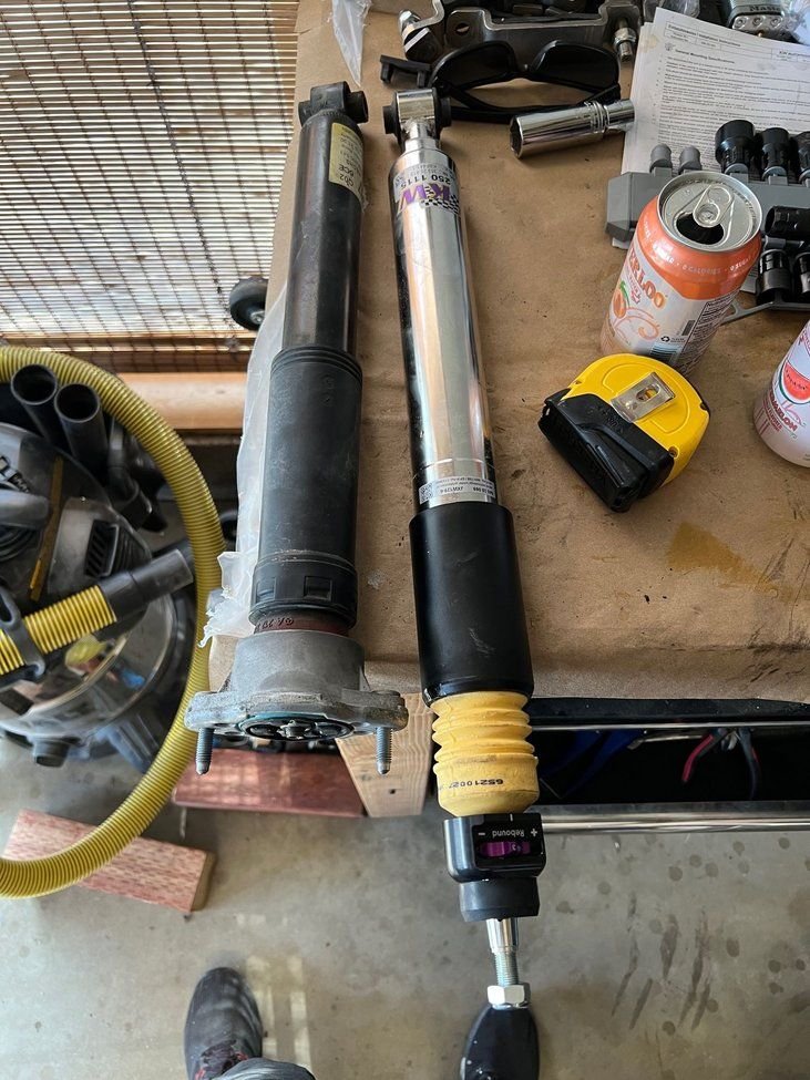

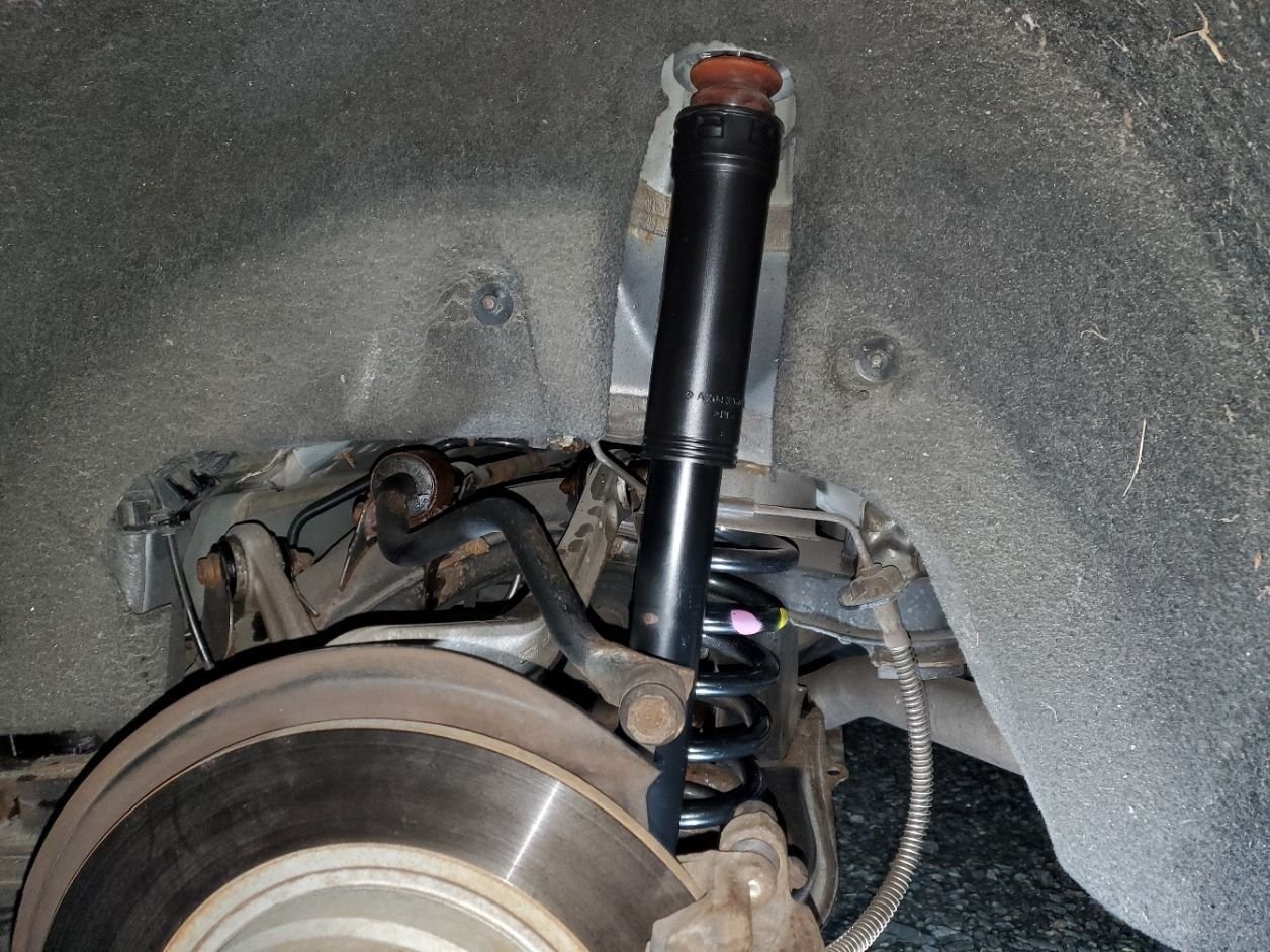

I put a set of Bilstein B6 shocks int he rear, and couldnt be happier. Wagon shocks are several inches shorter than those for a sedan or coupe.
Stock wagon rear shocks compared to KW V3s for a sedan:
Couple things to think about. You have to take the trunk carpet/trim out of he back to access the nuts on the top of the shock mount. Not a big deal, but takes a few minutes. Once you get everything out I highly recommend replacing the upper mount as those can wear out and get a little sloppy. While they are technically not available for the e350, you can order replacements for other models that fit.

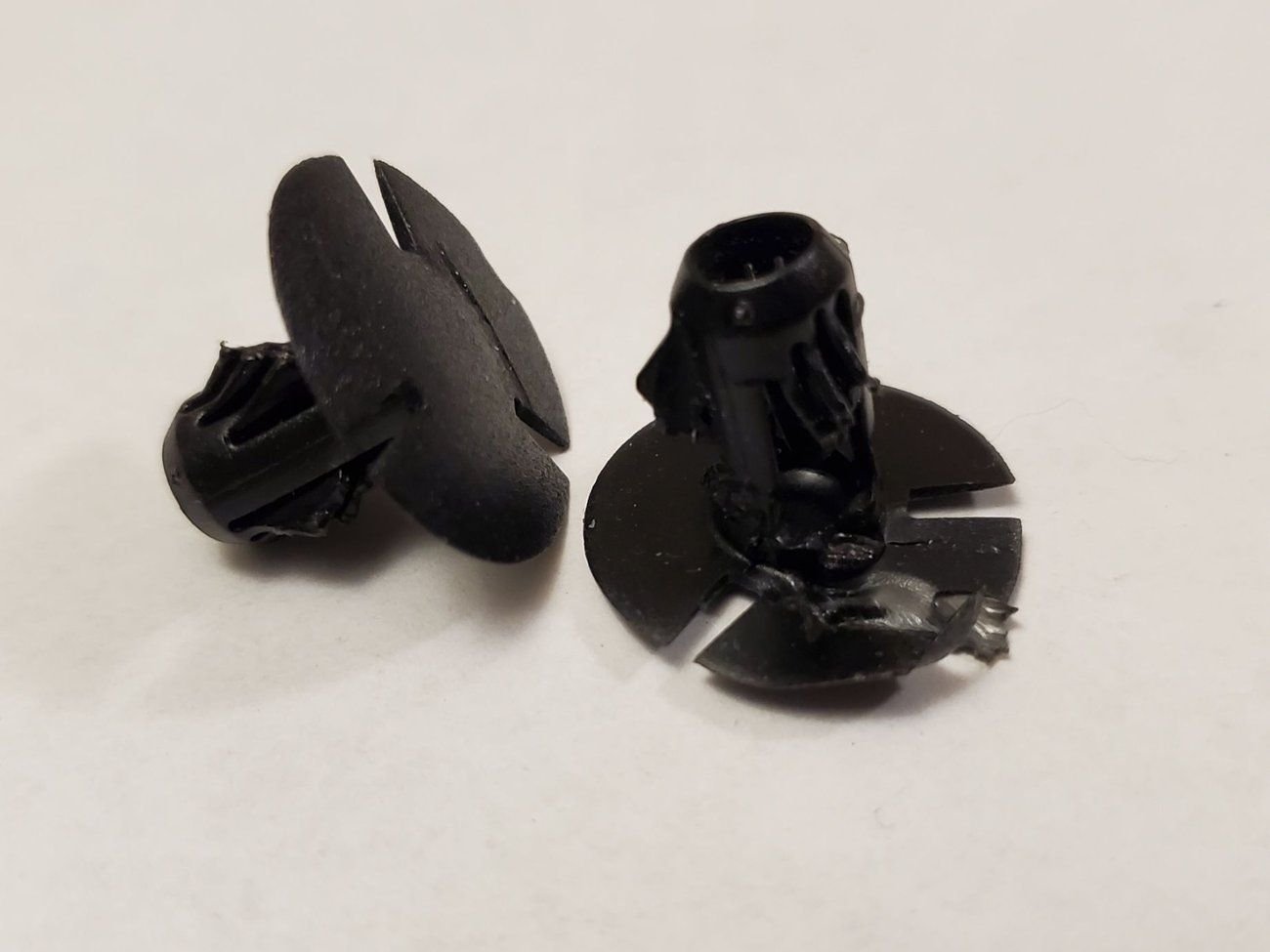

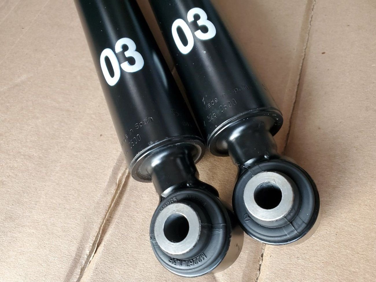

I replaced my W204 rear shocks last year. Old ones looked rusty and beat, car had around 150,000 miles. I found a used set on ebay with 40,000 miles for less than $100.
Install was pretty easy. To pull the carpet away in the trunk I ended up destroying the plastic fasteners so glad i had bought new ones to use.

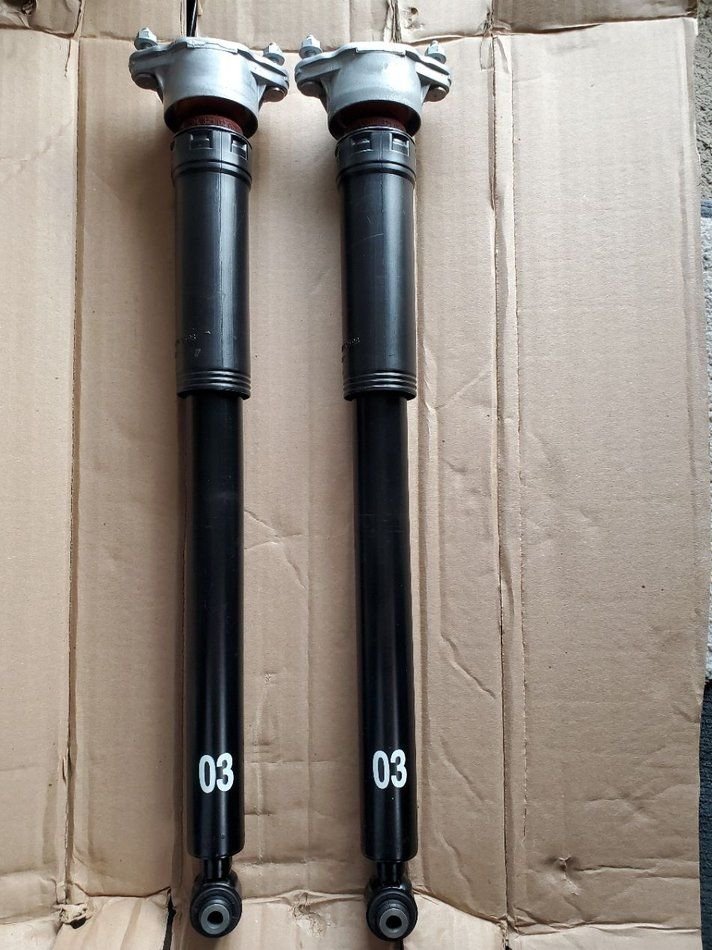

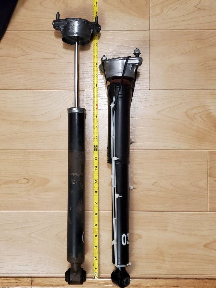

To compress the old shock for removal I used a pry bar which made it easier. Once installed i lowered the car down on my wooden ramps to crawl under to torque everything.

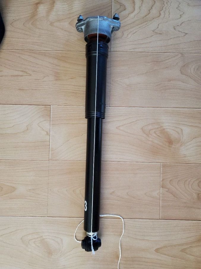

Since the replacement shocks came extended I played around with compressing them. One I used string the other I used a bunch of zip ties.

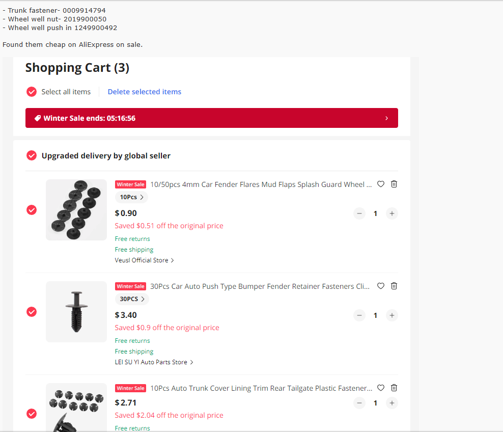

I noticed I couldnt find a new Mercedes bellows for the shocks, guess its discontinued. So I removed the bellows on the old shocks, cleaned them up and sold them on ebay for a few bucks. Zipped the nut off easily with an impact wrench.
Heres the fasteners i bought. Not sure if they are the same for W212.
