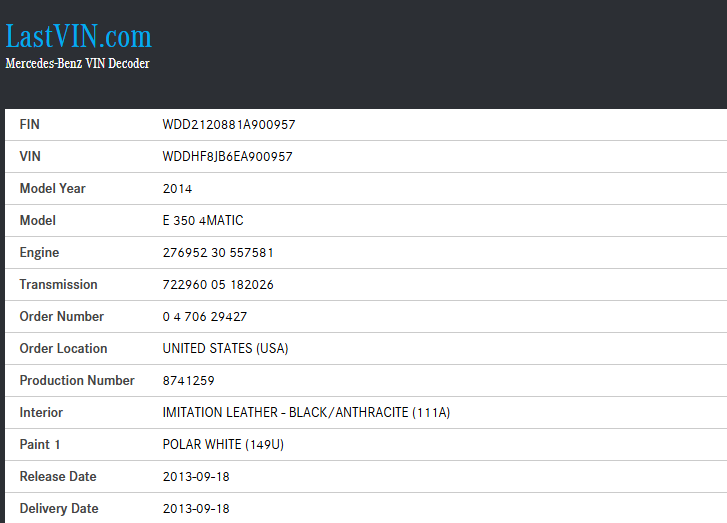

You seem to have the 212.088
276.952 engine.

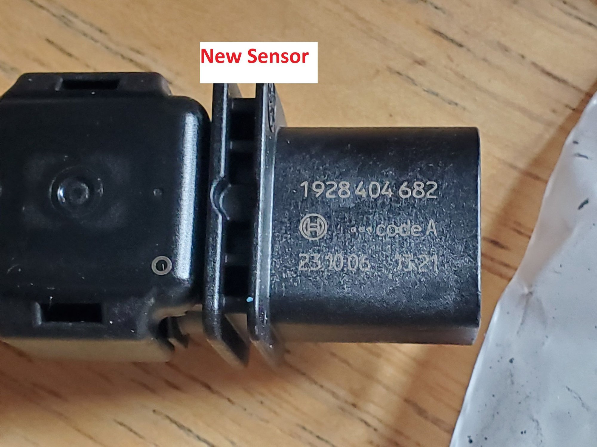

There are a few part #'s for the sensors. It is the same case for my w204 where they list a few different sensors. When I replaced my passenger side sensors I unplugged them and took photos of the plugs then matched up the correct Bosch plugs.
Heres an example of what one of my sensor plugs had for a part#.

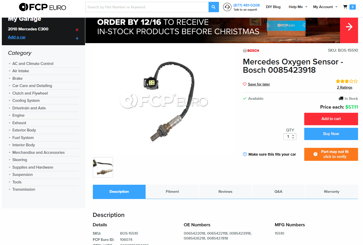

Did you confirm FCP sent the correct part #'s?
Im confused when you say you bought the 15510 and they dont fit but then you say the shop wrote down that 15510 to get?

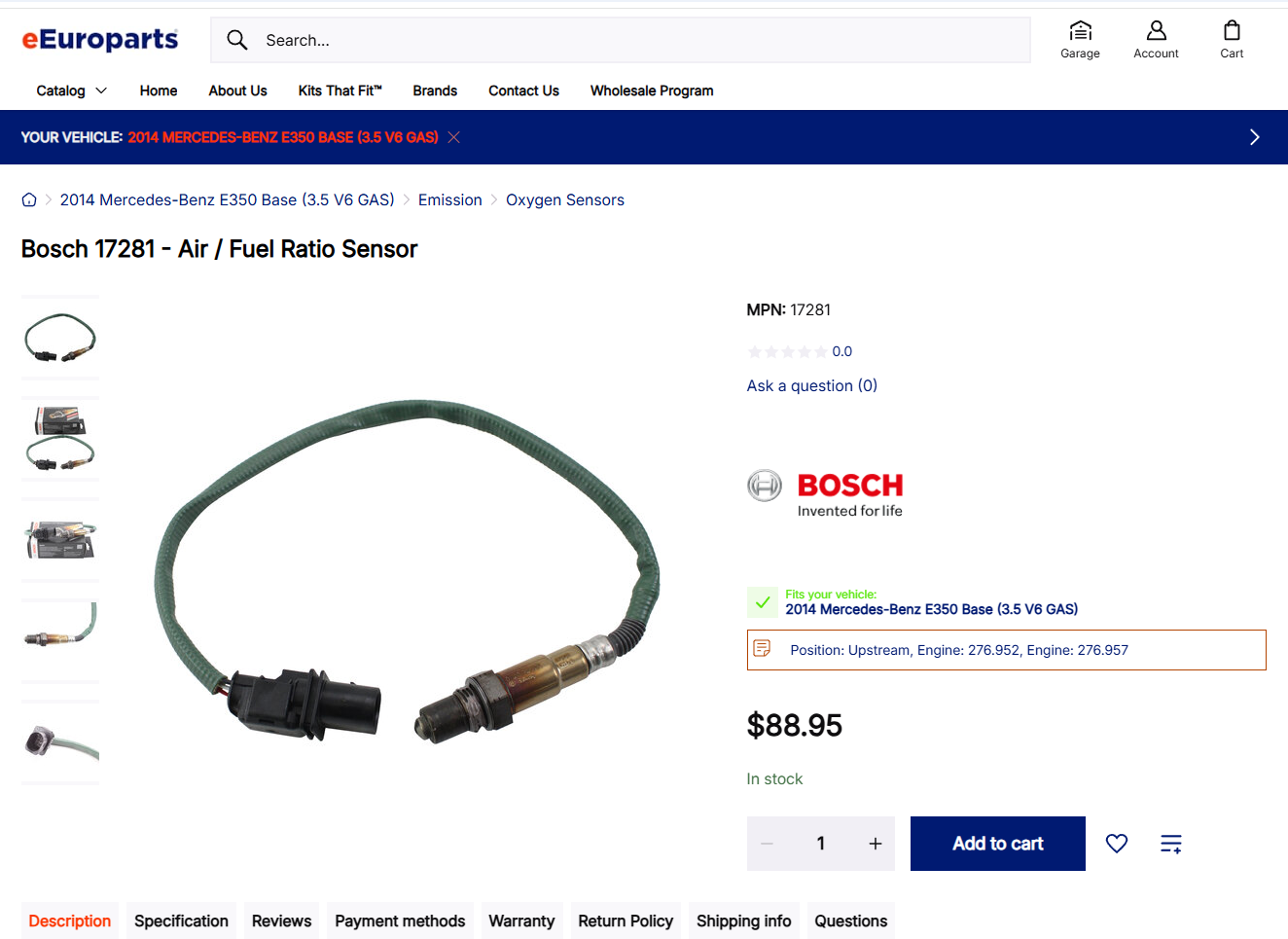

Heres what I come up with for the sensors, though could be totally wrong.
Upstream sensors- Genuine MB are same price:
Downstream sensor:

Yeah, I was thinking the guy was just kinda pissed off on the phone and just like "it's all wrong everything's wrong and it all sucks!!!" I'm pretty sure the downstream ones are correct. Looking around I had thought the 17281 would be correct, thank you for confirming it. He did specifically say the sensor I supplied, the pigtail was about 10" too short and it looks like 17281 in the picture has a much longer pigtail.
Yes, FCP did send what I ordered. I just ordered the wrong ones.
They are the same left and right, correct? So I would need two 17281 and two 15510?

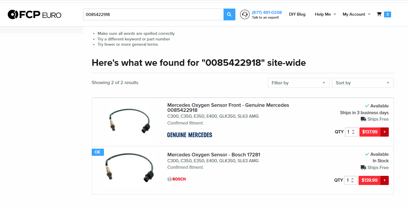

If I were you I would contact FCP Monday and give them your vin and have them tell you. Plus set up a return for the other sensors.

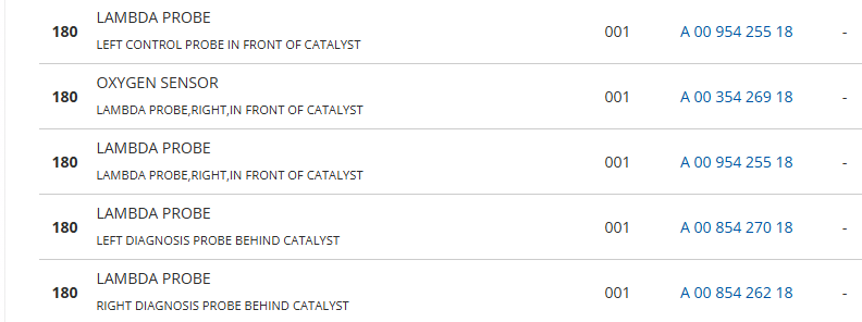

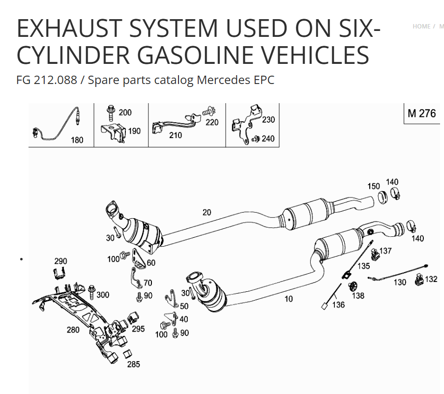

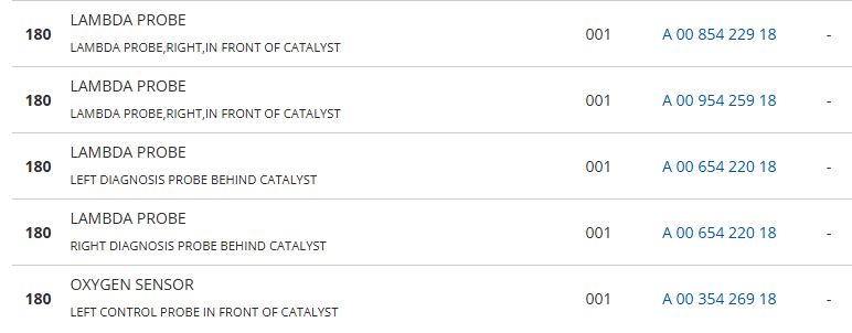

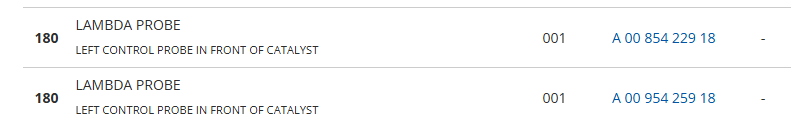

Here..........
Always rely on proper EPC which can link to car VIN...............

Thank you! What is code 920 and K01?
This is now the third different part number I have been given for the upstream sensors and the second for the downstream. At this point I am going to buy over $1000 in O2 sensors, let him take it apart, and return what he doesn't use.

K01 is some sort of heat shield
its a minus -920 not +920 -----> meaning NOT SUITABLE for the special stratified direct injection which your engine is not.
If your datacard shows 920 code, you then can not use them Part Numbers.
Positive 920
  • 920- GASOLINE DIRECT INJECTION WITH STRATIFIED CHARGE (DES)

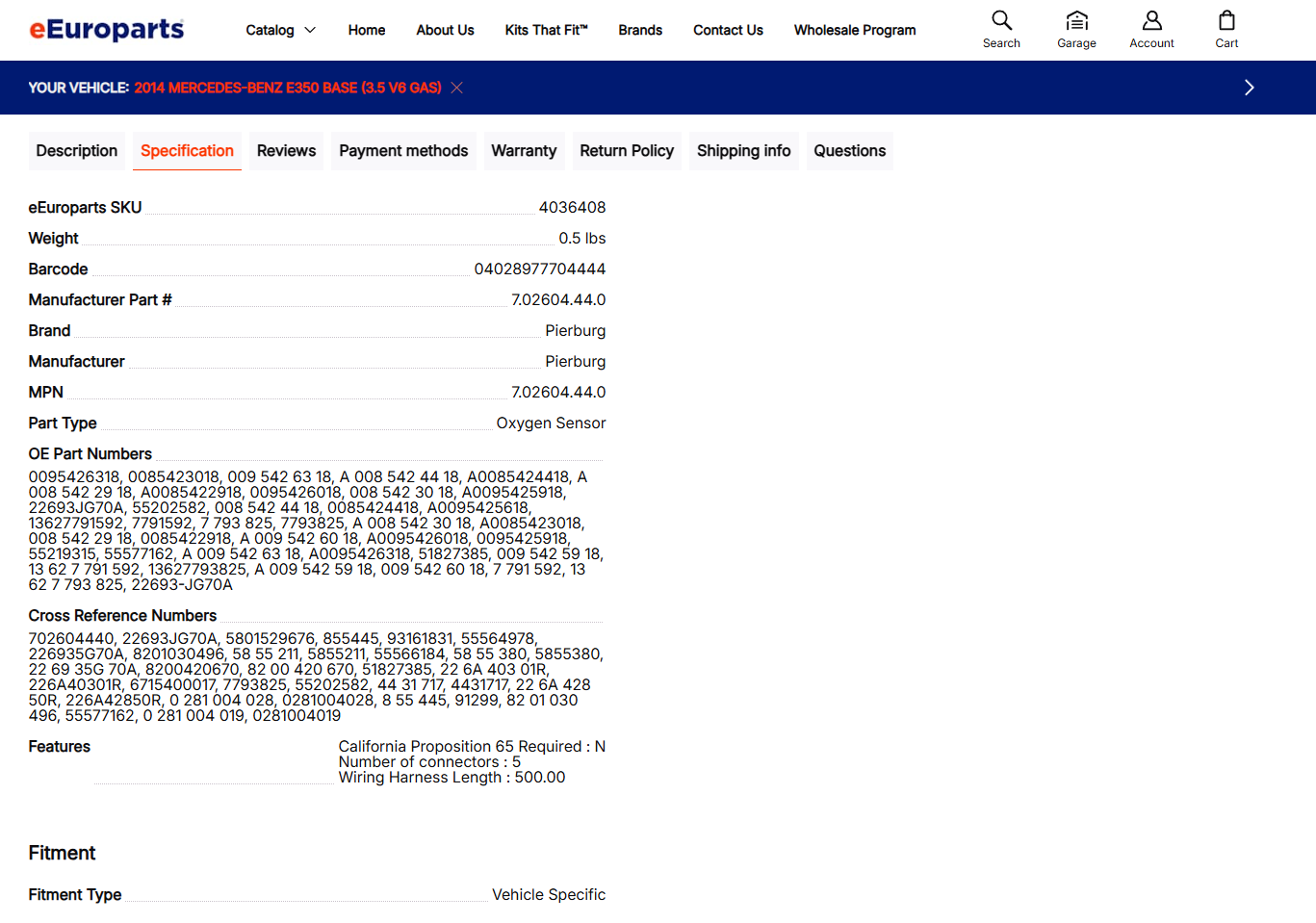

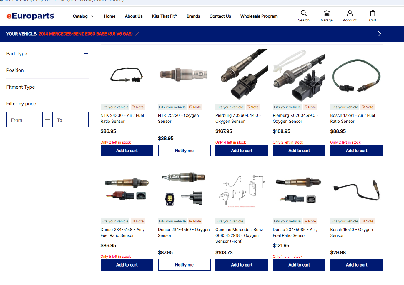

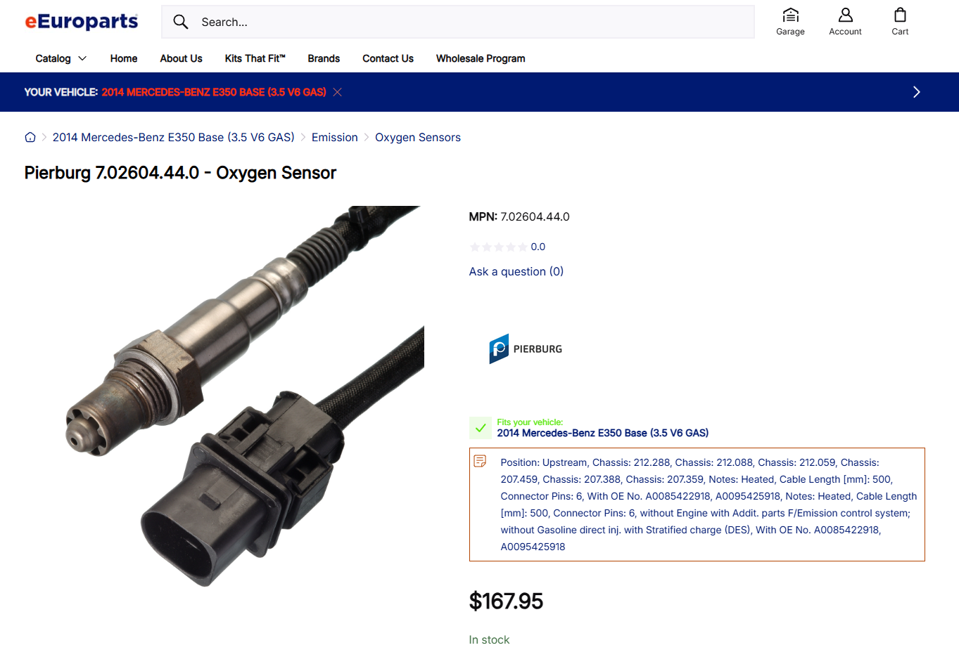

I was looking around on eEuroparts and they sell the sensors much cheaper, for some anyways. They also include some additional notes which may be useful. FCP really makes you pay for the lifetime warranty.
