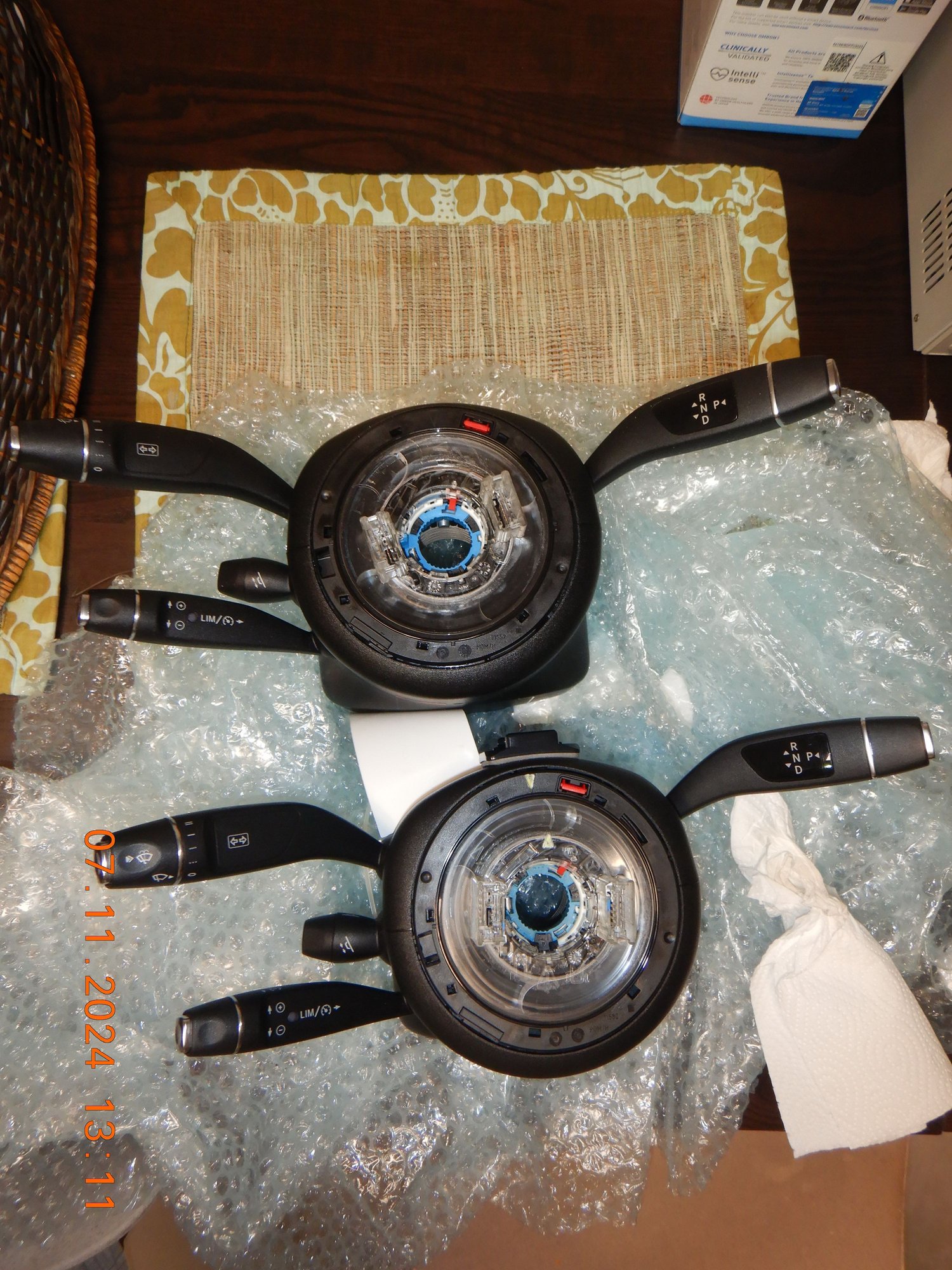

Signal light capability GONE and ignition key reset restored it, I got the same issue, but need 4 hours or more long drive for it to act up.
MB Indonesia wanted US$1,500 for the steering columnN80 set and no stock and no availability dates...
I ended up sourcing used on in Ebay Europe. All good so far and I tested already 9 hours non stop drive ( engine running ), once.
Newer cars , more so German cars , will have more electronics, we can't escape this fact. No more simple cars like the 80s.

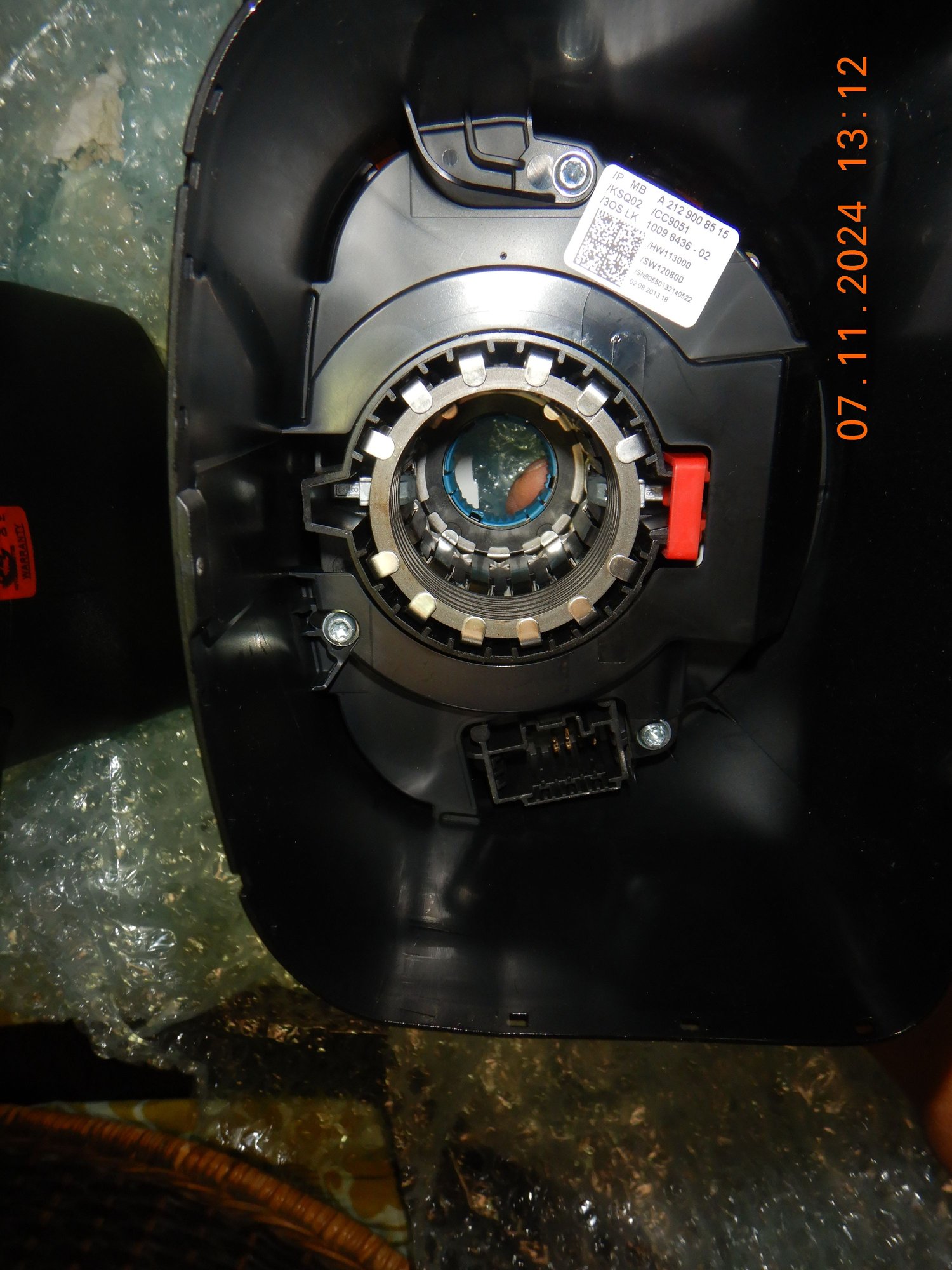

Here is the Turn Signal DTC. It is called N80. N80 controls a lot of things, so your other issues could be also due to N80.
The N80, there are many many types. BECAREFUL when buying one used. Use VIN check and see the original sticker on the N80 on the car for N80 model number, software number and all
Bottom is my original N80, top one pre-owned from Ebay Europe seller.
Good luck on the replacement.
