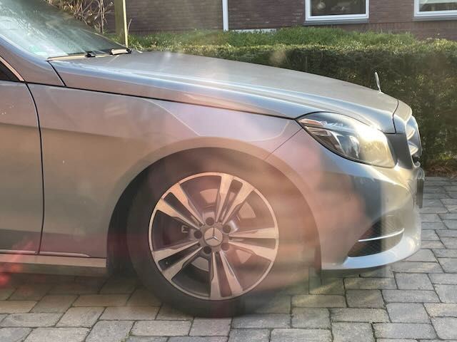

Here's a picture of a typical morning front stance of the car, all sporty and lowered suspension
