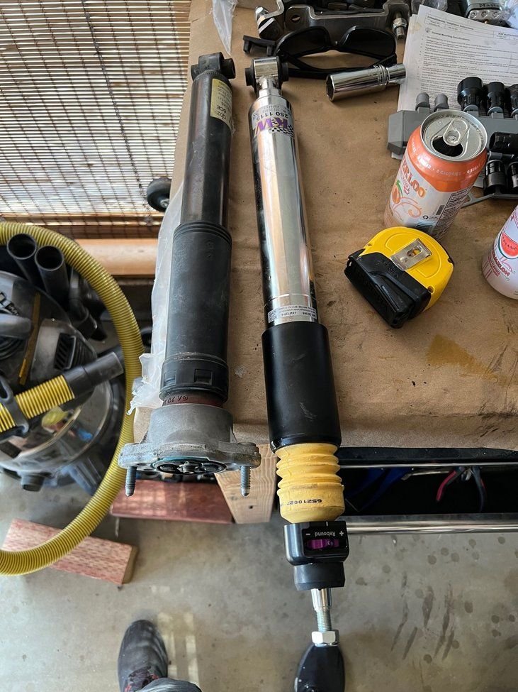

  • Front drop: How many mm have people run? - I would imagine you need two plus inches down, maybe more. Being that you are a wagon, you have less options than the sedan guys. Any 4Matic sedan coilover will work up front, I am running the KW V3s, which are probably overkill, but I got a deal I couldn't pass up. https://www.kwsuspensions.com/produc...-35225069.html
  • Rear drop (with air): Any recommendations for ride height front vs. back? I am running ghost lowering links, any brand will do since they just trick the system into lowering itself. Harder part here is shocks. Only real options are direct replacments, since the sedan shocks are several inches longer than the wagons. Only real "performance": or heavy duty option would be Bilstein B6 BIL-24-191128 (thats what I am sunning and couldnt be happier). Youll need to also buy a new upper mount and bumpstop, which they technically dont sell for 350 wagon, but here is a part number that works.

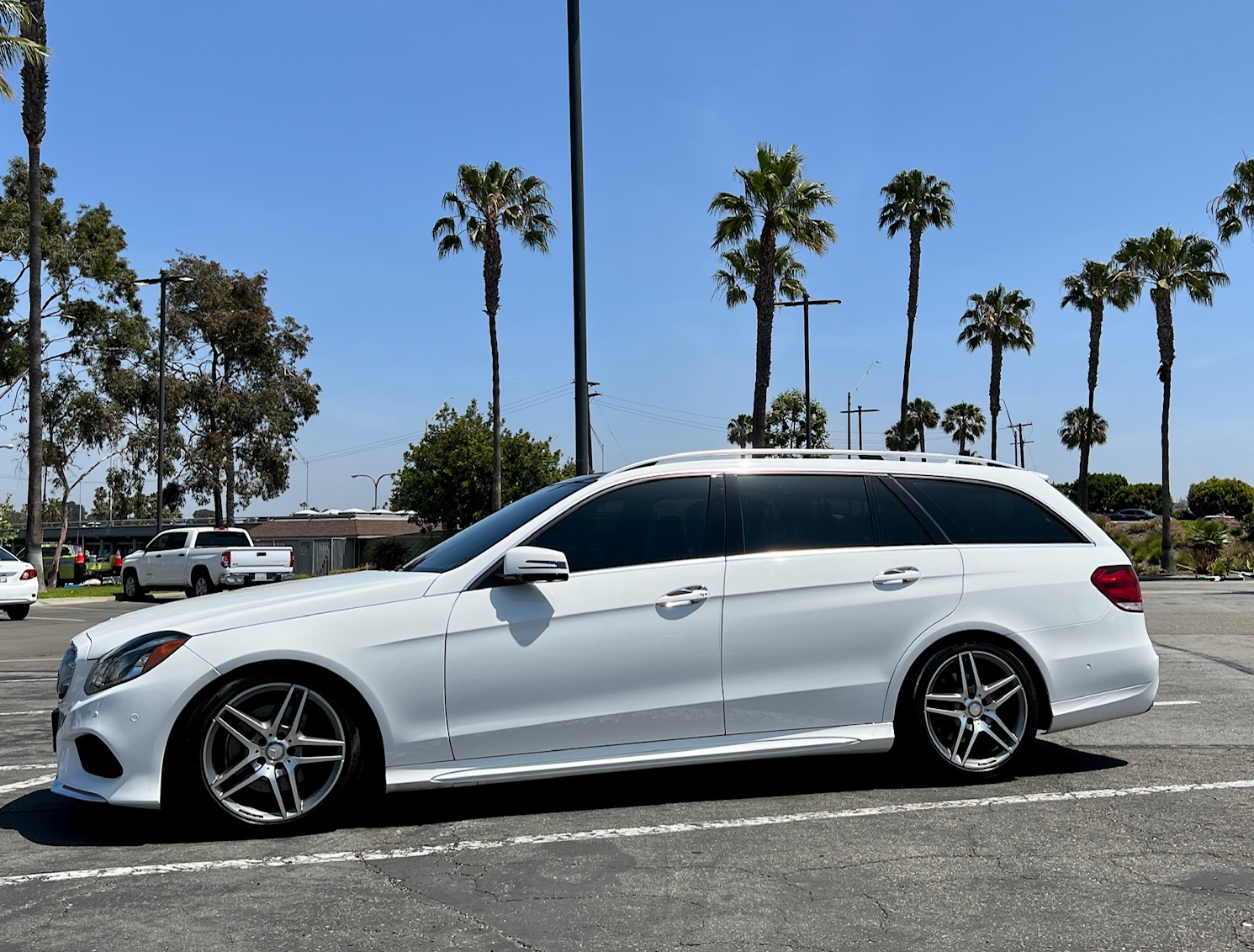

Here is my wagon, lowered between 1.75 and 2 inches, on stock 245/40/18 tires (equates to 245/30/20 in overall diameter. Just ordered a set of fifteen52 Holeshot RSRs in 19x8.5 19x9.5 and will be running 245/35/19 and 285/30/19 tires. Will post photos once I get around to mounting tires.
