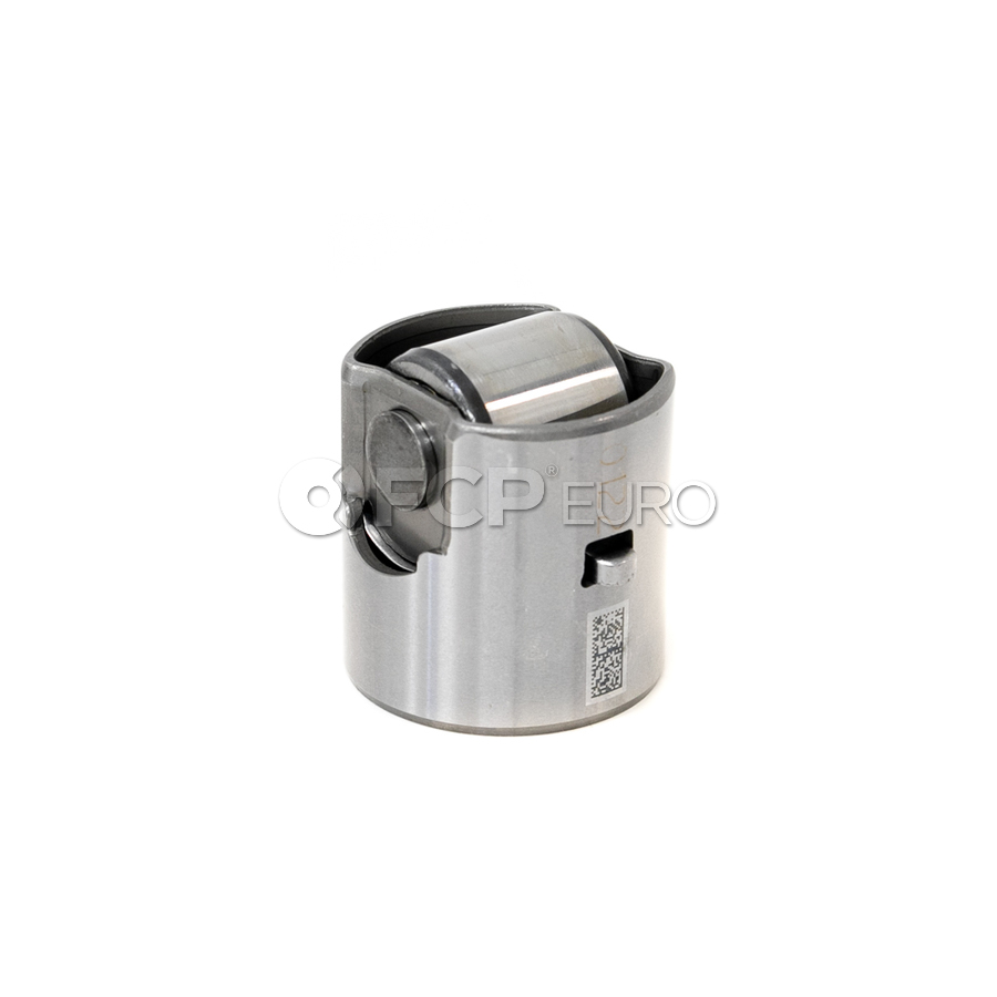

Very unlikely Arrie, usually the worn out parts would be that roller tappet
https://www.fcpeuro.com/public/asset...r5.?1566855041
Because a single roller does 3x more work than the 3 lobes. The lobes will usually be equally worn on 3 lobes.
The Audi-s old model dumb-azz roller tappet usually worn out VERY fast.
This kind of design : https://www.amazon.ca/Suuonee-Follow.../dp/B083TT4FF8
I would still check the pumps/lifters out as this kind of noise is very "mechanical" and other than something interacting with the cam shaft is difficult to understand if the noise is coming from the passenger side back end of the engine where the fuel pumps are located.
