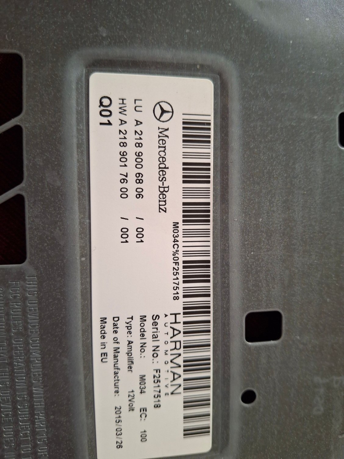

Hi CaliBenz
I need your quick opinion:
So my car is 2016 E350 (facelifted model) base RWD. Today I disassembled the car, removed the amp in the trunk, and to my surprised the amp's internal looks totally different from your pictures. Instead of 3 capacitors of 16v 3300uF.... my pcb board has 5 capacitors of 25V 2200uF?!. I wonder if this is the upgraded design by MB?. The next question is I bought 5 (lucky me) capacitors of 25V 4700uF. Since the pcb board is out, should I just replace the newer caps or leave it the way it is? thank you. I need quick opinion before I reassemble and put it back...
Old Mar 20, 2026 | 04:25 PM
  #34
CaliBenzDriver's Avatar
Joined: Apr 2019
Posts: 11,555
Likes: 6,589
From: Silicon Valley
W212 MY'14 M276-3.5NA @75kMi
caps upgrade + heatsink
> replace or keep caps?
I would upgrade to fresh ones!
Your original MY'16 caps are seasoned with decreased capacitance value.
We've hand picked great capacitors now delivered on-hand.
  • Higher values
  • Longer lifespan
  • Lower serial resistance
You're going to double up your noise filtering...
nice!
Again, pay attention to rough heasink surfaces not being machined to absorb heat from chips particularly well.
Then you'll have yourself a nicely reliable heavy duty amplifier.
Filtering caps in parallel add up capacitance:
2014: 16v 3,300.uF x3 = 9,900.uF
2016: 25v 2,200.uF x5 = 11,000.uF
2026: 25v 4,700.uF x5 = 23,500.uF
It's good to see the "16V caps" issue being resolved in later MY'16 amplifier.
> FUTHERMORE...
Other small collection of hard-working HOT capacitors are in the tank fuel pump control module near the rear passenger-side bench/threshold end.
This is a CAN-C VIP module... deserves attention & old caps maintenance.

caps upgrade completed
Originally Posted by nguyenphananh
picked up and installed the amp today, so far so good: Works as it should, will pay attention for the coming days and weeks for any abnormality.
1 More project done!. From the look of this amp, I think MB already updated the design for the amp, so no need to disassemble and mess around with the subwoofer amp, unless it break down....
Main Amp complete back to work... Nice!
Woofer amp has its own little fan.
If the heat from the integrated chips is transferred to the heatsink then it can get vented.
thanks for sharing with us, I appreciate it

I *think* the 2016 cars don't have a separate woofer amp, but I might be mixing up another car entirely.
