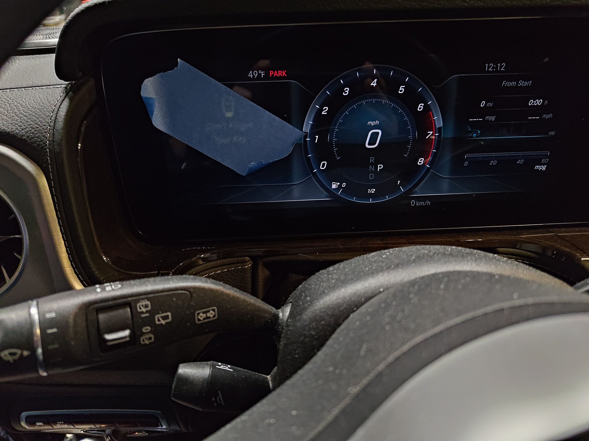

My G will lock if one key is left inside. I thought I had a fix identified, but it needs further refinement.
