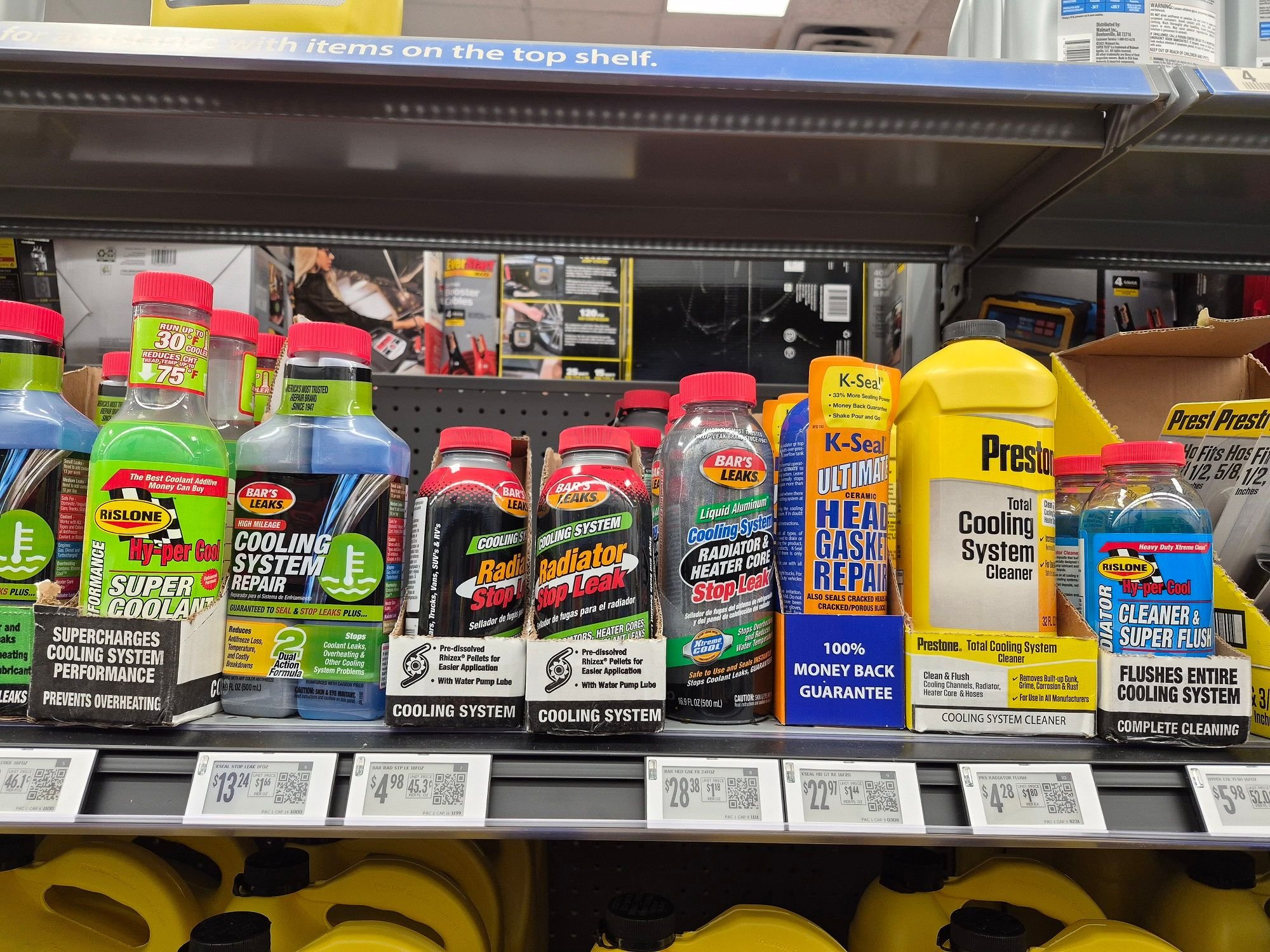

I am about to replace water pump in my 2012 e350 w212. Seems to be a leak in the gasket, and the lower hose. I checked the hose and it's intact no cracks. IMO could be the O-ring. I will replace that first. Anyone have experience with similar coolant leak?
Anyone try coolant leak additive, or it's just snake oil?

DO NOT put in gunk. Period. If you do - SELL THE CAR to a stranger ASAP. Someone who does not know where you live, and not someone at work.

If you intend to keep the car for a while, do not clog up your tiny coolant passages with that stuff,

Snake oil.
