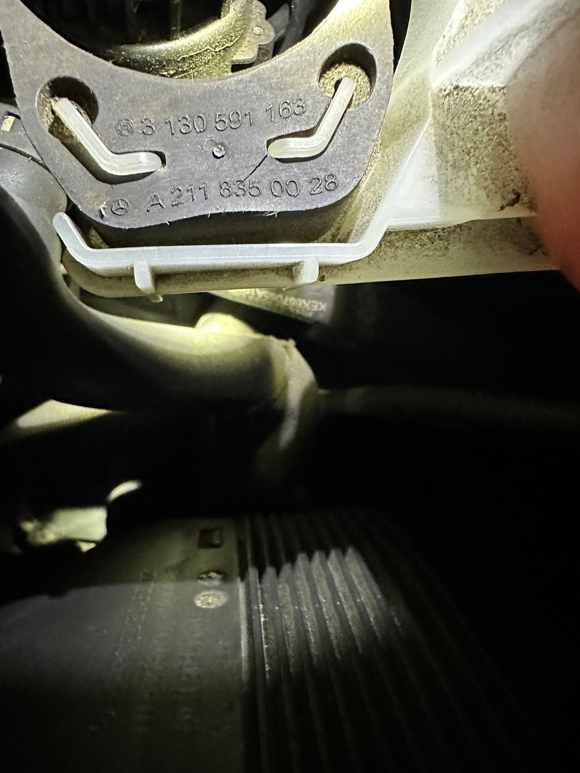

Hey folks:
I have a 2016 W212 and been having some trouble finding a replacement for the rubber boot that holds the auxiliary water pump, which attaches to the front of the coolant expansion tank.
The one on my car cracked and split, and now the pump's loose. I found a part # stamped on the holder itself, but can't seem to find a replacement anywhere. It's A2118350028
Has anyone replaced this bit, and if so, where'd you find it. FCPEuro and ECSTuning don't seem to have it.
Any help would be greatly appreciated.

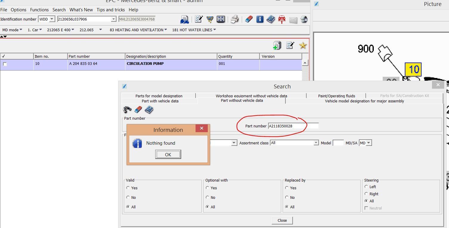

Mar 25, 2026 | 06:29 AM
Not sold separately from the DC pump itself which if for my car is called A2048350364 circulation pump
That P/N A2118350028 does not exist in EPC. This is common, even my radiator printed P/N on the body is not available in EPC.
Its like some P/N is between MB to its Vendor only and not for us retail customer.

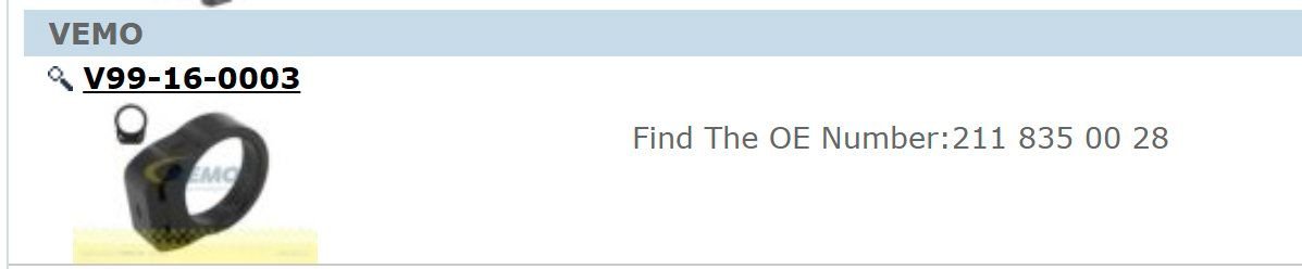

Mar 25, 2026 | 07:36 AM
might have some luck if you can chase down a Vemo# V99-16-0003

Mar 25, 2026 | 09:52 PM
So far, no luck. but at S-Prihadi's suggestion, gonna MacGyver a fix.
Pulled the part out, cleaned it, and used some IPA on the mating surfaces. Then, I applied some vulcanizing rubber cement and held it in place with a binder clip while it cures.
Crossing my fingers that it works!!
