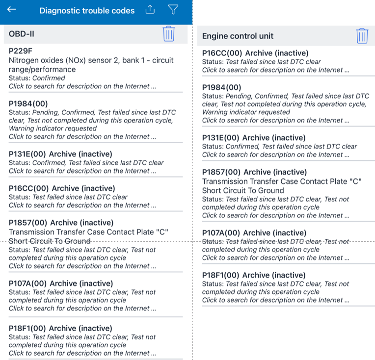

Hello. Today, the check engine light on my 2011 E350 Bluetec came on. I used OBD scanner to read the code and I got the attached list of codes. Most of them said: "Test failed since last DTC clear." I cleared the codes and the check engine light went out. What does this test failed mean? Is it any concerning? Will they come back on?

many monitoring tests have no yet been completed since last clear....
This one is already confirmed.
Wait couple more days for ECU self-tests to be completed. A good deal of codes will come back because something's got your engine upset... glow mgt?

Thanks for the message. I have cleared the codes. Are you suggesting that the codes will come back in a few days? What is suggested?

scanner output screen
Tests are currently being conducted over a series of ongoing drive cycles.
These fault reports include a link where it says "click to search Internet" - Pretty handy, right?
