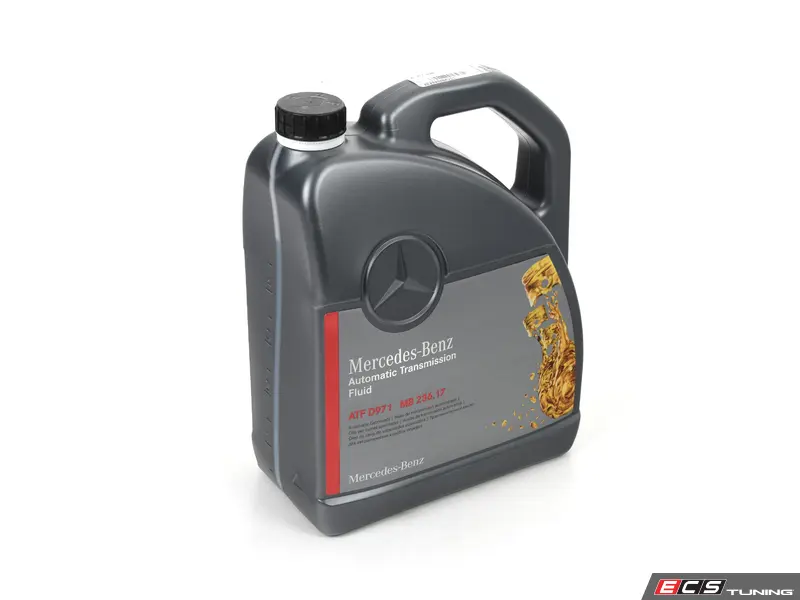

I found a local seller of tarnsmission fluid with these specs and when I tried to see if it's the right type, I got mixed responses. I'm putting here to get the correct answers. They're selling 2 5-liter jugs for $60.
Gold Fluid Genuine Mercedes-Benz Approval 236.17, ATF D971

ECS's website says it won't fit. I think I need MB 236.15, not 236.17

I believe that's correct, I think 236.17 is Gold in color for 2019 and newer, You likely need the blue 236.15

I just picked up 10 liters of MB 236.15, opened one and it was BLUE👌

While searching for the 722.9 trans. filter kit, I learned that cars without code A89, reduced friction, get red fluid. Cars with code A89, mine, get the blue fluid. So, it helps to check car's data card.

It should still be blue, I believe all cars after 2011 came with blue A89 code
