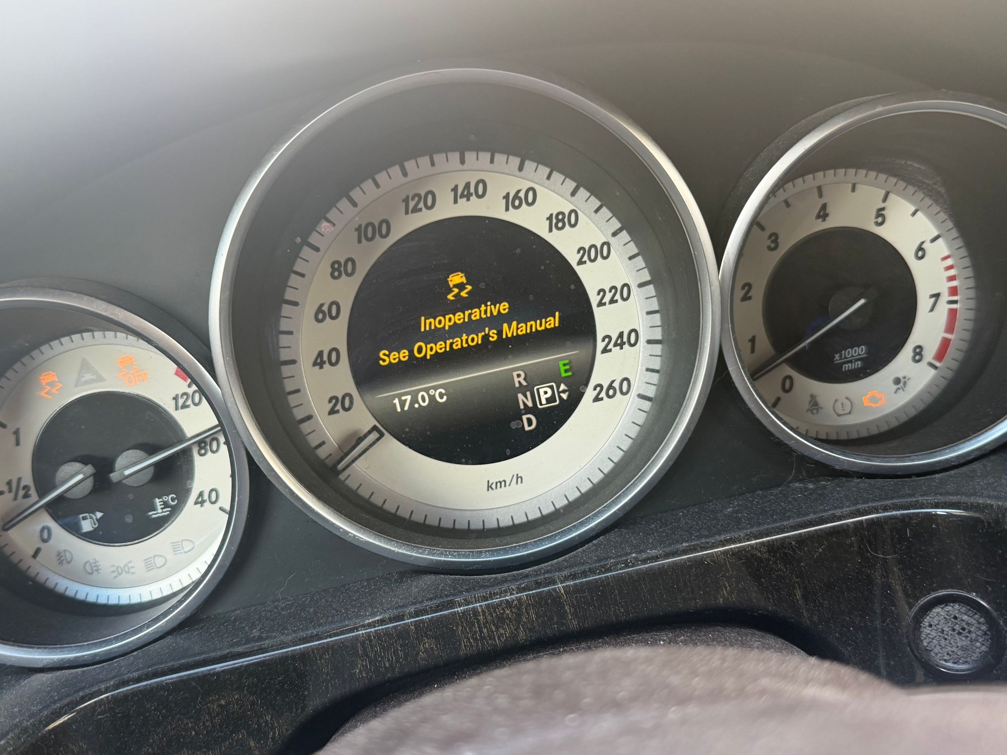

My car will randomly have the entire Christmas tree lights come on
When I turn the car off and wait for like 15mins
They go away
The lights when I scanned it came as:
U0122 - Lost Communication with Vehicle Dynamics Control Module
P061a-Internal Control Module Torque Performance
I can’t seem to replicate the lights coming on, they randomly appear and after clearing them, the car works perfect and no issue but when they do come on, I have to pull over and turn the car off and just wait
My mechanic was stumped and didnt know how or what to do with it since I can’t replicate it at all.
Anyone have this issue or any idea what it could be?

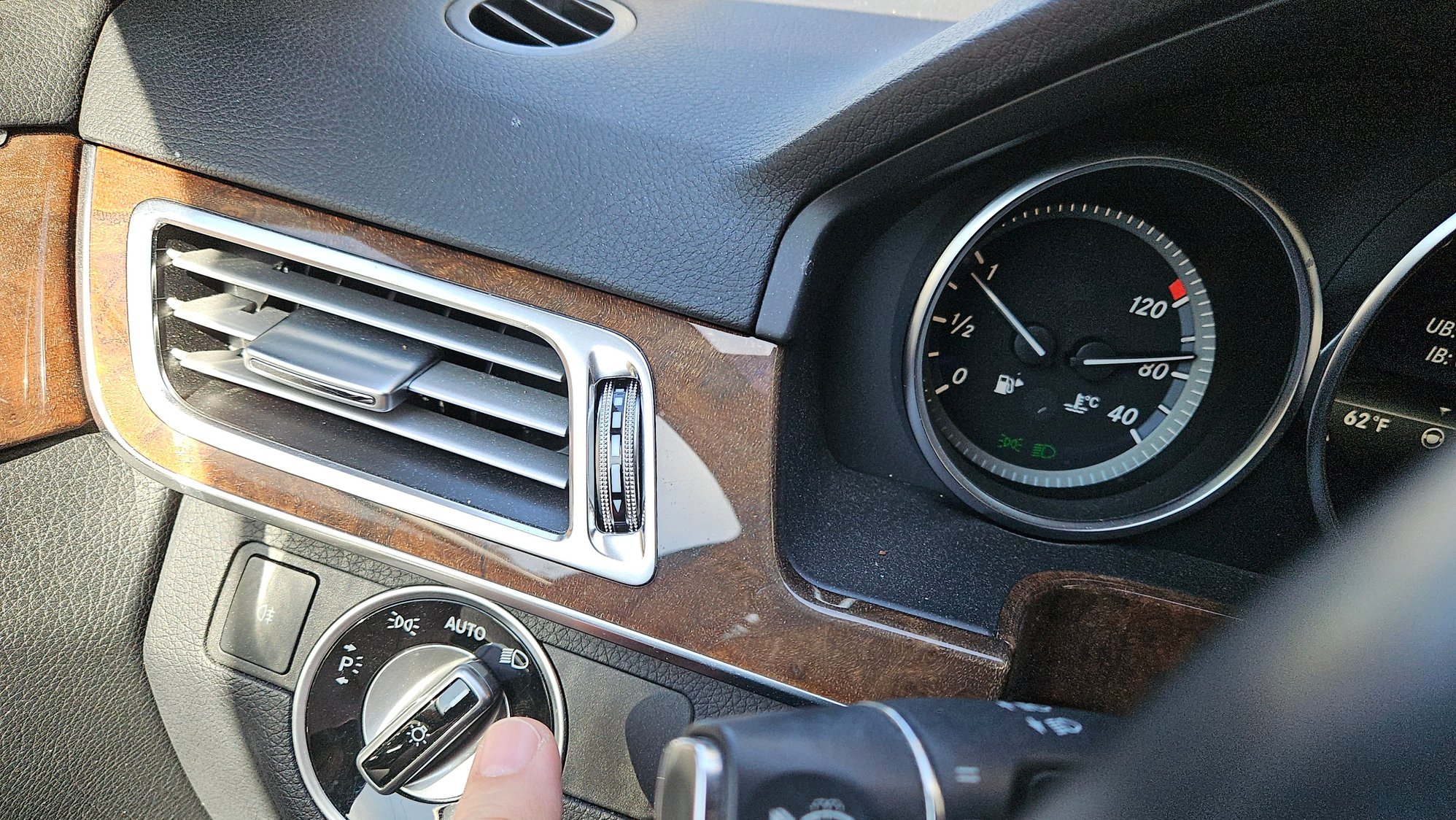

Manually Turn Headlights:ON with hand switch to get assured 13.7V Minimum day & night. While driving then manually shut it off after parking.
