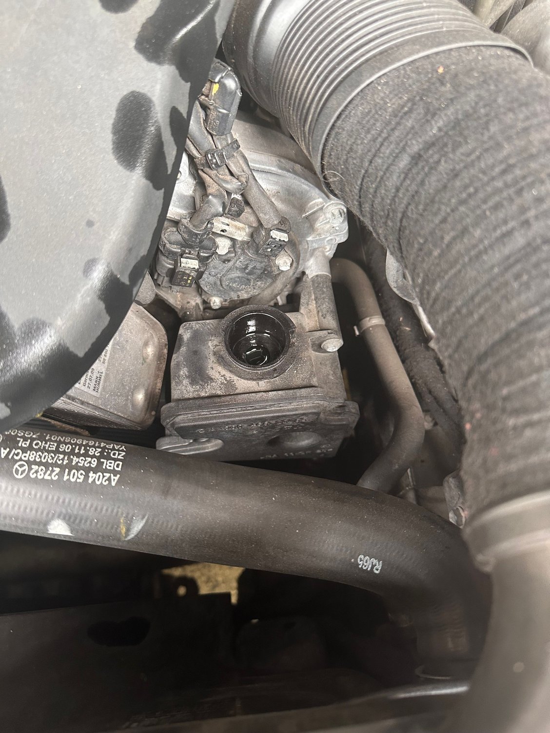

I went to put in fluid after I drained it all out, I poured less then 1//10 of a cup and it was at the top and wouldn’t go down, I read it supposed to take a liter, what the hell is going on? This is the correct spot where fluid goes correct?

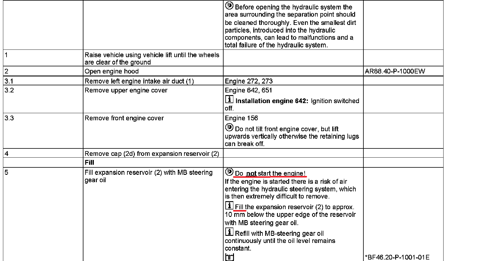

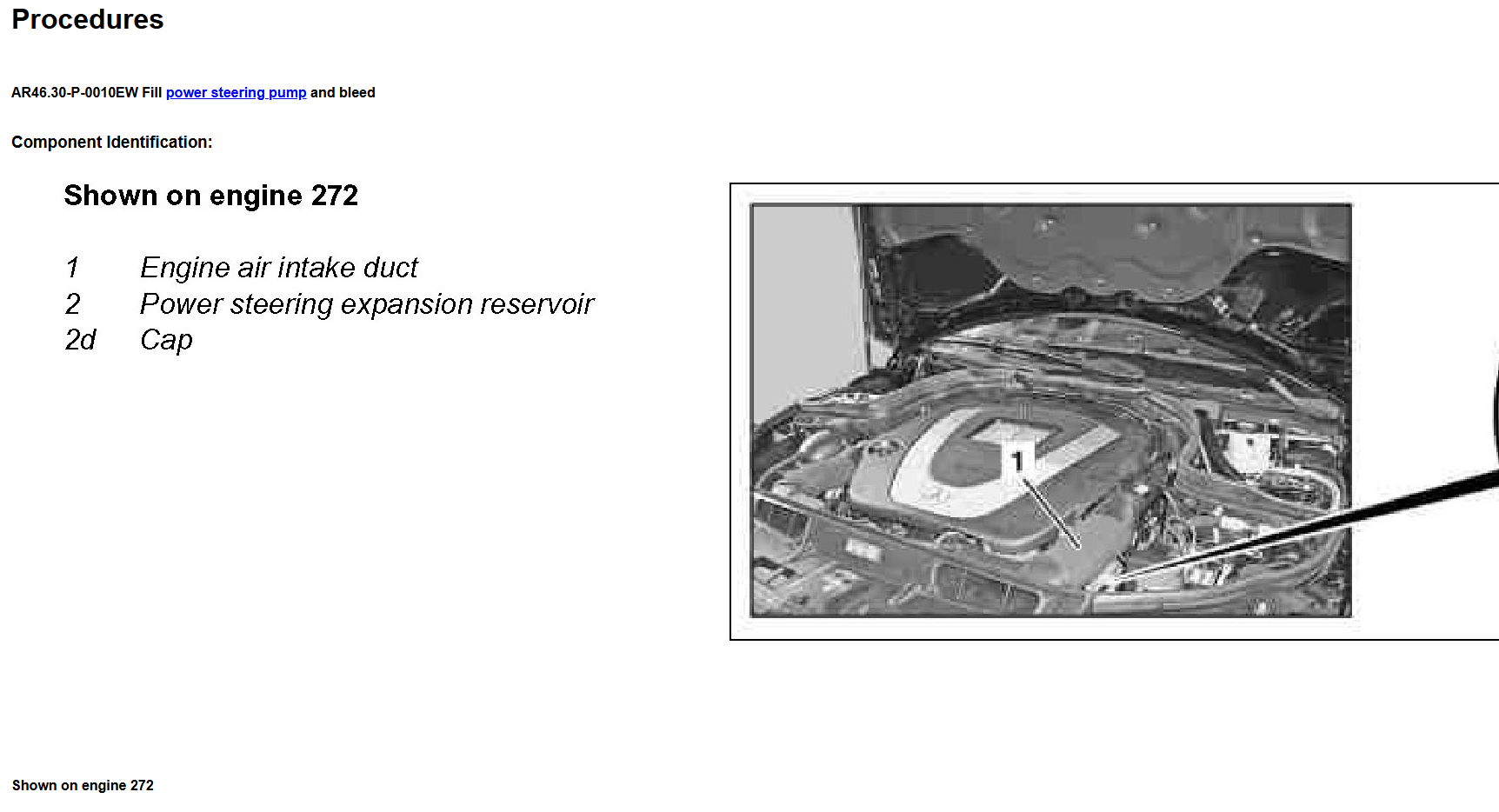

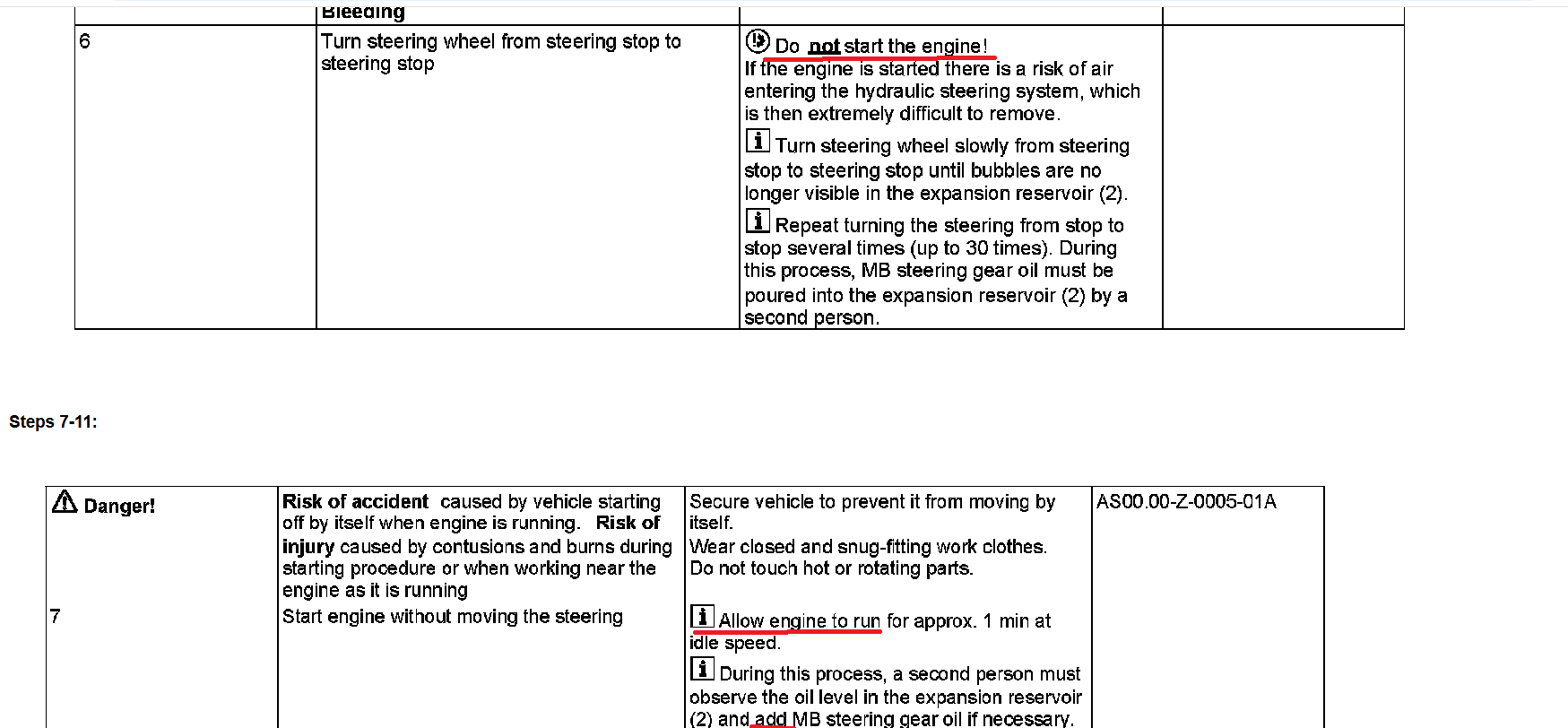

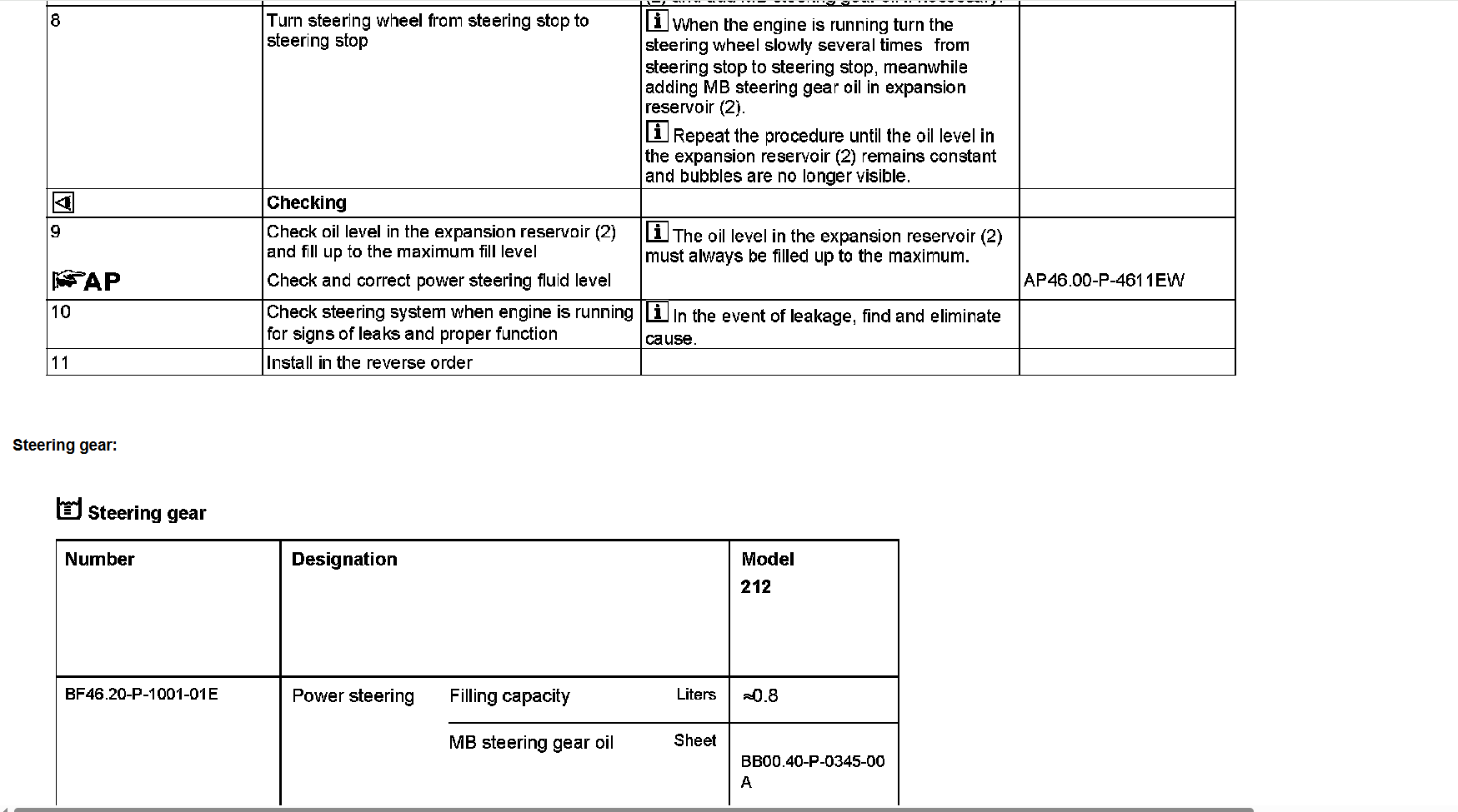

With engine off fill the reservoir. manual says fill to 10mm below cap. Turn steering wheel side to side several times, filling fluid in the reservoir as needed. Then start engine and fill fluid as needed. Again turn steering wheel side to side.
Instructions posted below in case i messed it up.

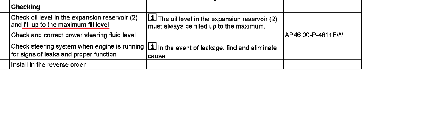

Says to fill to max level. When I was replacing the power steering fluid in my W204 I noticed it was at the max level so I looked it up to make sure it was correct.
