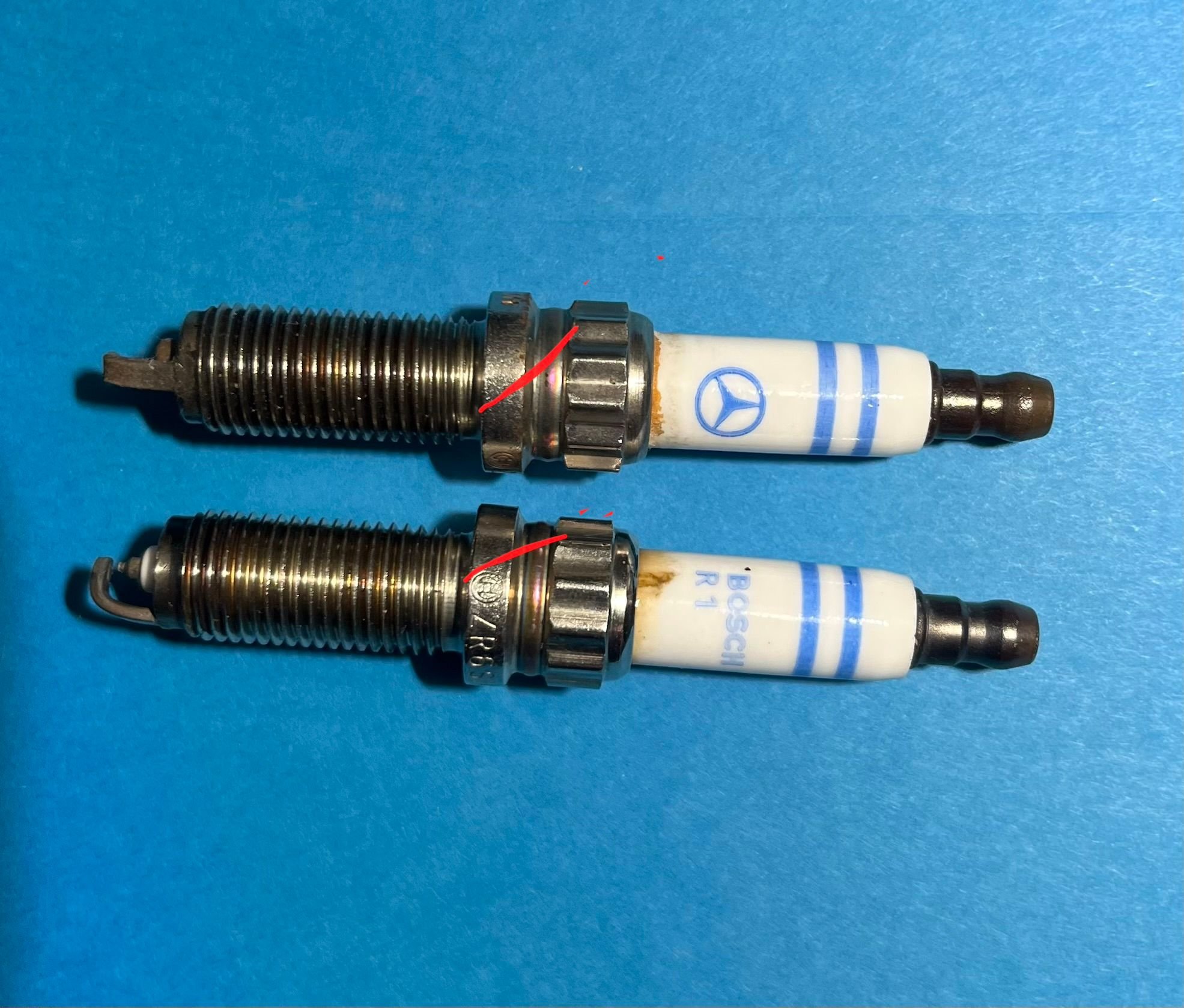

It just is that this guy on the video erroneously claims that the plugs from dealer with MB logo are exactly the same as the Bosch plugs you can buy from elsewhere. THEY ARE NOT THE SAME.
In the picture below I have marked the end of the thread in the MB and regular plugs. Threads end in 90 degrees different location that makes the regular plugs stop 90 degrees short from the correct position just like it happens in the video.
And that is exactly the same what happened with my plugs. I had to sand the washers to 1.25-1.30 mm thickness to have plugs index correctly.
Also, the plugs ID is different. The MB plug starts “Z6S…” while the regular plug has “ZR6S…” with rest of it the same.
Other than this a great video to show how plug indexing is done.

The m274 should be a direct injection engine and spark plugs correctly indexed but if you get plugs from the dealer you don’t need to do anything but just screw them in. They will index correctly.
If you use Bosch plugs from other sources you need to make sure they index correctly and they probably do not without washer adjustment.
It seems MB does not allow Bosch to make plugs correctly for people to be able to buy them much lower cost from other sources.
NGK does not have a problem with this so they may have correctly indexing plugs out the box. While searching about this issue for my plugs I read that NGK has plugs for the m278 engine that are made right so that is my next spark plugs make I will buy if I need to (hopefully) change plugs again.

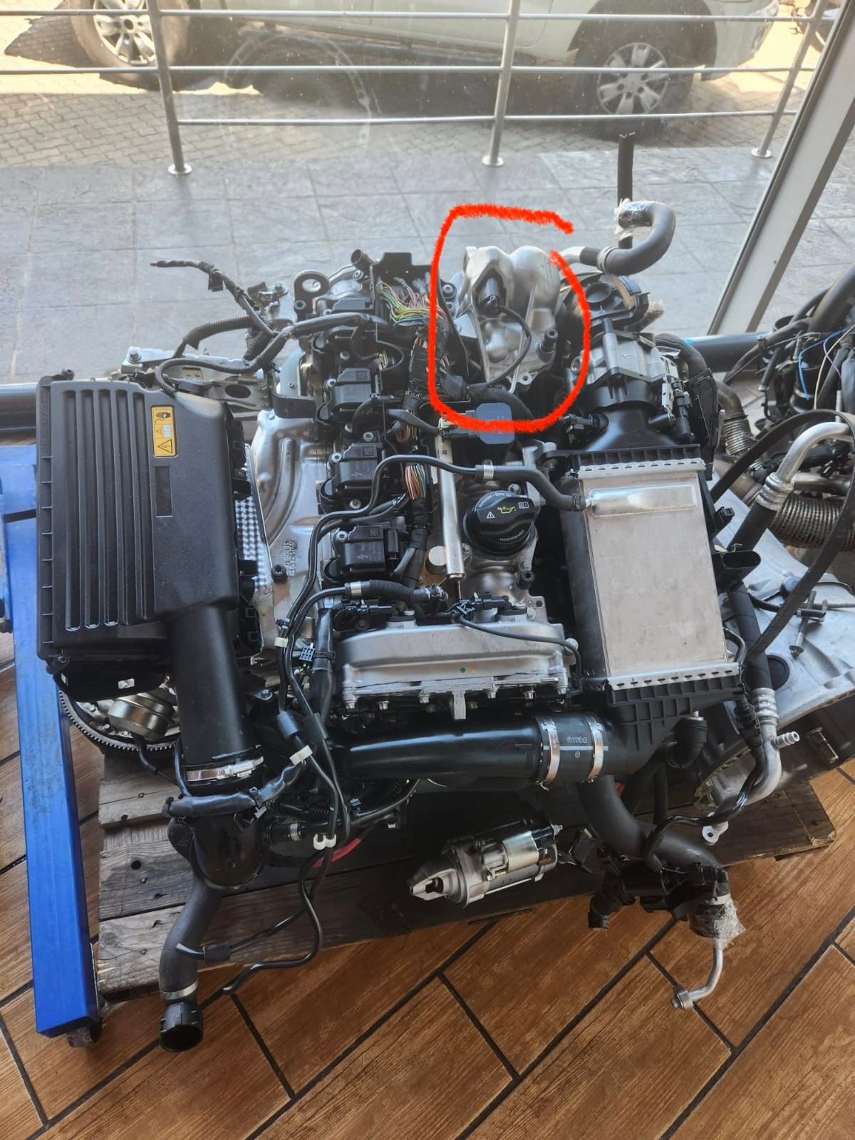

Ok, quick update for whomever may find this useful in the future. I bought a "car stethoscope" and listened to the engine, around the spark plugs, coils, injection etc. The problem in my case was the High Pressure Fuel Pump (HPFC). When I put the stethoscope on the case of the pump the continuous tap tap tap noise was in my brains. Not entirely sure if that's normal, as I heard some folks saying it's normal for Mercedes, but I will change it just to be safe.

HPFP + Roller is a good maintenance candidate around 90 to 120 kMi. with the nearby PCV breather system.
car just hit 100k so I suppose it’s about time. What’s the roller you mentioned?
Is your pump keyed into the rear of intake camshaft instead over on top with a roller ??

Is your pump is keyed into the rear of intake camshaft instead over on top with a roller ??
it looks like in this image. It has that metal case on top.
here is the answer:
your HPFP is driven by camshaft lobes + ROLLER/follower.
red circle is pump lobes
4x 90° lobes
4x 90° lobes here
The roller can develop a flat and stop rolling when needle bearings get contaminated - That is an incentive to keep clean fresh oil on 5kMi schedule.
