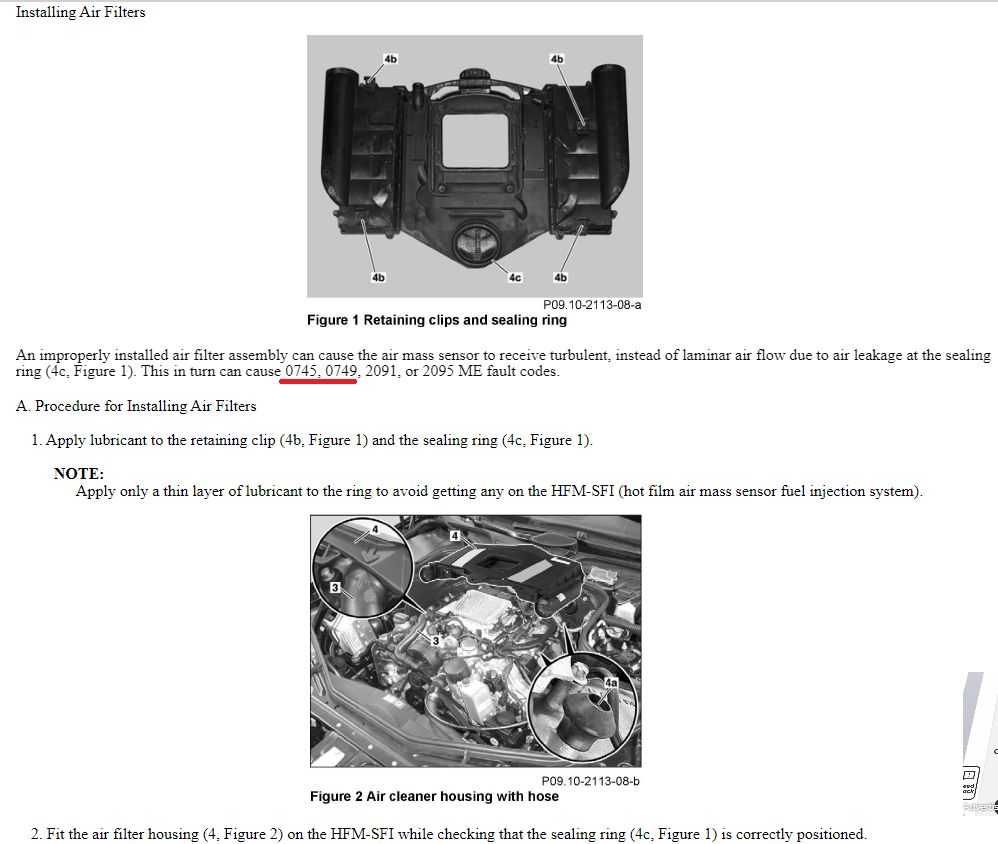

First thing i'd do is remove the air filter box and inspect all the gaskets. the one at the elbow to throttle body, maf to elbow, air box seal. I replaced my air box seal because it looked worn, after replacing it the box fit on tighter and the metal clip snapped on over the top much better where before it felt loose.
