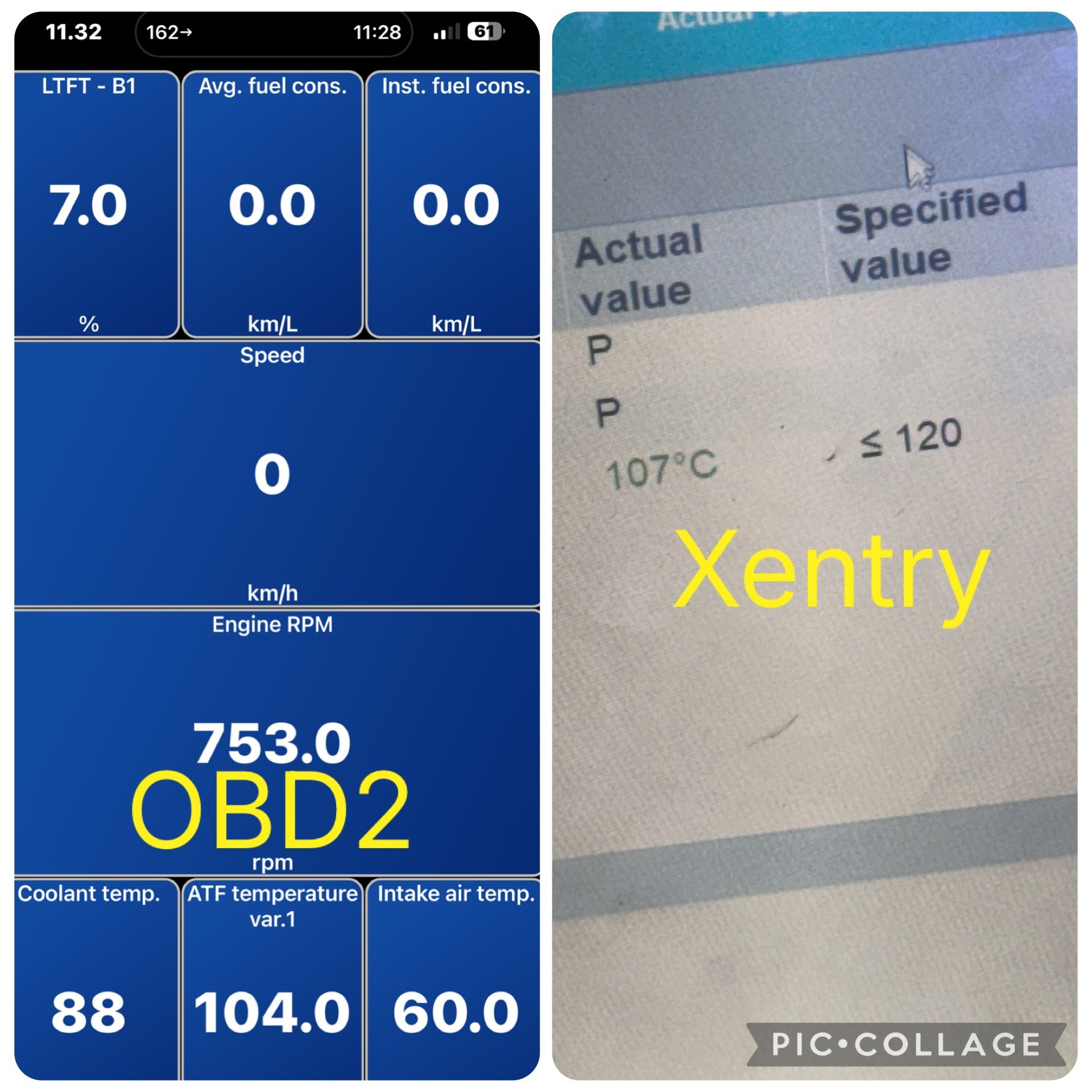

So, in the october 2025, i change my atf using titan 7134 9 liters (include inside torque converter), then on mid march 2026, the speed sensor got “cooked”, driving to the workshop in limp mode.
The speed sensor and vgs got serviced. Unfortunately they only change atf 6 liters (which means they didnt change the one inside torque converter). And 1 month after that everytime i do cold start, the gear seems stuck at 1, when the rpm hits 2.000, the car is jerking, and the gear jump to 2 (feels like driving a manual car and you let go the clutch in a hurry after shifting gear), after that no problem driving all day.
Because tesna (my friend in w212 community) often show about his coolant temp in lufy xs, i got tempted and try to monitor my own temp, using obd2 and car scanner apps. To my surprise, the matic temp is way over the coolant temp (coolant 100 degrees, atf 115 degrees).
So i rush to the workshop, changing my atf, changing my atf oil cooler and my old atf is already murky green. After i change atf, the temperature is still slowly rising, and i drive while controlling the atf degree, it doesnt come down even when i put in N or P, while engine on, rising my rpm to 1.500-2.000, it didnt come down.
next week my final plan is open up the gearbox and torque converter, because i have 2 problems
1. The jerking everytime i do cold start
2. The atf temp that always go overheat
anyone having same problems? Feel free to share your thoughts 🙏
The temp is at the max, after this it got hit to 115 degrees slowly

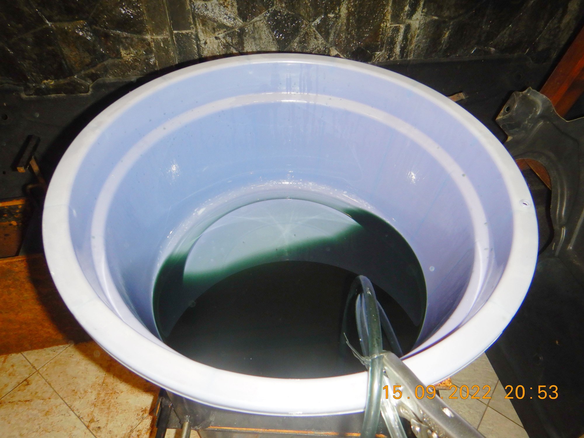

The old liquid i changed, murky green

Try to verify the tranny oil temperature using a proper scanner, like the baby Launch specific to MB or any mid class Autel.
As fas as I recalled during my test on OBD2 data out, which the device you mentioned LUFI XS is and OBD2 device: https://lufiau.com/products/lufi-xs-obd2-gauge ..........
Such device can not show true tranny oil temp, because tranny oil temp is not part of OBD2 protocol.
Even my oldie Torque Pro ( OBD2 apps ) is the same, using its Tranny Oil temperature it is not tranny oil temp I am reading.

I already check and compare between my obd2 scanner and xentry C4 scanner sir, it didnt show much difference in tranny temp
while Lufi XS is obd2 device it does able to do custom PIDs so it can shows ATF temp. On my old monochrome insturment cluster with AMG menu unlocked it can shows transmission temp and the number match. (Since then I have replaced the instrument cluster with color version and lost the ability to display ATF temp in the cluster AMG menu.
The number also match with numbers shown in launch scanner.
btw, regarding Mr. @yudhi262 issue, I did ask him whether his numbers is accurate or not, but he did verify the numbers in xentry it does match. Perhaps we need to meet somewhere and plug my launch scanner
but if his numbers is correct, this explains his VGS sensors failure. I am suggestign him to post here so experts here perhaps can diagnose before he is going to do full rebuilt on his W212 2013 transmission. My guess is there is something wrong with the cooling.
On cold start, when the transmission on P the temp still ok. But when on D, that's starting to get worse.
he already replaced the ATF fluid (including the one inside the torque converter) and the cooler unit (his is separate/dedicated ATF cooler unlike me inside the radiator) but the problem still persists.
or there is something wrong witht the clutches, making the temp goes wild...

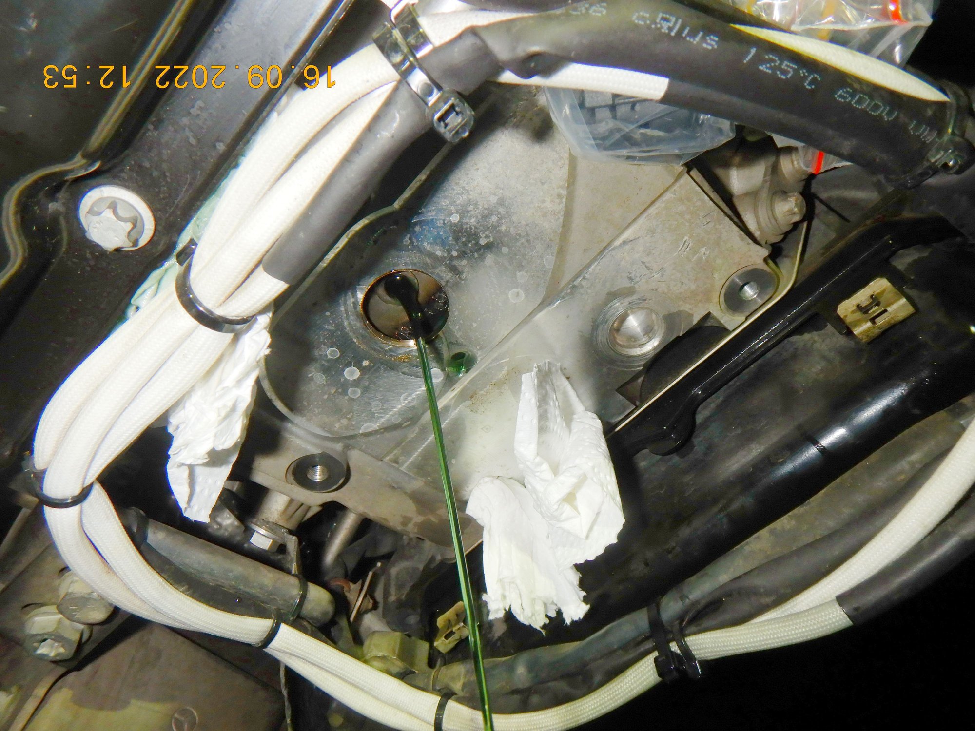

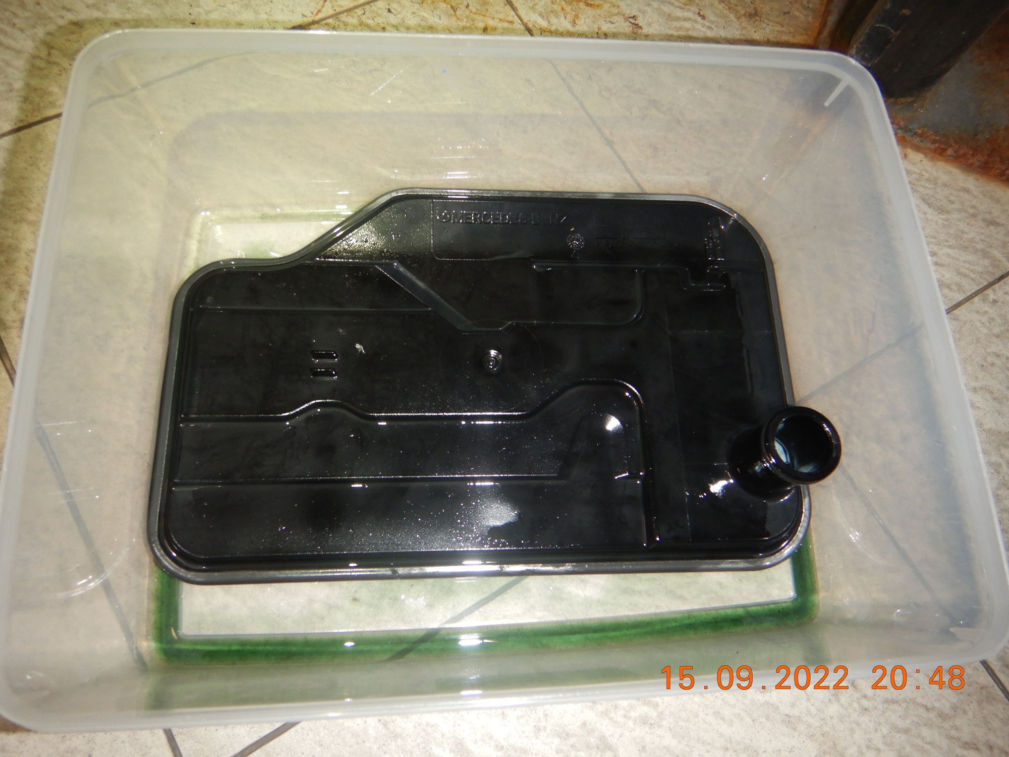

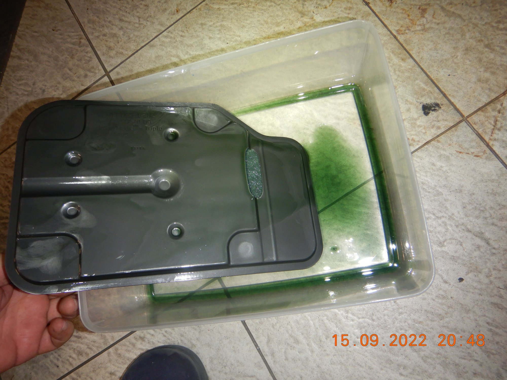

Fuch Titan 7143 tranny oil color......
If thin layer.....
If dripping out of torque converter
If deeper than 5mm pool, it looks very dark

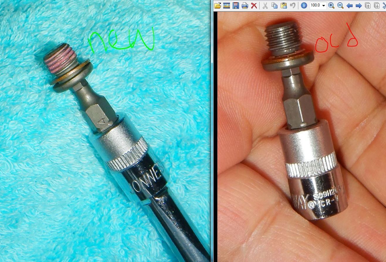

Always get new Torque Converter drain plug when draining TC......... it has special sealant, not only the copper washer.
If thin layer.....
