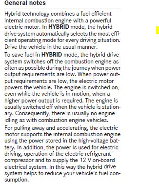

To save fuel in HYBRID mode, the hybrid drive system switches off the engine as often as possible during the journey when power output requirements are low.

Are you really sure that the engine is switched off whilst the vehicle is in motion? I'd be highly surprised if it did considering it's not a hybrid and does not have an electric motor to provide any form of locomotion. My 220d can't even sit at traffic lights for long before the engine starts up again, no idea where the power for steering and more importantly the servo brakes would come from. I had an e300 hybrid and that was loaded with various bits to make it possible to run with the engine off, my 220d shows no signs of the same tech.

Not familiar with market, E220d hybrid? ...Have you seen Hybrid mode.
