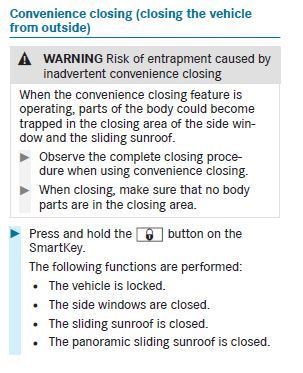

Hi All,
I have a W213 (2018), I have installed the Connect Me app (seems very limited), just wanted to know, can you close all windows with the key remote (I used to have a 530 BMW and it was just on the key, you just pressed the lock button for 5 secs or so and all the windows would close, and you could also open all windows by pressing and holding the unlock button), can this also be done on this car, I've tried and nothing seems to happen. It may be an optional extra which I don't have on the car.

You can but you have to stand really close to the car. Supposed to be some safety feature but very annoying.
File Type: pdf

Thanks will have a go when I next go for a drive, to see if it works, and how close I need to be. Is there a feature where the windows would automatically close if opened for a long period of time like 30mins when the car is stationary and not on, or when it starts to rain.

I believe so for your market, need to check your owner manual for “rain closing feature” or MBUK: https://www.mercedes-benz.co.uk/pass...er.module.html
