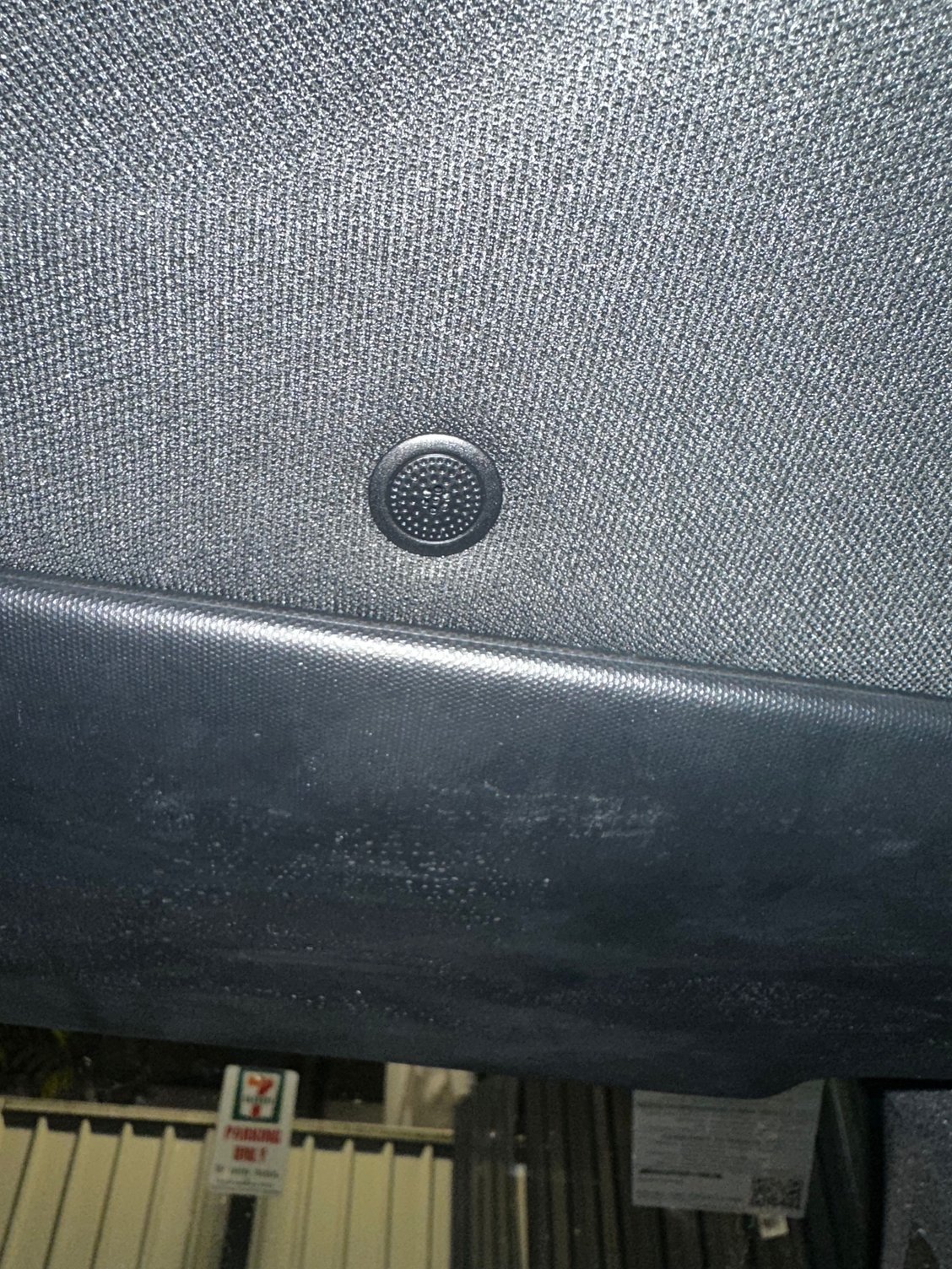

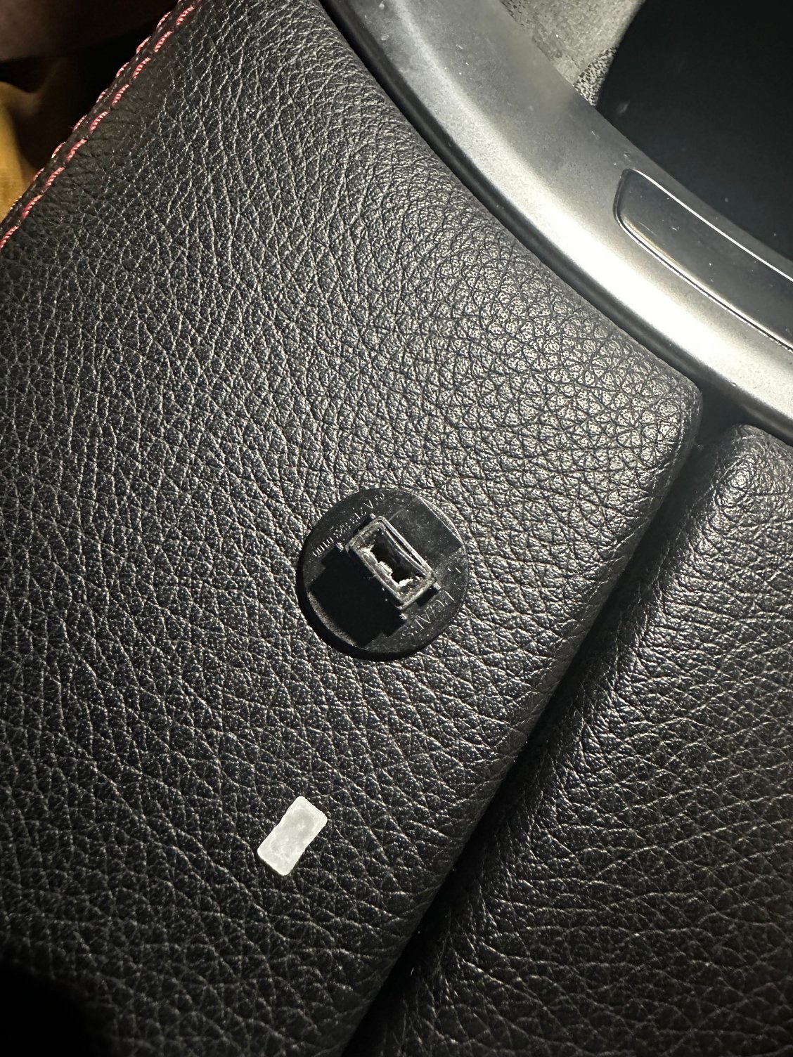

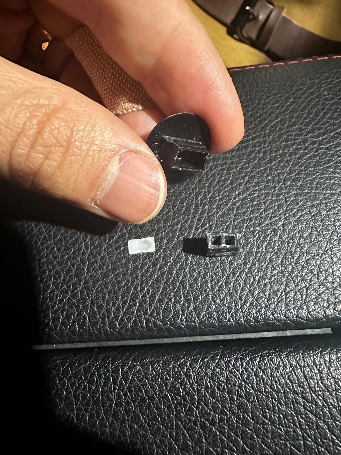

I have solved it! This fixed my W205 C43 mic issues
So this absolutely fixed my mic issues. Essentially there is a bit of plastic behind the microphone cover. I removed it and people now saying they’re hearing me clearly !
easy to do. I’ve attached pics.
1. pull the cover off (located directly above steering wheel, just behind sun visor).
Plastic cover
Plastic cover
2. in the cover, pull out rubber tab
Plastic cover with the rubber insert removed. White plastic for removing
3. remove white plastic piece
4. reinsert rubber tab into cover
Rear of plastic cover and white plastic for removing
5. reinsert cover
couldn’t believe it was that simple.
also, don’t forget to do the one on the passenger side.
feel free to ask any questions!

Update though. People saying it’s muffled.
Seems to be only clear when I take the cover off completely..
same for you @Uglybaba ?
Old Jul 7, 2025 | 08:28 AM
  #39
Uglybaba's Avatar
Joined: Jul 2025
Posts: 6
Could it be your rubber tab misaligned? The other parties said they hear me loud and clear now
Old Jul 7, 2025 | 08:29 AM
  #40
Uglybaba's Avatar
Joined: Jul 2025
Posts: 6
have you tried removing the rubber tab? They look redundant too lol…
Old Jul 7, 2025 | 08:39 AM
  #41
Mottman1's Avatar
Joined: Jun 2025
Posts: 5
From: Sydney
C43
I feel like the rubber tab is redundant also so tried with it removed but still once I put the plastic cover on, people tell me it’s muffled. Only seems to be clear without any obstruction.
I might try drilling open the holes on the cover and see how it is.
I’ll order a couple of replacement covers in case I destroy it.
if anyone needs, the part number for the covers is A2138230100
Very odd that it relates to the cover though. The initial issue of audio dropping in and out seems to be completely gone once removing that plastic.

just remembered that when i tried reinstalling the cover, it didnt clip on to the PCB. So I removed the vanity light, put my finger behind the headliner to support. I could have inadvertently aligned the microphone and cover, and hence didnt encounter the muffled issue. Maybe you want to try that out…
