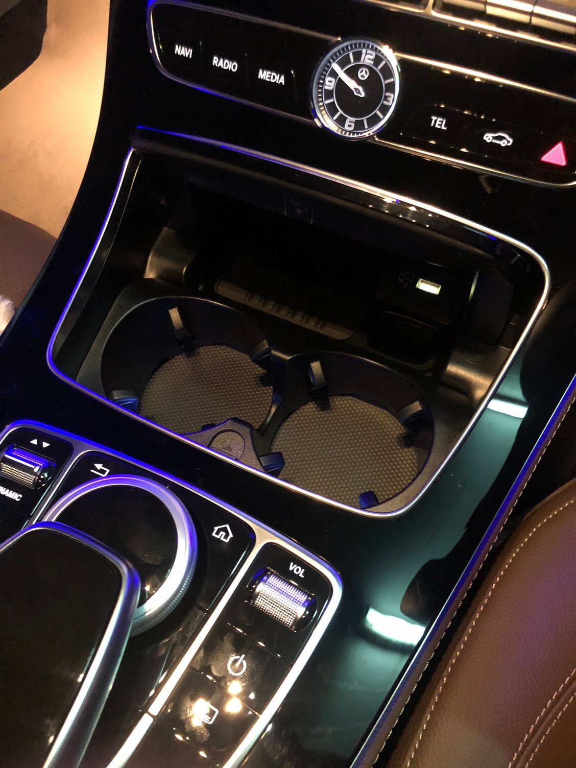

Indeed an extremely irritating sound. It's likely being generated by a voltage regulator, inductor, or other power supply component that is switching at high frequencies. Magnetostriction or the piezoelectric effect can be responsible for this. However, this being an MB, it was likely designed to operate in a range or amplitude that is inaudible. The fact that you can hear it, and so strongly, means it's not operating normally. Definitely needs to be addressed.

Sent it back to the show room. They said it seems to originate from the wireless charging unit. Let’s see. Will report back once they let me know.

That was actually my guess. Wireless Qi uses high-frequency pulses of the charging coil to induce current flow in the daughter coil on the smart phone or device. It's possible there's a magnetoconstrictive effect going on because something's not perfectly secured, or due to a power regulator humming along. Let us know what you find. On my vehicle, it's completely silent, so it's well dampened and electrically buffered.

it seems he has a usb plug in the cigarette lighter .
that'd probably what's making the sound (though I hear nothing in the recording)
