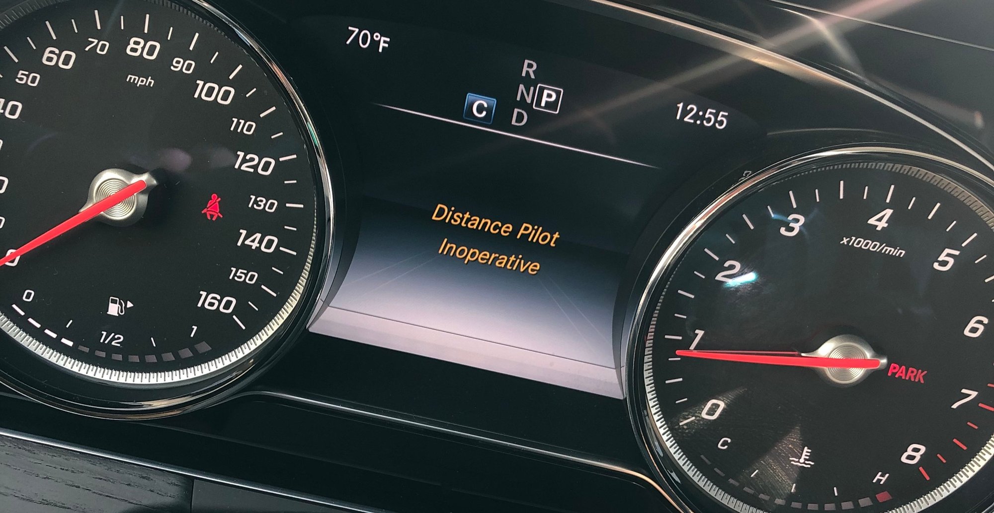

Yesterday morning, I was going to have a cup of coffee. When I started the engine, several error codes were displayed. (Brake Assist, Lane Keeping Assist, High Beam Assist...) They are all inoperative. I closed the prompt and continued driving. After that... when I wanna turn on cruise control, a new error code (Distance Pilot Inoperative) appeared.
Two months ago, I went to the dealer and repaired related problems. The dealer told me that the front cameras needed to be reprogramming and calibrate cause the front windshield was replaced. I paid close to $ 600 for this (okayyyy...)
But this time, these error codes reappeared for no reason, and even cruise control is dead. Does anyone have any idea on this?
