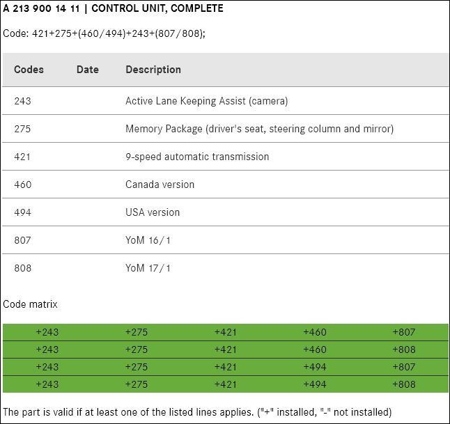

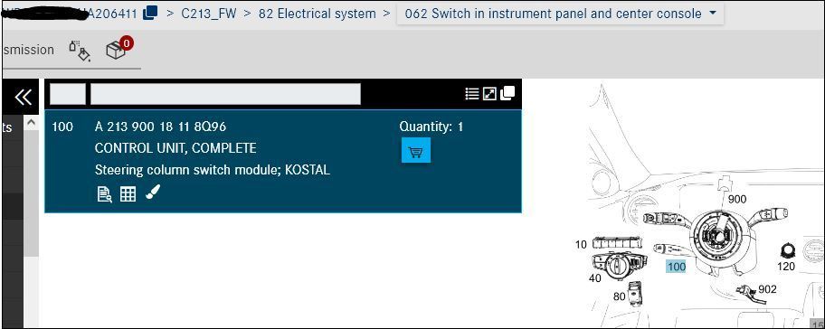

Originally Posted by kingscorpian27
looking to retrofit my steering wheel but not sure how to get the correct Steering Column Switch Assembly. Are you able to assist with part numbers.
Here’s column switch assembly w/out distronic: original 1811 as compared to replacement 1411 and/or 5712 not sure what the difference is but codes match.
