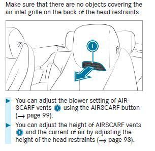

Airscarf is code 403 your vehicle is not equipped as such, check codes on data card.

Your VIN doesn't show the Airscarf in standard or optional equipment. You do have the ventilated seats. Your car was a December build and it went through a bunch of revisions before it was built, including a Baumuster change, which means it probably started off a a convertible build.
My guess is that the wrong headrests were put in your car and a few others. I just received an E 450 coupe that I built for a customer and while it has ventilated seats it has the correct non Airscarf headrests.

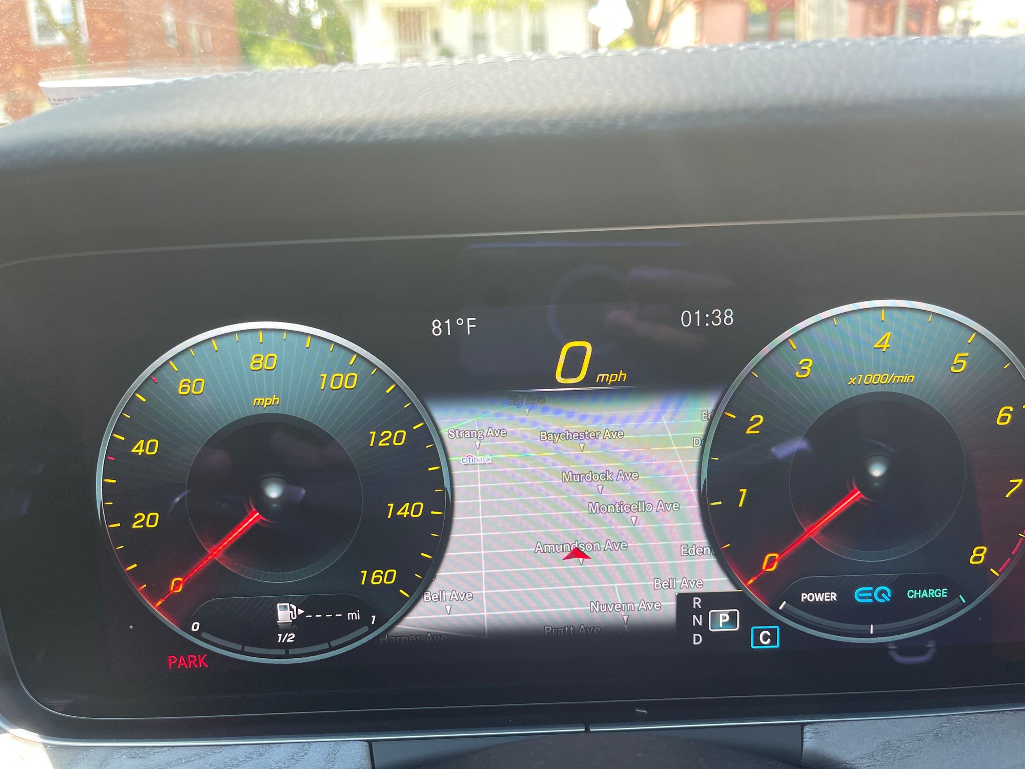

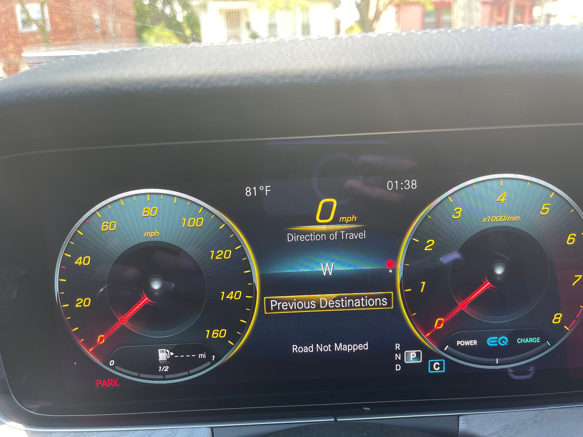

As for the map, on the drivers screen when I go to map only 2 options are there which is a small version on the map on the infotainment or the directions. On the cars that I test drive there was the 3rd option to make the screen bigger to take up the whole screen. Ill take some pics and post them here when I get a chance.

Your correct thats what I seen on the ones I test drive and on the internet. The pics I just took a minute ago. Its only giving me 2 options.

Looks like you need to take it into service and find out why.

In another thread with the same problem(A class though) they mention that the third option only comes if the car has augmented reality... maybe you didn’t check this option when ordering?

reading on other forums(a class again) it seems that this option comes with the advanced navigation package(which includes augmented reality)
