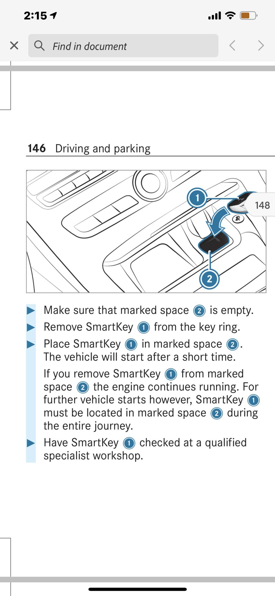

I may have been incorrect on charging the key in the slot. It’s the emergency operation mode

I don't think the slot is a charging one. It simply reads your key when the battery is dead or can't communicate for other reasons. When my car's main battery got very low I could not start as usual. Once I placed the key in that slot it started right up.

I believe you are correct: it is a slot to read the key FOB - not charge the battery in the FOB.
I recently changed the battery in my FOB: Mercedes wanted $11 for the battery, bought two on EBay for $1.99 - not from China: In any event when I used the FOB with the new battery, the car would not start and the notice on the dash was to insert FOB into slot. I did that and the car started. Thereafter I was able to lock, unlock and start the car with the FOB in my pocket.
Just my $.02.

I may have been incorrect on charging the key in the slot. It’s the emergency operation mode. I just added the information from the user manual
